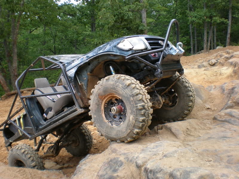

    Crawler Build:

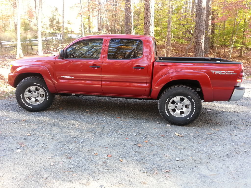

    September 23, 2013 Xpedition Ready purchased our 2013 4wd Double Cab TRD OR to be the new face of the company. We have plans to do a modest overland build, with a goal to make it functional, simplistic, and affordable for the common everyday consumer. This truck is an everyday driver and will be designed and built as such.
    Stage 1: The goal of Stage 1 will be to get the truck ready for a cross country trip Jess and I will be leaving for in April. We will be leaving NC March 28th and headed North West on a loop to see the best places this great nation has to offer. We will arrive back on Easter Sunday April 20th. We will be camping and exploring all along the way and documenting it as well. We would love your input on what you would like to see in this build so please post up!
    · Tires: BFG KM2s 255/85/16
    · Suspension: Old Man Emu 885 coils, Nitro Chargers, and Dakar leafs....later changed to 886 for bumper
    · Roof Top Tent: Undecided but leaning towards Eezi-Awn 1400
    · RTT Rack: Xready prototype design
    · Fridge/Slide: Undecided
    · Sliders: Stubbs Welding HD-SKO most likely
    · Skid Plates: Bud Built full skids, as we already have a set from another build
    · Storage Solutions: Working on this so stay tuned
    · Lighting: Undecided
    · Battery: Not sure if we will go with a dual battery setup for this trip as we will be on the road everyday so we may go with a larger single battery for now. Ended up going with a single batter Die Hard 31M
    · On Board Air: Undecided but probably an ARB Twin Air compressor because we want to try one out.

    Tires:
    We choose BFG KM2’s in size 255/85/16 because we wanted the height and performance of a 33” tall tire, but with a bit less rolling mass due, which will save us a bit of gas on our trips. If you are not familiar with the size it is roughly a 33x10 tire, also known as pizza cutters. It is our first time running this size, but we have heard great things from friends and customers. As for the mud terrain, a bit overkill for the majority of our trips but unfortunately there is not a lot of options in this size. We have had great luck with BFG in the past in other sizes so we are hoping this tire delivers.
    In case anyone has told you differently, this size DOES fit on stock suspension for street driving. We had a local tire shop put them on before we had a chance to get the lift on, and we were also curious if they would fit to give you guys some feedback. Our thought process was if they don’t fit stock, they will rub under full compression off road. So lets see what happens. We have not had a chance to wheel them on stock suspension but if you are worried about getting the tires on before you can afford the lift or don’t have time to put the lift on, you wont have any problems with stock wheels, and with mud flaps removed. We removed our mud flaps because they drug over speed bumps and looked terrible in our opinion. Disclaimer: These tires fit our truck on stock TRD OR suspension without mud flaps. They may fit with mud flaps but we took ours off before so use your discretion. We will keep you guys posted on MPG with this tire size as well as a longer term review.
