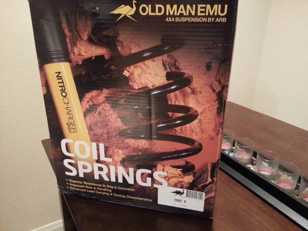

    These just came in today. :D
    Suspension F/R revamp soon to come.

    So with the above mentioned setup, how's the rasp gonna be?

    LT?

    LOL. nah man, those are just new replacement coils for my current setup.

    You said full new suspension soon to come:(
