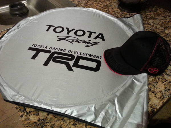

    so when i ordered my leaf bushings from toyota, i couldnt remember if they came with 2 or all 4. so i ordered 2 packs. well, they came with 4 so i exchanged one pack for some goodies. :D didnt have a sunshade.. so why not.

    How much was said sunshade? I could use a fresh one myself haha

    Was like 15 bucks. Not the best, but for not having one at all, it'll work and is pretty cool.
