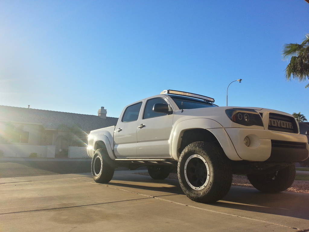

    how it sits today...

    White bracket for the bar?? Looks good dude!

    It's Black...:D

    just cut some medium/high density foam into 9 pieces at work.. 2" wide, about 4-4.2MM thick, and length was cut according to the depth of the fins. fit them tightly between 3 fins each. one set per side, and one set in the middle. we will see how it does on lunch on my drive home. if not, ill come back and try it again. either longer pieces, more, or in different positions/fins.

    thats a 50 raduis correct?
    where did you buy the mounts from? Did you have to drill into the roof to install? what about the weatherstrips?

    Yessir. They are Relentless Fab mounts. They use the factory roof rack holes (why I went with them) so no extra drilling. I used a nylon spacer to keep the mounts from crushing down too much on the weatherstrip.. which.. when installing, you will need to either drill the holes, or take a notch out of the side of the weatherstrip. Either way, you'll be fighting against a thin metal strip inside the weatherstrip. I used snips to cut through it.

    Oh.. and the foam strips I added like I mentioned in my previous post.. WORKED. Holy crap that was easy. First try. No more Amber Alert whistle. Lol
