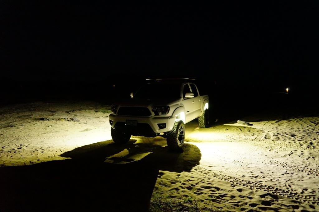

    So to keep track and make a list.. I'm going to try the current lighting i have sitting in the garage first.. which consists of:
    *basic 5-6" white LED work light bars for reverse lights, mounted under the bumper/on receiver
    *small amber pods for rear dust lights mounted under brake lights or on top of bed rails
    *amber LED bulbs for dust lights in my high beam reflector bowls
    *64 feet of 5630 LED strips for rock lights, bed lights, etc
    the led strip will be good, i know that.. but if i need to upgrade the rest in the future.. this is my next plan of attack:
    *flush mounted D2 type for the rear bumper in white, flood/driving pattern - backup lights
    *hood mounted D2 type in white w/ amber lens or amber LED, spot/driving - driving/dust lights
    *bed bar mounted D2 type in white w/ amber lens or amber LED, flood/driving - work/dust lights

    i did the pods before (not rigid though) and they were ok.. I ordered 64 feet of 5630 LED (brightest LEDs available).. they are INSANELY bright. i will be running them around the entire truck so it will be continuous light output on the ground. basically just going to run the entire strip down the length of the truck.. no breaks in between.

    a couple people have done it, maybe not the continuous strip... but the strips themselves. Im thinking it will just be easier to wire if i can just run the entire strip down the truck, only needing to tap into power/ground once, at the beginning of the led strip. we shall see

    Josh.. just need to worry about power drop as the longer the wire it might fade if you have too much length. Test the whole strip before you mount it to make sure there's no fade. My buddy ran a continuos length and had them on the cab sides and through the bed on the same circuit and ended up having a fade in the bed.

    Interesting. Ill check it more in more depth before. When I tested everything when it arrived, there didn't seem to be a drop in brightness/power though. But ill double check. Thanks. :thumbsup:
