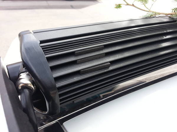

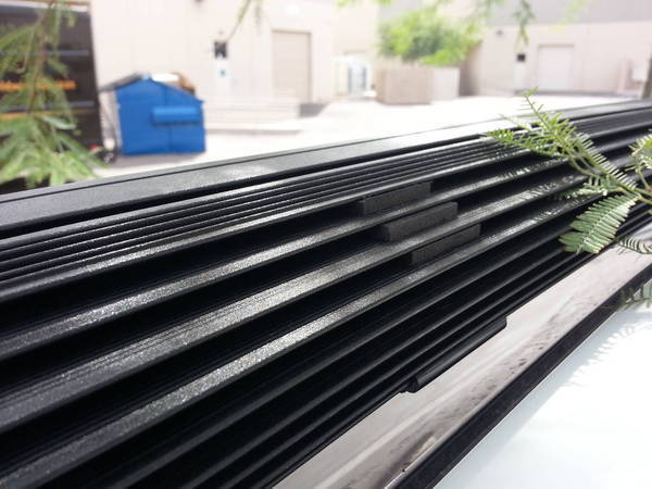

    got you homie
    3 pieces in the first 3 fins from top to bottom.. in 3 sections of the bar. one set of 3 on each side.. one set of 3 in the middle.

    mine actually made the vibrations worse at certain points

    :notsure: mine is silent.. no issues here.

    What did you use for the inserts? Did you put some on the bottom as well? As a test I through some ductape over the bottom fins and it stopped the noise.

    > BUILD LINKS >
    Some medium/high density foam cut to fit tightly between the top 3 fins. Nothing on the bottom. Im not sure if specific fins (top or bottom of bar) is what makes the noise go away. The top 3 are just what I did first and it solved my whistle. So its possible other areas/combinations/fins will solve it as well.

    Ya you helped put em in. Idk. It may he the bar having a bend in some of the fins
