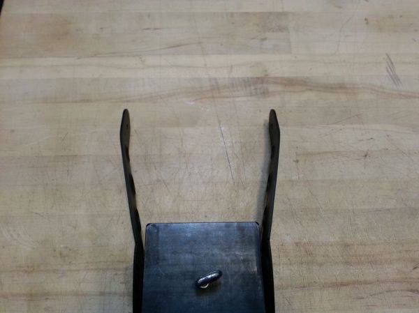

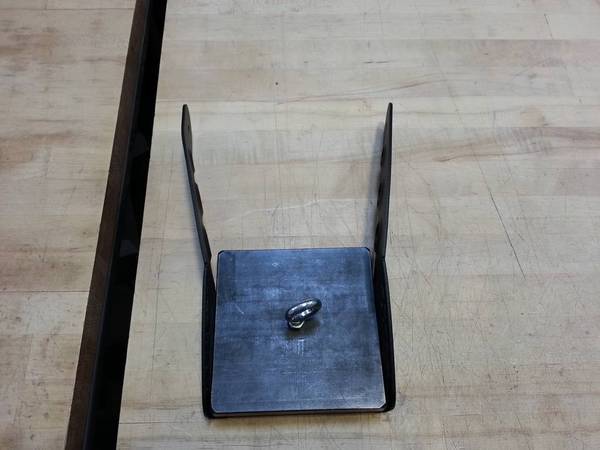

    guess I could work on the new Relentless brackets. brought them into work to bend the ends for the radius bar..

    Hey Rick.. if you see this.. how does this look?

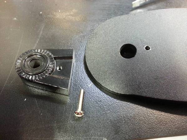

    I think these are about perfect..

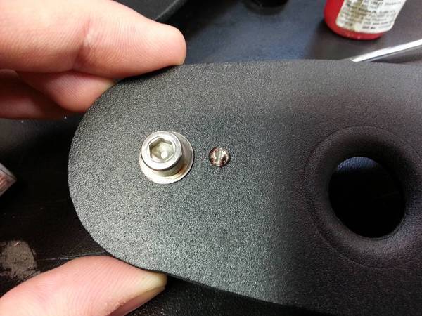

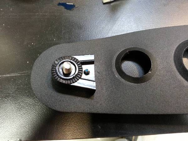

    Drilled and tapped for set screw.. used a portion of the light bars mount so it can be set and "locked" into place and stop the bar from rotating. Thanks for the headsup on this Rick (squint)
    Locktite and ready to go.. gonna mount them tomorrow.

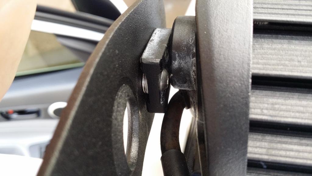

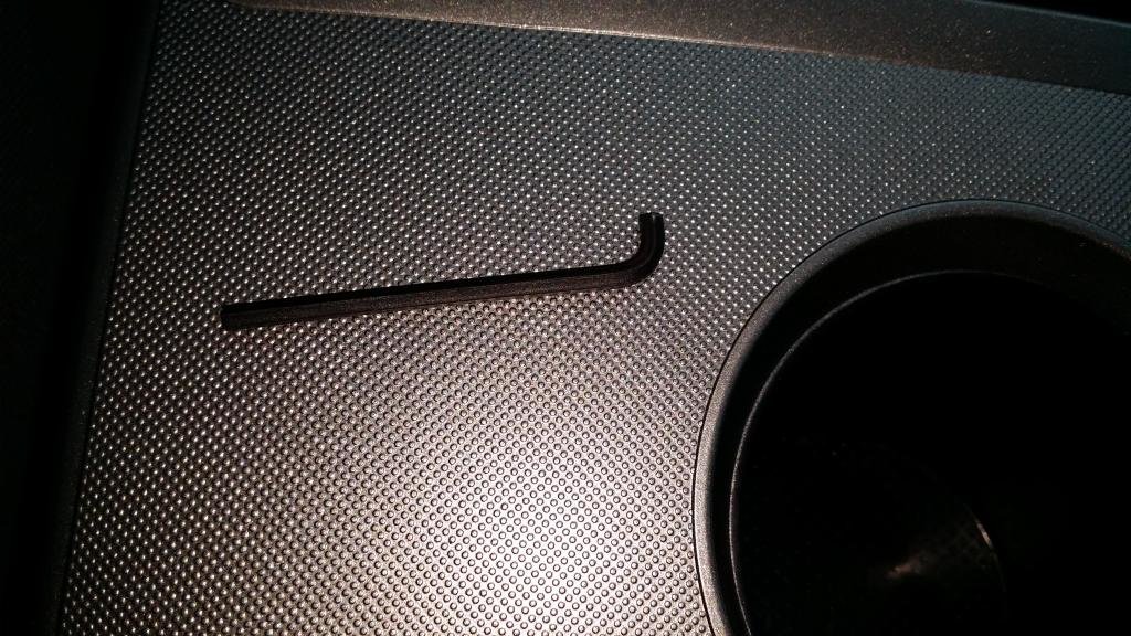

    Brother...you nailed it!...:D That's exactly how I did mine. That little set screw is a PITA to tighten after you mount the bar on the brackets and I had to modify an allen wrench by cutting the head down so I could tighten it down. You can see in the pics. I also need to paint my hardware...:D This weekend. Slapped it on last weekend in a hurry...

    I should have used a smaller set screw...lol Yours looks cleaner...:D Nice Job!
    Edit: You see those little white specs on my bracket? Shitty Powder coat job...:( Gonna have to respray my brackets I think... The reason I use the Hex Cap head on my set screw is because I drilled the set screw channel with a 10 degree sweep up and down, so I could adjust the angle of the light bar if it was aimed improperly. Hence the bigger bolt/nylock...:D
