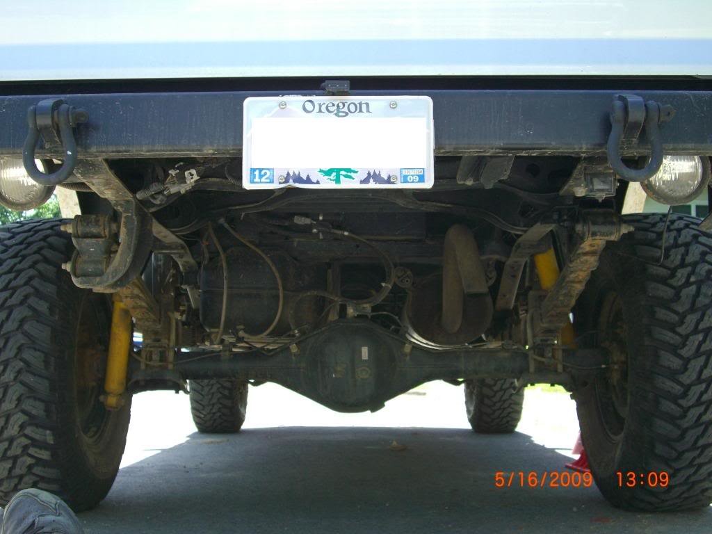

    Im going to use ATO's picture to show inverted and standard shackles and why it lowers our trucks.
    the leafs and axles dont change positions when going to longer shackles. the frame does get higher or lower though. so a longer shackle on our trucks will lower the frame. while the first gens get a lift from longer shackles

    Theres the stock size DE shackle and an extended one (dont know how much longer). The longer ones push the frame down for them to fit and thats how it lowers the rear

    ok, so David.. in that pic.. the left is the stock shackle correct? the right is the new one? im confused now too, because you said the longer one is what lowers our frame.. what am i looking at in that picture?

    No, The left is and inverted shackle how stock is setup. Right is with the shackle flip

    That's what I said isn't it? Lol
    Which Is why it does look a lil lower on the right?

    it looks lower because it is. lower the spring pivot point on a that and you get lift. Its the oppisite then the inverted

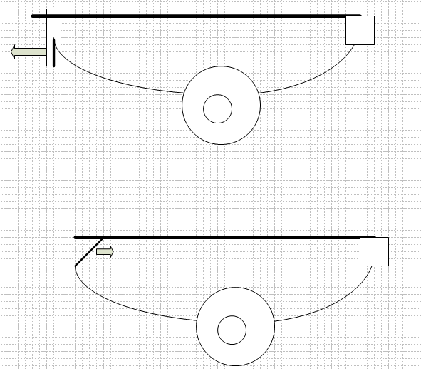

    ICON Stage 6, RCI Skids, Blacked out
    Here I made this. It more to show axle wrap ut you get the idea
