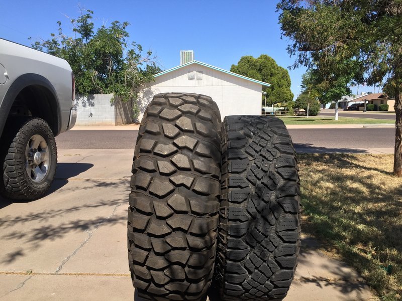

    I like mud tires and I use them too, but I don't know if I'll get them again. If I do I might get less aggressive ones.

    guess it depends on the kinda of deal.. ;)
    all good points.. :) and they do look fantastic!
    I cant depend on that short commute all the time though. AT's are definitely cheaper as well, not to mention lighter.
    I dont NEED them for sure.. but the couple times I have been in snow/mud.. those MT's of Snowtanks were doin great.. and I was doin shitty. but realistically.. they wont see that terrain all too often.. but.. again.. they do look fantastic! lol
    bumpers for sure. I want to at least get a tiregate.. weight savings is still abig factor for me. if I can run that tiregate.. keep my bumpers (until I actually do rip them off) I will be good. I like staying light.. makes that S/C that much more fun. I'll save the bumper purchases until I actually need them.
    good to know. :thumbsup:
    I will most likely stick to an AT.. but definitely going with a 34".

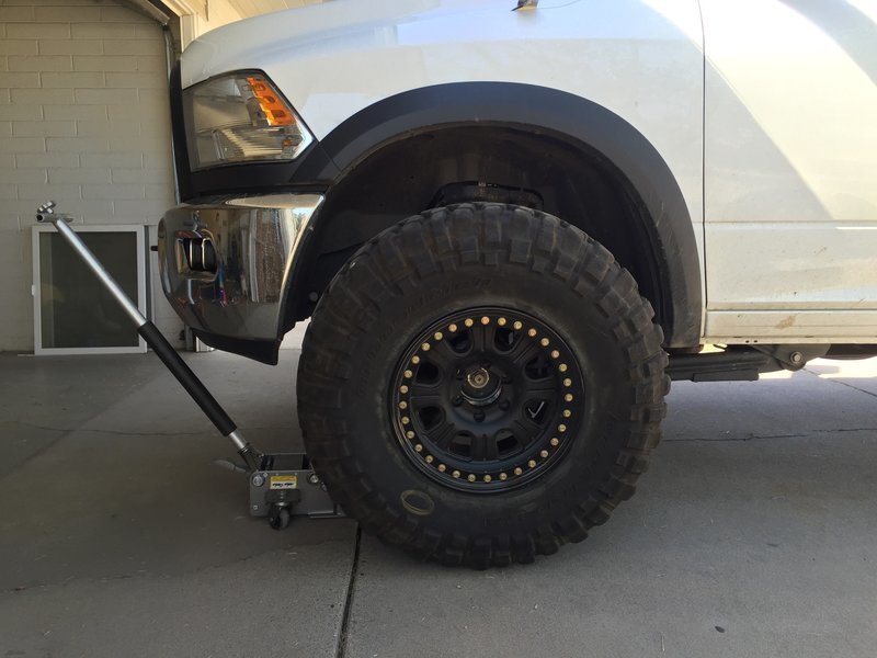

    I can mock up a 37 from the buggy, @iJonny has extra spare 34s that I could do the same. Who has a true 35x12.5 on a wheel. *Yes, I know these 6 lug wheels won't fit, but I can stick them in place*

    Jason has a 35x1250r17. Ill be over at his place sunday if you want me to bring my extra spare over

    Yea, at least 35s need to go in there. Im sure you coukd get some decent money back on the OEM ones

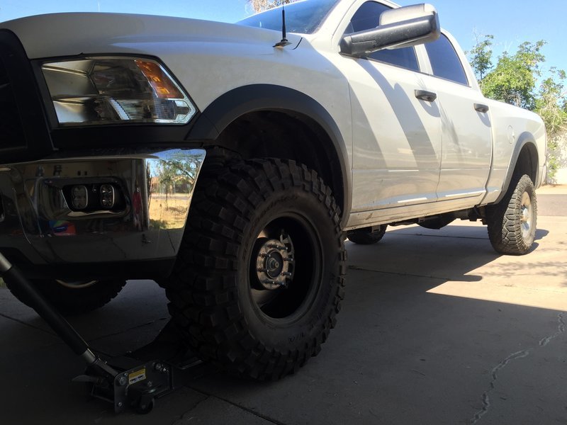

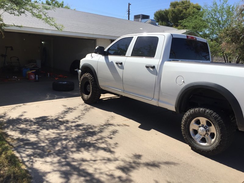

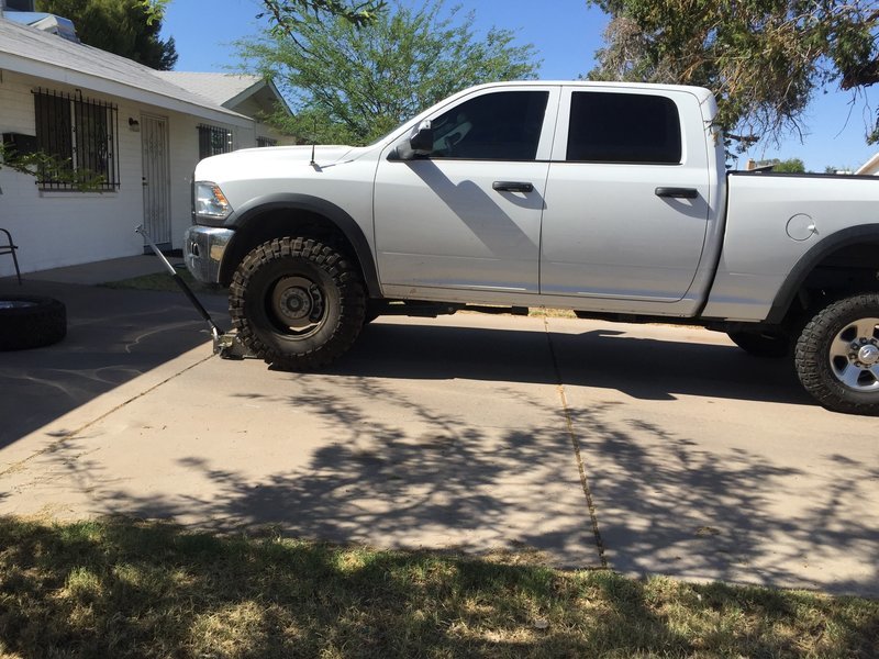

    I loved my 34s but now I'm back down to 285s until I can get a new set. I have no idea what I'm going to go with however

    So you ran a 285x75R17 and dropped to a 70?
    Or you ran a 315x75r16 and went to a 285x75r16?
  9. May 10, 2016 at 4:19 PM

    damn Ryan that looks good!!!

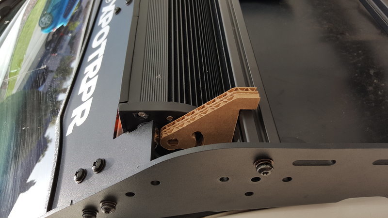

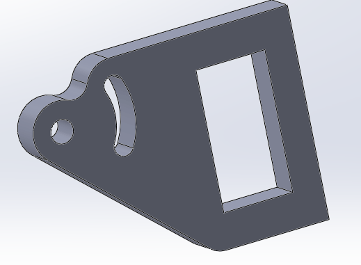

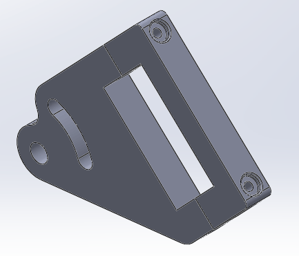

    workin on these... some custom light bar mounts for the roof bar. needed something specific to get it to mount and sit how and where I wanted it.
    1/2" aluminum. will be split height wise, dead center of the rectangle opening. then counter sink some m6 bolts through and tap the other side. it will sandwich around the Prinsu cross bar.

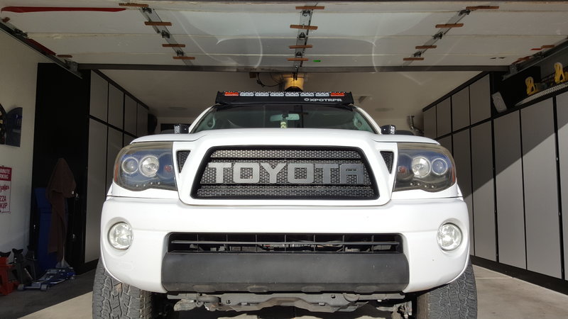

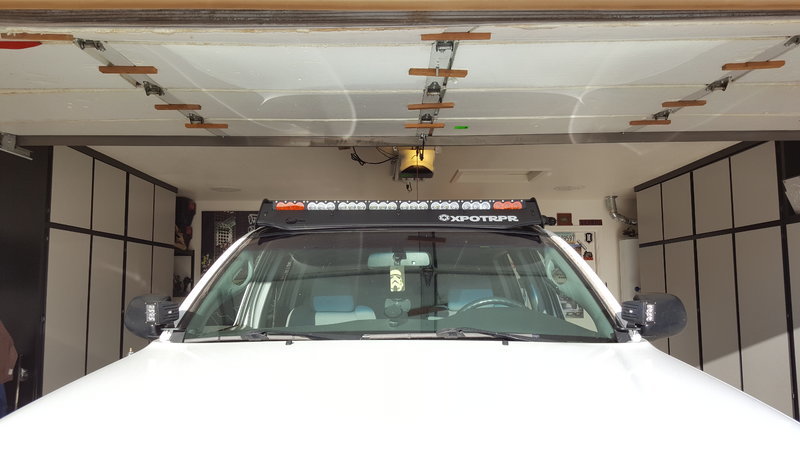

    like this actually..

    My first instinct was why 1/2", but you need the meat to tap the holes. So, take it back up a level and counter bore for the bolts to the lights. Keep those heads flush!
    I like it though! You're doing good at that.

    yeah.. for the bolts, but also just for rigidity.
    absolutely! they will be counterbored. ran out of time to add those along with some fillets/chamfers.
    thanks man! I really appreciate it!
    I just did a mock up.. fuuuuu I was so close on the first try! lol needs to be shortened by just a few mil.

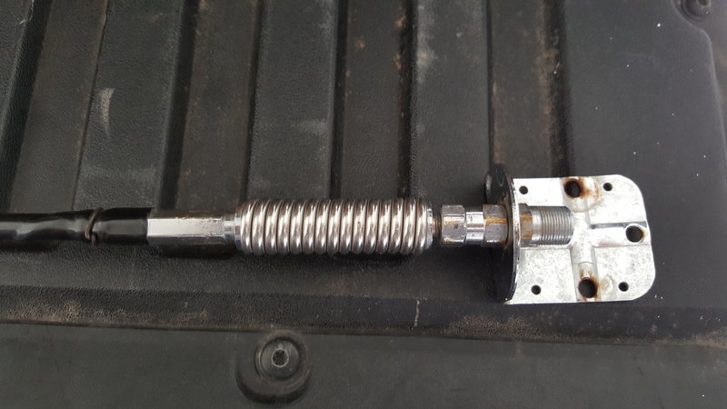

    one more thing... I've been struggling with this damn antenna for a couple years now. the stud is stripped.. I cant tighten it, or take it off.. I also cant tell which end of the stud is stripped. maybe both. this section will NOT come apart.. was hoping I could take a cutting wheel to the stud and save the antenna.. but looks like I might need a whole new antenna/mount. Loves this weekend.. maybe I'll get a 4' instead this go around.

    Tried Vise-Grips on the spring near the stud or antenna while attempting to break it free? But given the squawk/screech/feedback and the importance of the antenna in the system, replacement is a good idea.
    Is the "plastic" insulator in there against the mount? The mount needs to be grounded and in place to have a reflective ground plane, but the antenna/coax conductor need to be insulated from the ground plane.
    Shit antenna can ruin/damage a great radio while an Awesome antenna system can liven up a basic radio.

    yeah.. tried from either end, of the spring and the mount. everything just seems seized.
    that, I know, is one of the problems.. I somehow misplaced the plastic washer and I think a lock washer at one point when I took it off for whatever reason. probably part of the reason why its stripped feeling. went too tight and cross threaded maybe.
    I will probably end up just getting a new antenna/components. the coax and everything should be good still. anything you recommend Ryan? Like I said, I will probably just run to Loves and see what they have on the shelf.
