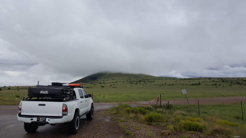

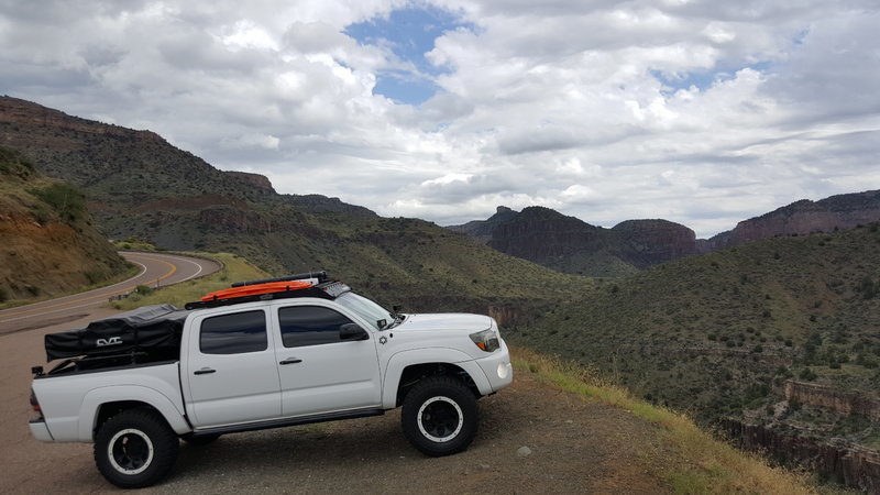

    Some pics from our road trip.
    Want to go back and check out this trail. Heads up to the top. Should make for an amazing view.

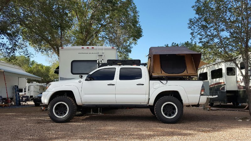

    And successfully infiltrated the RV park. They never suspected a thing...
    #campwhenyacan
