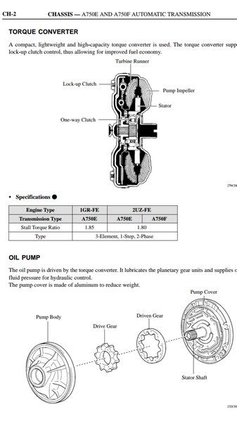

    Sorry still getting used to the phone, the magic number is 1.85 for stall speed.

    now knowing that... what would you suggest? lol The price point is a huge selling factor for me, especially with all the other things on the list to get done.
    and crap.. i dont know the conversion..
    ratio of 1.85.. need to figure out what rpm that puts it at.
    EDIT: or is that roughly 1850 RPM..
    seems most ratios range from 1.8-2.5:1. so im just assuming.
