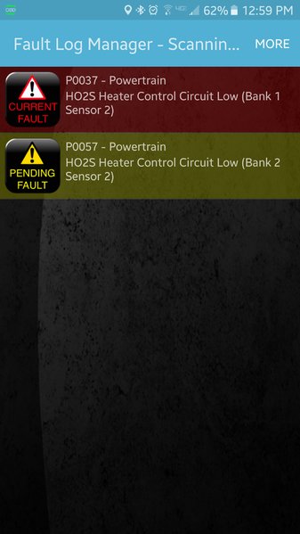

    Disconnected the battery. Disconnected the o2 sims. Cleaned them with electrical cleaner. We will see if that fixes my codes.

    Well, codes are still there. Gotta figure this out as I have emissions next week.

    I'm 90% sure thats all it is. I have had these before, and I think I cleared them with my Torque app.. I just dont have my scanner currently so I'm "worrying" when I know I'm probably fine.

    It said bank 2 have you tried swapping/chasing it with the bank 1 to see if it will throw for bank 1 instead?

    I popped those similar codes when I installed this stroker engine. Disconnected the sim, and the codes went away. The sim had gone bad.
    Try leaving yours disconnected, and see if anything changes.

    no, I will try that too if the code reader doesnt clear it.
    THAT.. is a high possibility. so I just disconnect and it wont throw the CEL? how does that work? a failure will trigger a CEL but absence of one all together doesnt?

    Oh no. It should trigger the normal CELs for no cats. Which would mean all is normal.

    ok, cool. I will try that after I clear this sombitch. lol

    So, thanks to @Aw9d got the codes cleared and they came back. Going to disconnect the sims tomorrow and scan the codes again.

    So the Sim is completely disconnected, and there are ZERO codes...

    Nevermind. They came back.
    Gotta be the Sim right?

    any tips man? Should I just go ahead and order another URD Sim or should I test anything else to be sure?
