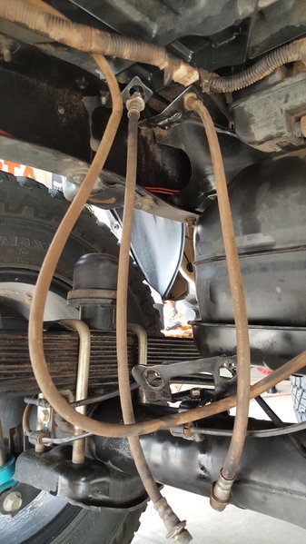

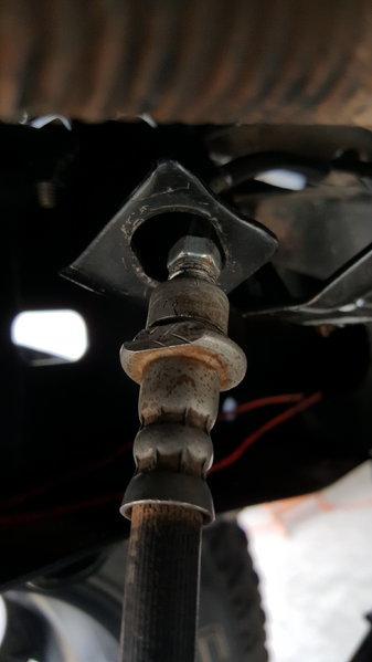

    @MrCrowntown did you have any issues with the rear lines not separating at the flare nut?
    I got the flare nut on the top hard lines broke free.. But it just spins and spins. I cant separate the hard line from the OE soft line...

    @Crom @05TacoRunner @2ndGenJonny

    Like the actual threaded part is loose, but the flare is stuck in the ooem flex lines? You can always text me to get ahold of me faster btw

    Yeah, the threaded section is loose, but also stops halfway.. I can't tell if it's fully unthreaded, or stripped on the second half, OR, if the flare is stuck.
    Looks like ill be putting the rear back together, that's if its not fucked already.
    Didn't do anything different than the others.. And they all came apart fine.

    Sounds like the flare is stuck. Doubt you messed up the threads yet, when I did mine it was a bitch too. Just a connection that has never been touched since the original torque at the factory.

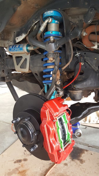

    In the meantime..

    I don't know how to go about it from here. It just spins and can't pull it out either. Hmmm

    I would just gyrate the fitting in a bunch of directions while pulling them apart. Not much room for it, but its what I had to do too. Lots of corrosion miles on mine and im sure yours is the same.

    Haha christmas brakes !! Looks rad with the rotor black
