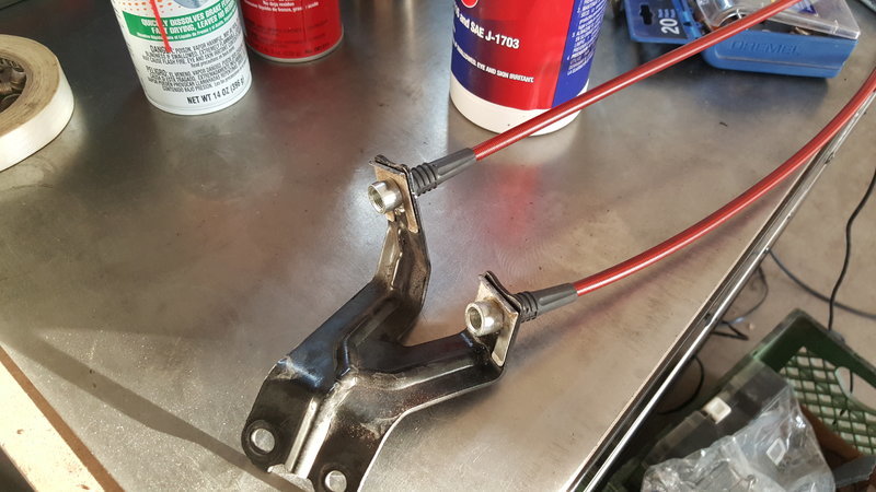

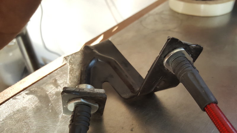

    So, got the old lines off, new lines are installed on the bracket after taking the dremel to the one mount. Should be l downhill from here. Slap everything back together and bleed.

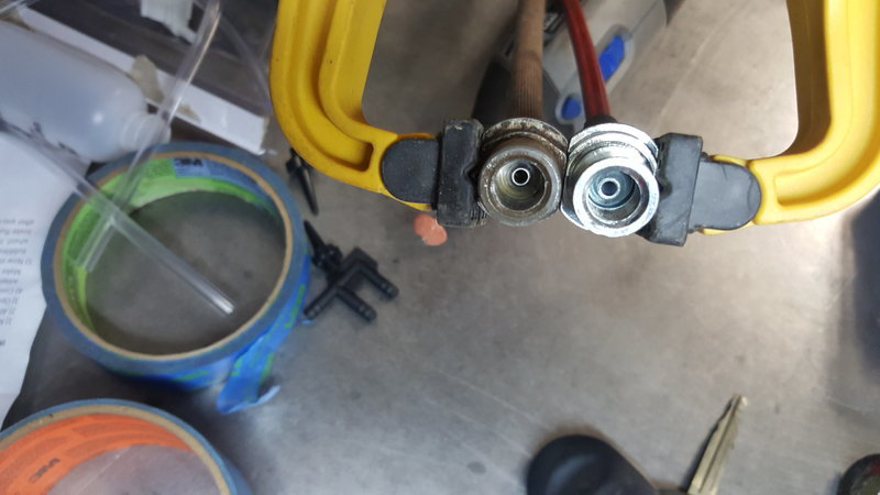

    These rear lines just will not go on. Ive tried everything I can think of. I managed to connect the driver side line to the hardline at the frame, but even that one felt like crap and I'm actually concerned its not even fully on there.
    The threads on the hardline dont even reach far enough to engage. Just feels like its bottoming out before it can. That, and when I bring the threaded portion all the way to the flare, and try threading it in from there, it seems to not fit the diameter of the new line.
    The old lines go back on just fine. Am I missing something?
    ChadsPride likes this.

    Old vs new

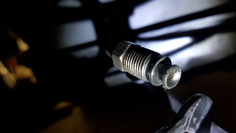

    Ive been manipulating the hard lines to get them as perfect as possible. That does seem to play a big part.
    The threads seem fine. I do notice a bit of material on the flare portion. Almost looks like old plumbing tape when you undo a connection, I can't tell if its metallic or not. Like shavings or something. One sec...

    Take a brush and clean off as much as you can. Every cunt-hair counts !!

    Hahaha!
    Man idk why I didnt think about that! Ill try that in the morning. Thanks.
