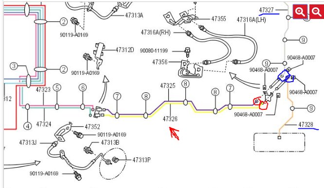

    I had to cut out the Hardline and replace with new to get mine on. Had same issue trying to separate.
    If you can get the old lines back on, I'd do that.
    I think this happens because the factory has hired the Hulk to torque the flare nuts. He use too much force, flare is being deformed.
    The hardline is sold at the Toyota parts counter, prebent and flare nuts installed. Very reasonable cost!

    Try and get the threaded collar pulled away from the flare, and get the flare in the hole first. That should help you determine how aligned your fittings are.. im sure this is something youve tried already but its what I would continue to do until it starts the threads

    Exactly.. Lol which makes me believe its bottoming out or something. I can get the flared in all the way... And the threaded section will not engage.

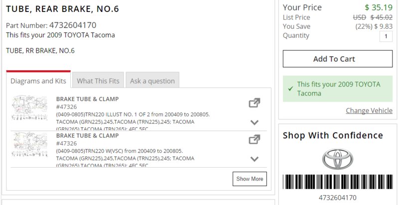

    @XPOTRPR how far are you from a dealer? Might be worth it to just uber there in the morning and buy the new line.

    47326 looks correct to me

    thats just for the top line.. oh wait.. I need 47325 as well. a total of 4 new lines.. no.. nope.. gonna stick with it I guess. lol
