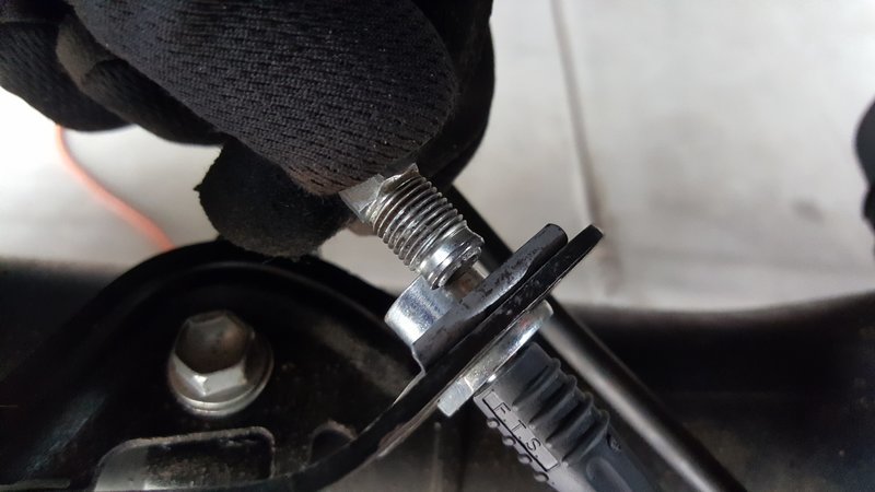

    Here's my problem. The threaded portion doesn't seem to fit into the new line.
    ChadsPride likes this.

    Got one! 3 more to go. Lol
    The one pictured above is a PITA. Doesnt seem to "snap" in so I cant engage the threads. I got the left one (driver rear) on that axle bracket connected.

    Yeah. I think we found the culprit tho. The threaded ends are flared out enough to not go into the new lines... Most likely due to over tightening like mentioned previously.

    Josh do you have a die that you could chase the threads on that fitting?

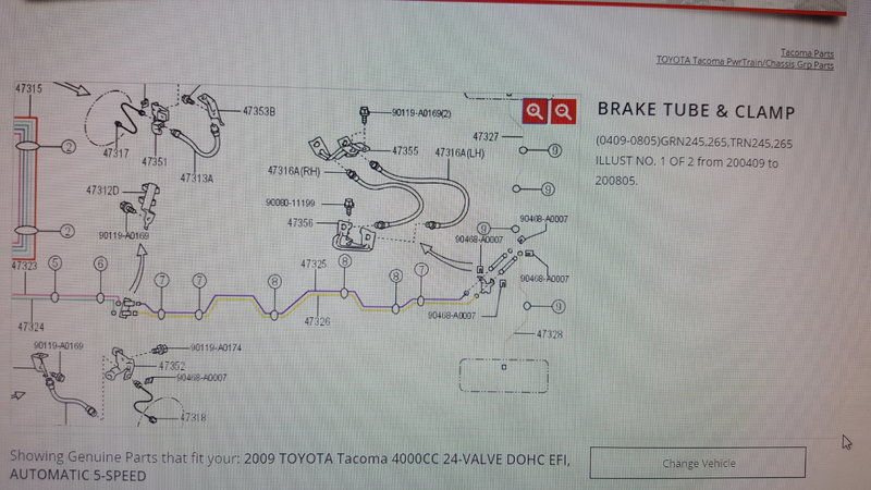

    Gonna run to the dealer and get the two hardlines that run from the top above the axle, to the middle of the truck.
    47325
    47326
    More work, but gets it done. I have to have this thing going by tonight.
    Front is all done, just need to replace these hardlines, attach rear lines (bottom on the axle are all done) and bleed the brakes.
