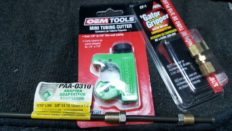

    The last one (top right) was just, not, going, on. I ended up having to get pre flared line from Autozone, pipe cutter, and a compression fitting. Got it all cut and installed. Getting to the fittings was a PITA for sure. Thanks @05TacoRunner

    So incase anyone else runs into this issue and is unaware. Autozone does sell pre made brake lines with the correct fitting. The one Josh bought was an adapter line but he only needed the one side regardless. They also sell splice kits that utilize a compression fitting to splice tuner lines. I had Josh go to AutoZone and buy the parts. He ended up cutting off the factory line a few inches Bach from the flare. He then cut the end of the adapter that he needed off and spliced the two lines together utilizing the compression fitting.
