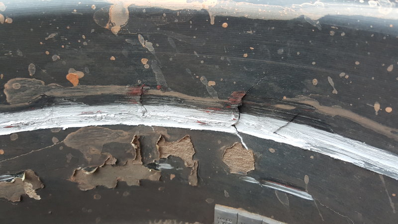

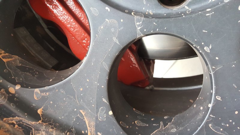

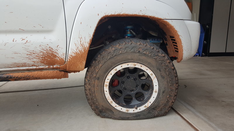

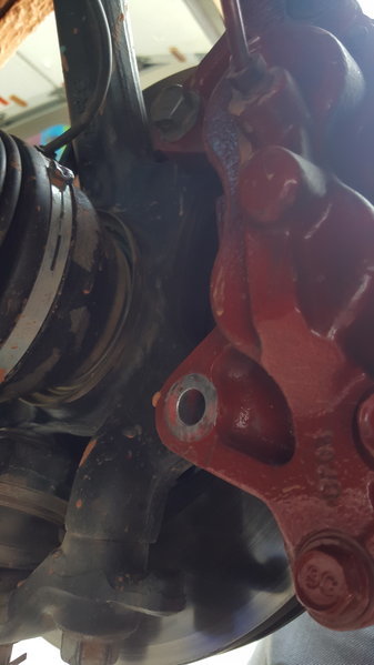

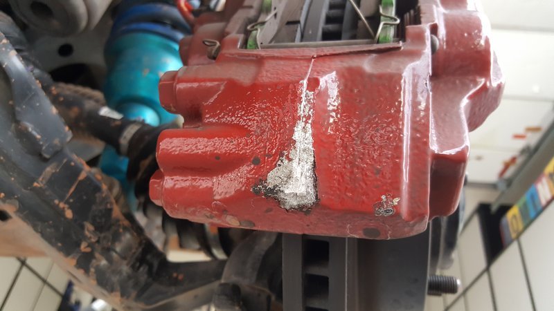

    Soooooo this just happened..
    Brakes started grinding and I could feel resistance while driving my 3 mile commute home. I babied it using lower gears to slow my speed, got to the house, turned and had to use brakes to get into the driveway.. got really bad.. stuttering.. truck was trying to drive, but was stopping, like the brakes were seizing. As soon as I pull up into the driveway, when its at its worst, I hear the tire pouring out air. I stop the truck, park it, turn it off, jump out to see this.. pulled it apart and holy hell...
    Caliper bolt fell out.. caliper was rubbing the wheel, enough to gouge it and break my wheel in 3-4 places. I am SO thankful and lucky this happened here, now, rather than 2 days ago when we drove 300+ miles, driving 80, wheeling, and when Lyd was in the truck.

    we just did that trip to Sedona too.. idk how it happened just now leaving work. I guess I was just rushed maybe trying to finish all that shit that weekend, and didnt torque it enough :notsure:
