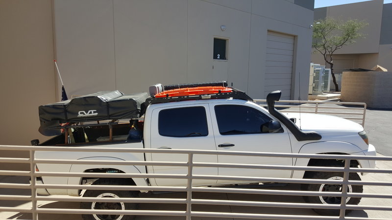

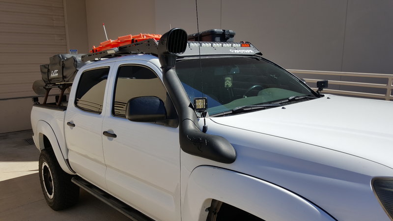

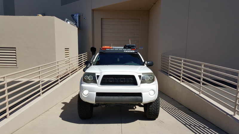

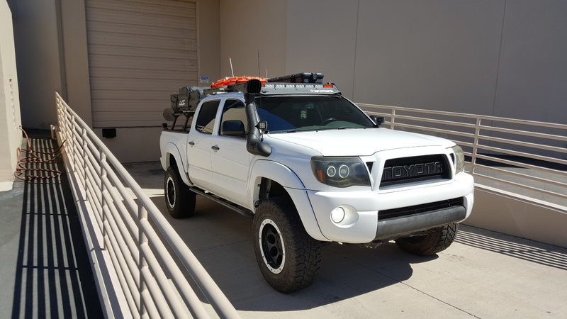

    Finally got around to getting some pics..

    Look at that pro alignment with the door lines :anonymous:

    :thumbsup: lol! thanks again for the help doooood! I agree. ;)

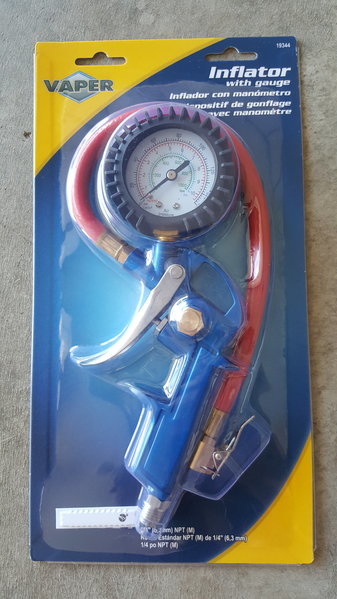

    Picked this up. 15 bucks... We'll see how it does!

    :headbang: looks great!!! Welcome to #snorkel life lol

    Where did you pick that up

    Autozone! Lol

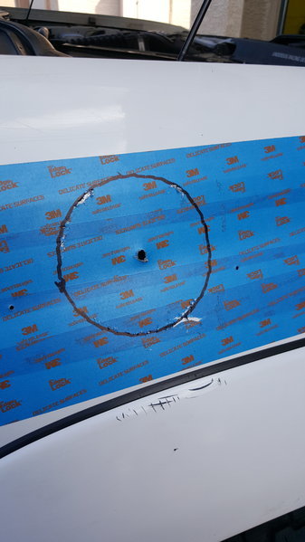

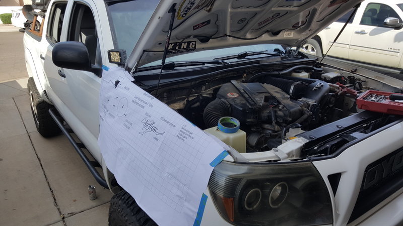

    josh you said you used a dermal for the snorkel. did you also do the blue tape on the fender when cutting it up?

    Oh yeah absolutely. Lay down blue tape over the entire area, including your flare. Lol
    Lol.
    The pilot bit snapped on the hole saw too. Gotta take it back to home depot.. POS..
    Then just used a dremel with cutoff wheels, cut into pizza slices, then cleaned up the edge with cutoffs and sanding wheels. Much easier and more controlled.

    Some other pics from the day..
