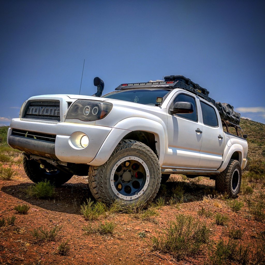

    With the help of @Milota95, @The Fluffer and Evan.. got the new tierods in. Alignment done by Qrampage.. good enough to get me to the Dealer for Serp Belt, Idler Pulley's, and an alignment.

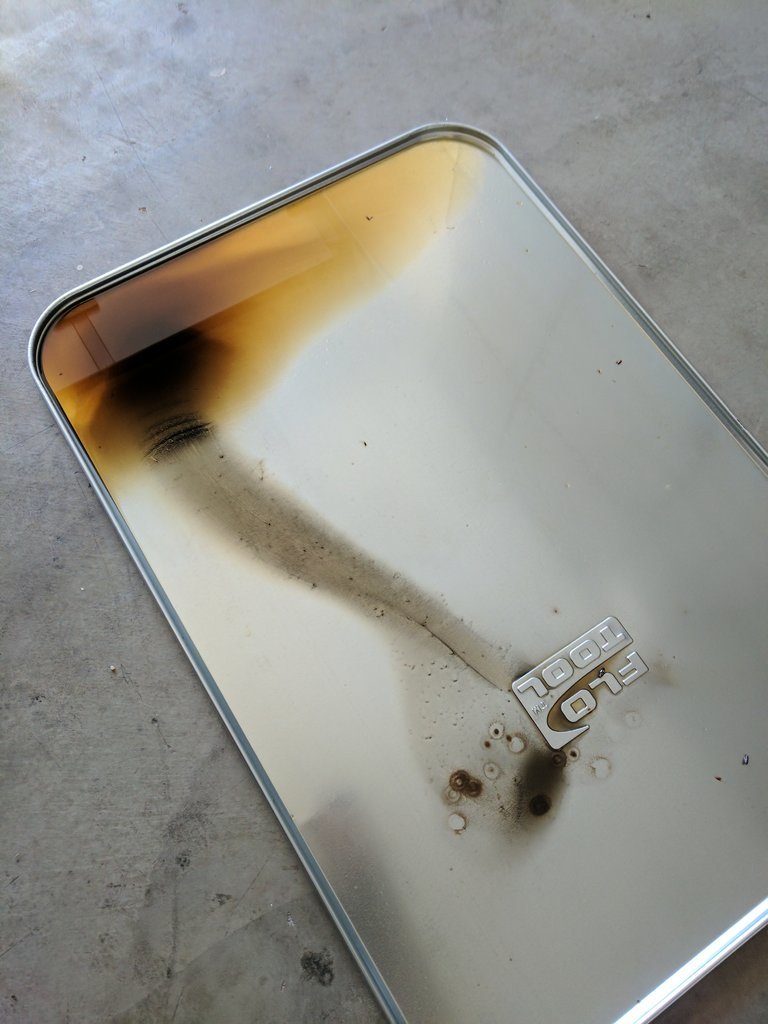

    And this will finally be fixed next week with the addition to 4.56's.
