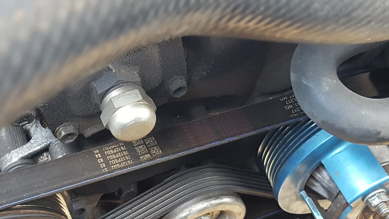

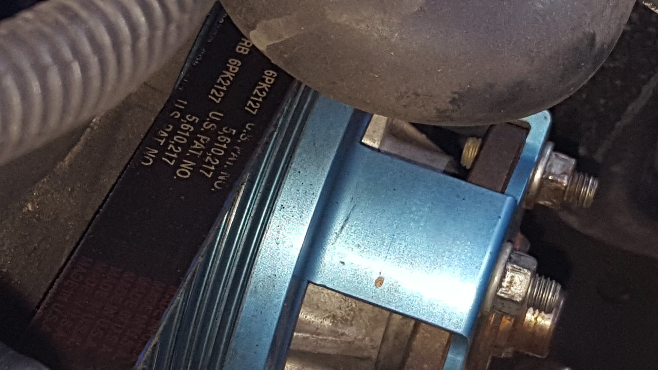

    do you have the part number handy for that blue Gates belt of our trucks? I want to double check I have the right one..
    This is what I ordered.. just picked up the truck from Toyota.. alignment is spot on, truck sounds so much smoother wityh new pulleys... took it for a drive on the freeway real quick.. gained 1-2 psi boost back... but when I pulled into the garage and popped the hood to check on everything.. I see this..
    this is what I ordered..

    I definitely gained up to 2 pounds back.. I was at a consistent 6 and flashing 7 just now. so maybe the tensioner.. maybe the new belt (or lack there of sine it was eating itself)

    ok, back from the dealer.. again. they got a new belt on for me, no labor charge.
    BUT.. im back down to 5 psi, flashed 6 barely.. of boost.. SO.. belt slippage for sure. I bet the Gates belt I had that was shredding wasnt allowing stretch.. @WOODEX M.E.

    As Tor said.. in our texts.. by process of elimination.. came to realize.. that... Wait for it... Big shocker.. installation error.
    The tech surely didn't have it aligned. He mentioned he placed it all the way back on the pulleys (engine side) and when I found it shredded, it was all the way out on the fan side. It must have jumped.
    The increase in boost, per my gauge, was most definitely noticeable. I have been driving around for months around 5psi.. and I saw a consistent 6 and 7. Not just a flash, a good 7lbs cruisin.
    When i drove the truck a second time with the new OEM belt, it was back down to 5..
    Less resistance with less ribs? Better material compound with less stretch? :notsure: all I know is I plan to swap BACK to the gates and align it myself this time. Then after my findings.. adding the gates S/C belt as well to see if that helps on top of it.
