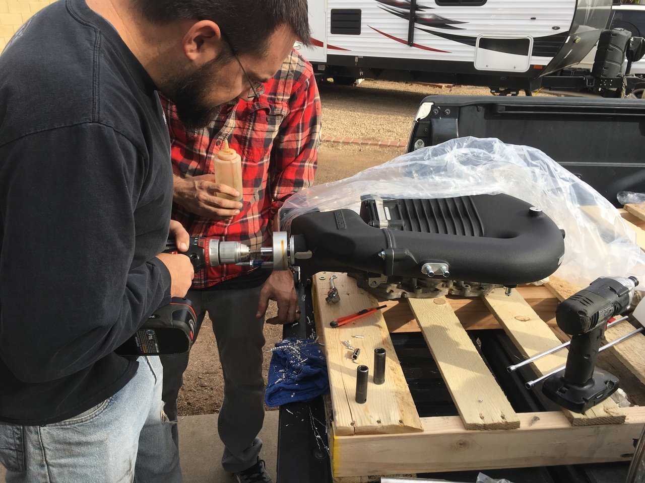

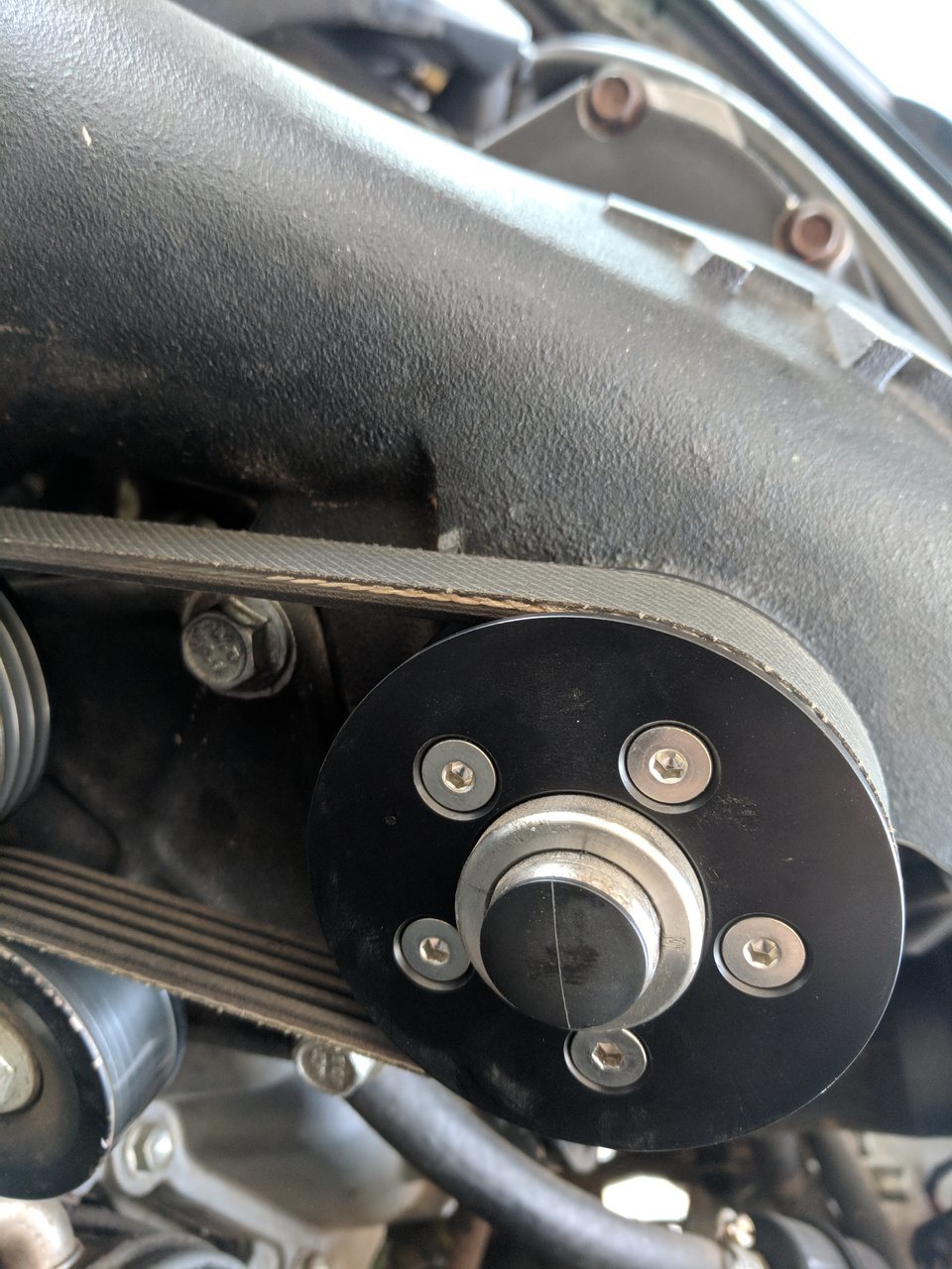

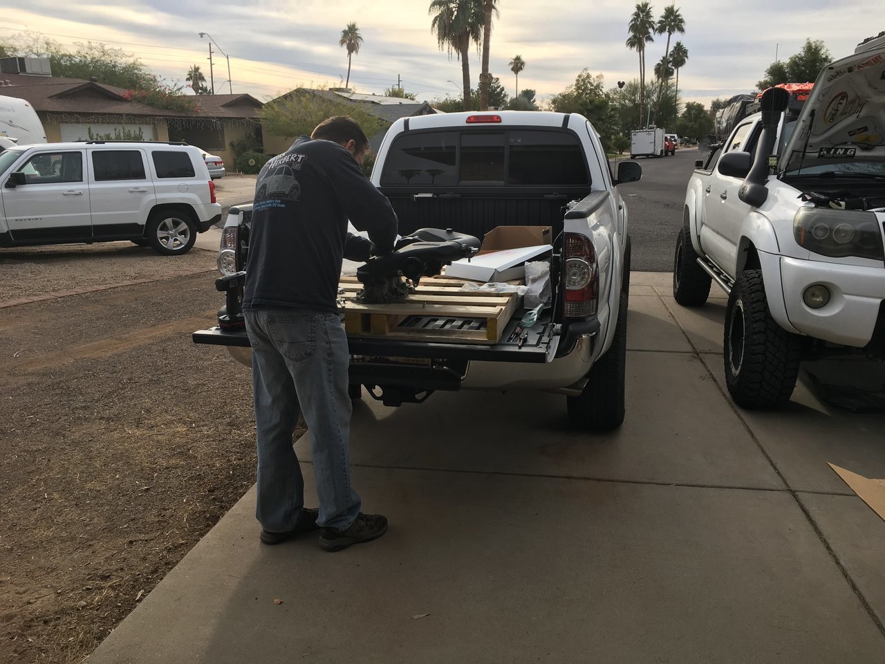

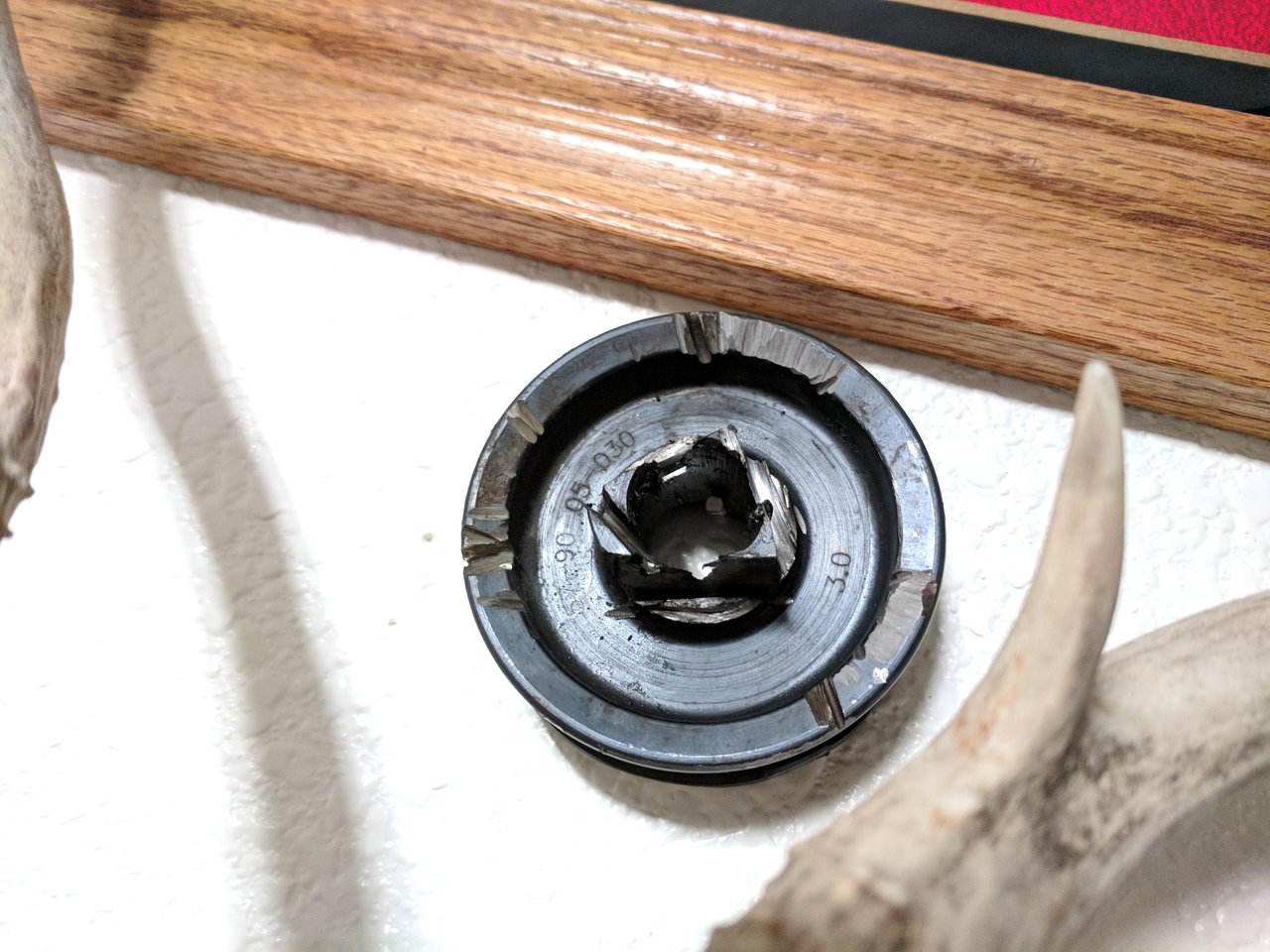

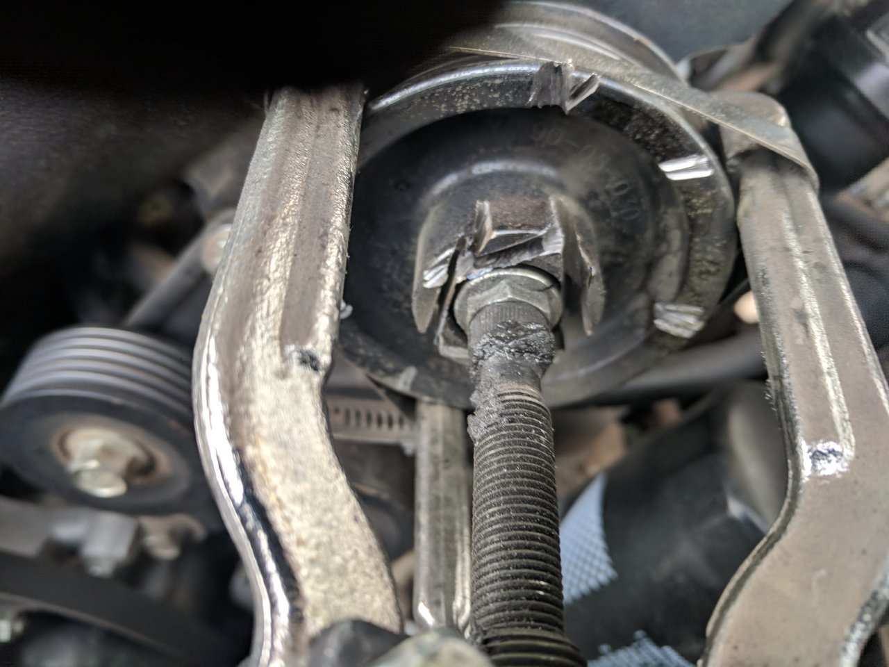

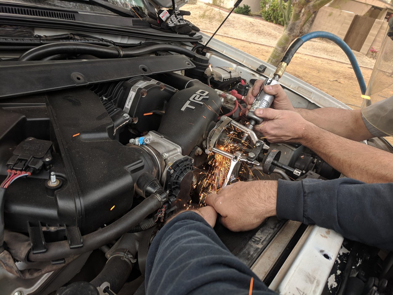

    Also.. a huge shout-out to @racebug68 (Travis) and @BillDaCat8 (Jake) for the help today installing my 2.6 pulley... :cheers: great to meet you guys and I really appreciate today. I owe ya after all that. :rofl:
    What.. a cluster. Hahaha.
    The 2.8 did not want to part ways with the shaft. It was seized so badly, the puller was deforming the backside of the pulley. We tried heat, lube, etc and finally ended up just taking a cutoff to it. Jake was like a surgeon and made a few cuts to help relieve any tension. With one last attempt and using the puller.. it Popped.
    The rest went pretty smoothly and we cut the snout then installed the hub and pulley. Drove it back home with no issues on the drive.. and boost is up from my lame ass consistent 5/flash 6... To a consistent 8/flash 9. Definitely happy with the gains and if my pulley wasn't being a pita... I'd say the entire process is really quick and easy.. especially for the payoff. Still burying my AEM afr at 10... But after talking with Jake a bit.. I think I'm going to try moving my sensor to my Y-pipe.. see what happens.
    Again.. huge thanks to @racebug68 and @BillDaCat8.. my truck always seems to put up a fight.. and doesn't care who's involved.. so I apologize for that inconvenience.

    Initially, we were working between the arms of the puller. Had to be super careful not to beat up the shaft or damage the puller. We were just trying to weaken its hold a bit. There was huge tension on it and we were hoping it’d pop. Finally, we decided to remove the gear puller and just get after it from three sides working the grooves we’d already started. Then, we slipped the puller back on and went at it again. FINALLY it let go and we cranked it off. This was a stealth pulley. Had been on there for something like 100k miles. By the looks of things, IMO, it was pressed on dry.
    I’ve done four of these things now. This was by far the stickiest one.

    Was good to meet you, and yeah, that pulley was the queen bitch of all the head scratching 'holy shit what do we do from here?' jobs... LOL. Literally everything else is easy compared to that!
    Glad mine didn't put up a fight like yours, although thanks to Jake's quick thinking we solved my hiccup easily. I need to measure and be sure to tell the rest of the magnuson folks about the depth of cut for installing the quick change hub properly deep enough onto the shaft.

    Bigger hammer = cutoff wheel. Well done gents.

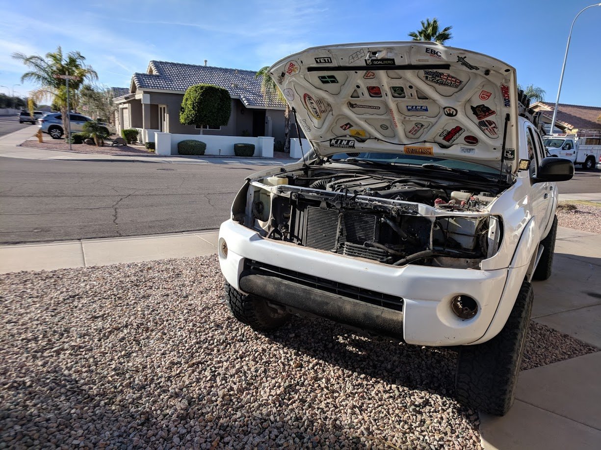

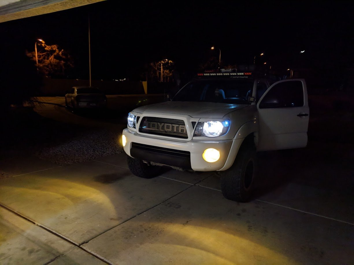

    also made some changes to the front end awhile ago..
    8csBIU-ZzdETcNt14f5Jmd5PXxEKXiWT8OTKYgW5_8b26e23f6b761953cb36d94dd1c3f1bde9f60d55.jpg
    X-V9o2vGpTG9eFCZxf0qNj5cbZ1Ehgr_RecSA5iz_a033ee3c18e0fd57f4ce3b1b1b2596c6151e876a.jpg
    Ml8HozPxjvLs7YBYmGOETAqCD9YKaIx9M3v5uR5C_aa1425f95b04ffae530dcfeed00dfda1f276b913.jpg
    Kc8mNy2ccrkxtPqkUd_Gqi5vISJjZu1C2Suy7so3_5e4963204a56b6ec06806e26edcebb1aba3eb9e0.jpg
    ditched all of my HID and projectors setup. wanted something more simplistic and easy to replace if needed. Plus.. as much as I wanted to build another set of custom projectors.. and had the parts waiting.. I couldnt bring myself to spend all that time and money to have them scratched and trashed on the next wheeling trip (which these already did from the above trip to Terminators lol) Happy with the output. yellow fogs with factory bulbs, and black housing headlights with Jumper's Amber turn signal, white parking lights, and then added eyelids.. finally. been on my mod list since I first joined T-Dubs. lol For the headlight bulbs, I went with a standalone harness to provide 12v power to the 100w H4's I picked up. definitely a good upgrade if anyone wants to stick to Halogens.
