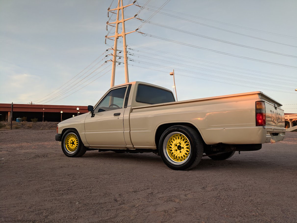

    first pictures of it.. lol

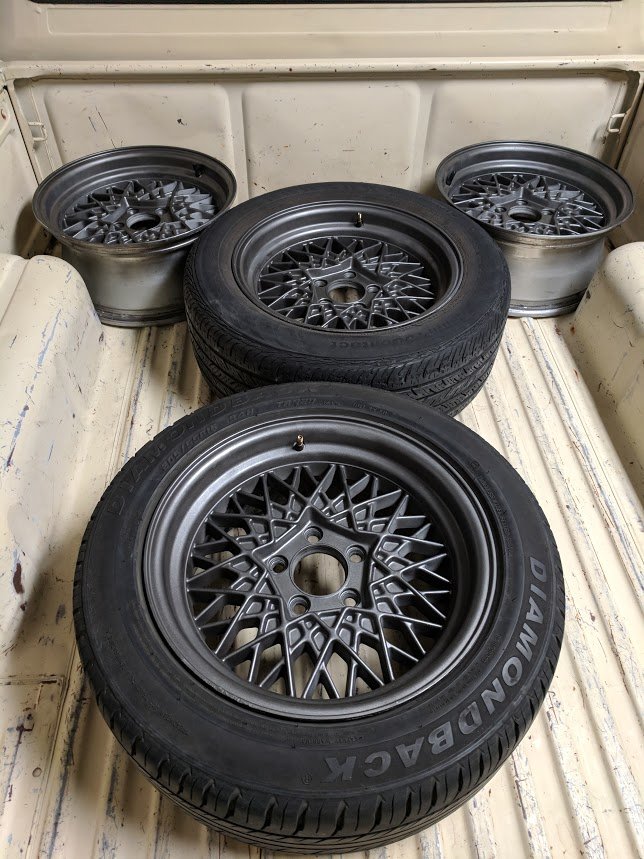

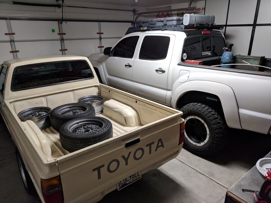

    oh yeah.. and picked up these for it tonight.. :anonymous:
    matching set.. thinking I'm going to have the lips polished, and then... IDK what color. Bright Bronze.. Teal.. white..

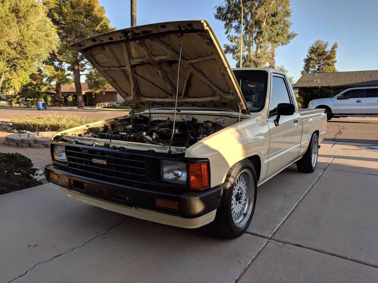

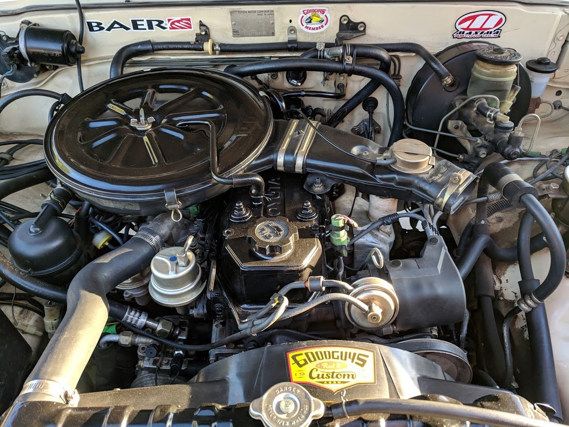

    I have an 85. 22r as well. Love this truck, you did find a gem for sure.
    If your trucks running great, I’d leave it. A Weber is easier to tune, it’s just an idle speed and air/fuel screw to adjust. Clears up the engine bay too of a lot of vacuum hoses.

    Oh hell yeah! That's awesome.. I'm excited they are the same then. I can pick your brain!
    Got ya. It does look clean. The truck cruises like a champ, but if I try to give it anymore thsn half throttle, it just bogs down, almost like it's flooding out. One time last night, I was waiting at a light, and it started to idle rough, had to keep revs up. After that, it was fine. I think the carb just needs to be tuned. So I'm curious if the weber would be worth it.
    It does! The driver side ducting needs to be replaced, (just going to get some flex ducting) and the AC vents could be replaced.. a couple of them have broken slats. Other than that, it blow hard and pretty cold. Enough that last night I had to turn it down. Lol
    It did seem to get a little warm while sitting in the parking lot, running, with the as AC on. Nothing too bad, not definitely started rising. Maybe a needle width or two away from the top white line. Cruising it's fine. Later in the evening it was fine, while sitting.

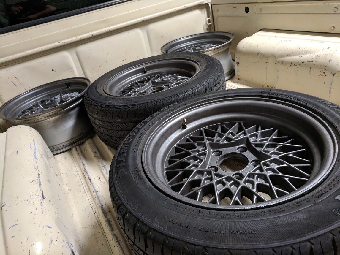

    Quick Photoshop by Colby (@Aw9d)
    Can't decide.. other options?
    AR15xAR10 and ChadsPride like this.

    Do you have to smog? If not, check out the LCE egr block off plates. It gets rid of more hoses. The rough idle could be a vacuum leak.

    Regisitering it today actually.. out of Phoenix.. so it won't need emissions.
    ALL the hoses have been replaced. I don't think it's a vacuum leak. He did say when he had to do emissions, it failed the first time, he tuned the carb right there to bring the idle up, and it passed. It does idle high when the AC is on. And that was the problem. With the AC on it increases the load. I think it just needs to be tuned better. I feel like it's getting too much fuel. I'll find out Monday when we can dig into it.

    I wish I could see these with the rear dropped another inch. Lol .That's my plan..

    Remove the valve cover and check the timing chain and see if it’s hitting the case. It can wear and leak coolant into your oil. Only design flaw of the 22r.

    I could dig the gold. The mint is just too much

    Yeeeeah I'm thinking the bronze/gold is the best so far.

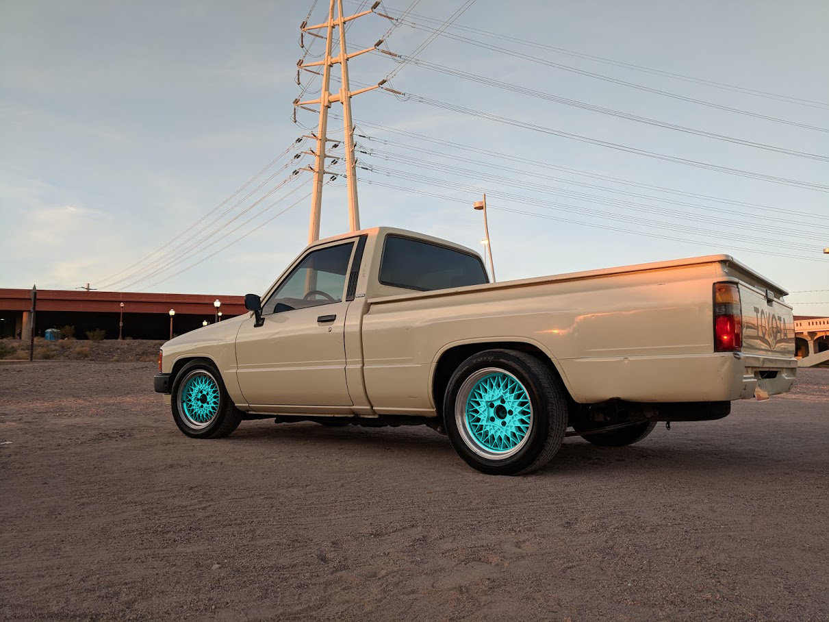

    Dropped off my 2nd set of Meshies to the wheel shop yesterday too.. and I think I decided on a color. Powder coat color code is "Trans Copper 2". I think the copper will look good with the truck. The plate will be copper, and have red accents.. iil be doing red accents around the truck as well. Copper and red. AZ FTW!
