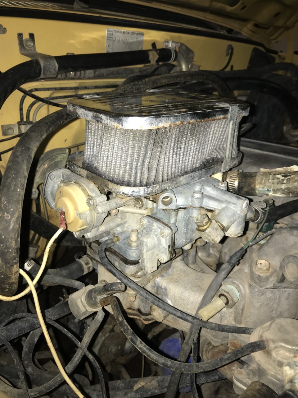

    Hey Guys, I picked up a 1983 Toy 4x4 that has a Weber Carb 32 36. I got a rebuild kit, but no instructions. Anybody know of a good YouTube link or pictorial set of instructions? Much appreciated.

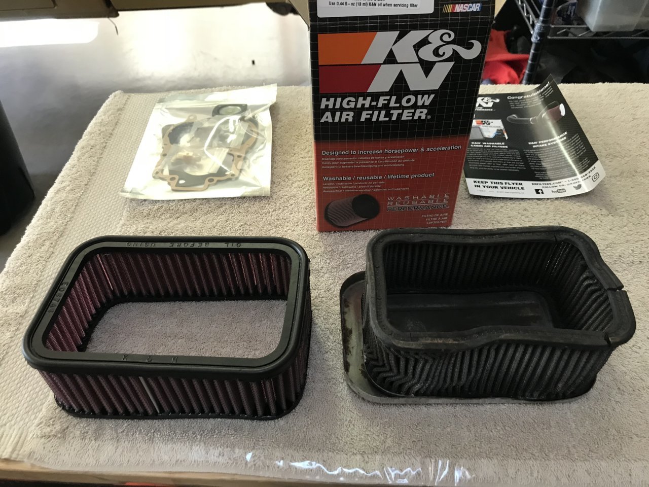

    You may want a new filter too.
    I have not seen a video on the kit, but most gaskets are unique and only fit one way so a rebuild is pretty straight forward.

    You can look into the bowl breather vent mod if you’re taking the carb apart. It’s needed if you’re going to take the truck off road

    No idea what a bowl breather vent mod is. Still working on the Weber 32 36 like a "blind squirrel". Gonna keep trying and will hopefully find a nut or a set of tear-down & rebuild instructions. There are about 100 YouTube Videos on the original Aisin 22R Carb and not one good one for the Weber.
