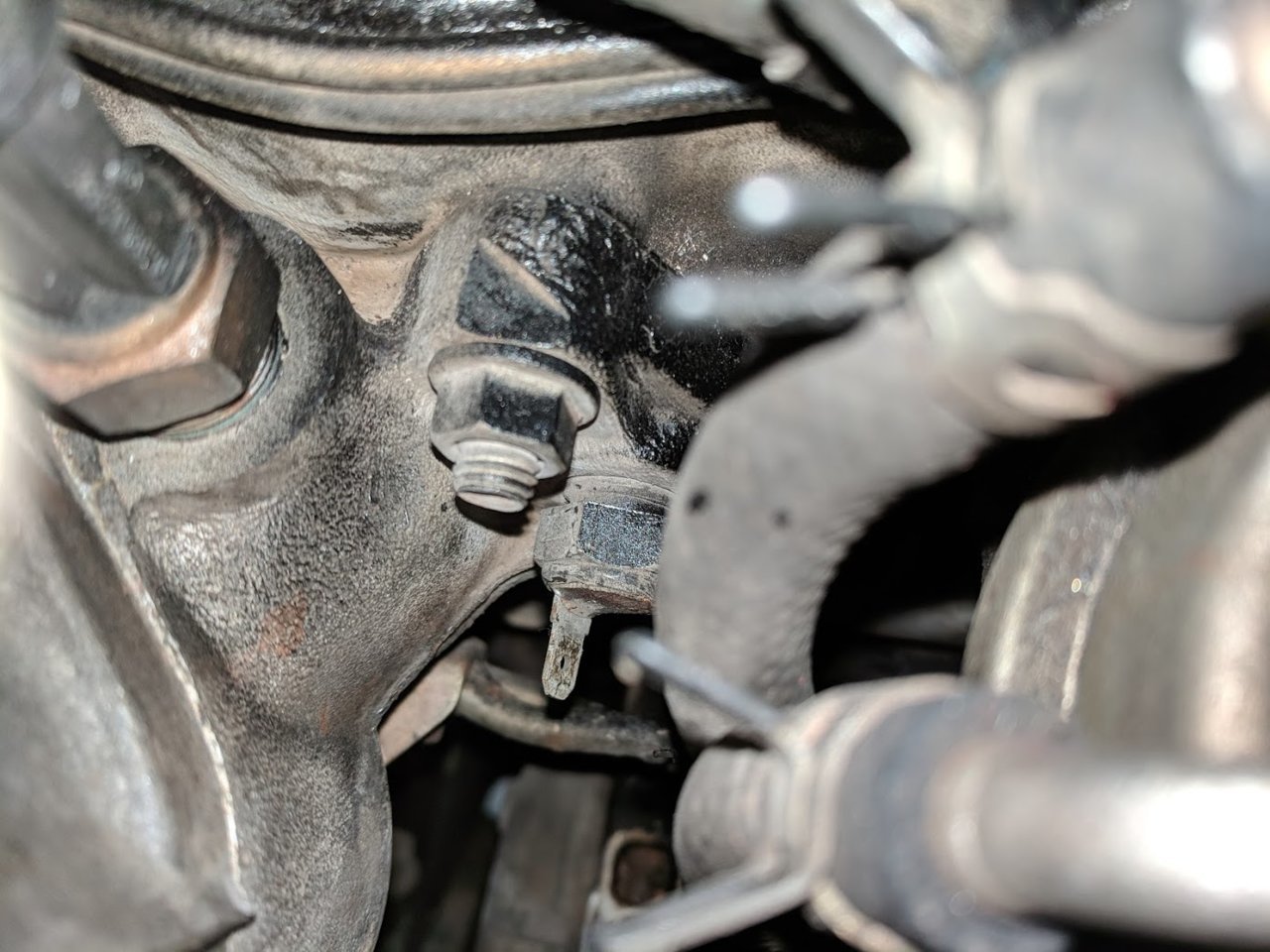

    Welp.. after poking around more last night, I found what I assume is the cause for the heater not working.
    I started looking into the heater core to do a flush and check the lines and even the check valve. When I traced the hoses back.. first thing I noticed was this kink..
    Then I started investigating the check valve itself. the mechanism was seized solid (stuck closed)... AND the cable from the temp lever inside the cab wasnt even connected. He must have just disconnected it and left the check valve/mechanism seized. :facepalm: I was having some trouble from time to time adjusting the hot/cold lever.. It felt like it was getting hung up.. well.. now I know why.
    I soaked the mechanism, valve, and cable in wd-40, re-attached cable, and worked the lever for a bit. all works flawlessly now.
    all thats left to do is replace the temp sender unit/switch.. which controls the gauge. this sensor with the spade connected on it. Going to snip the old terminal off, crimp on a new one, and install the new sensor.
    that should take care of all the coolant systems issues ive been having. Just need to tear it down again to re-seal the water pump, add this sensor, and bleed the system again now that I can run with the heater on.
