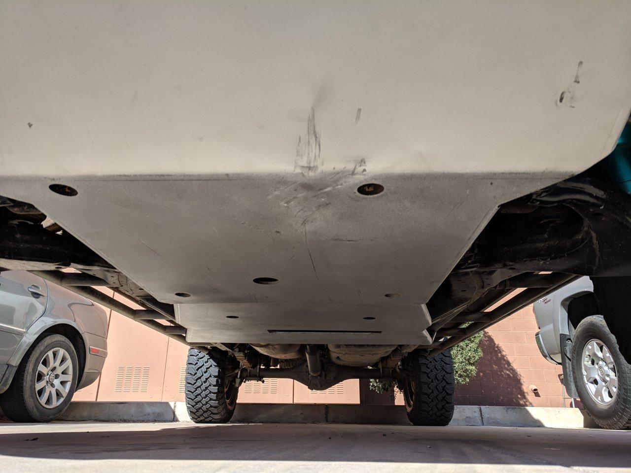

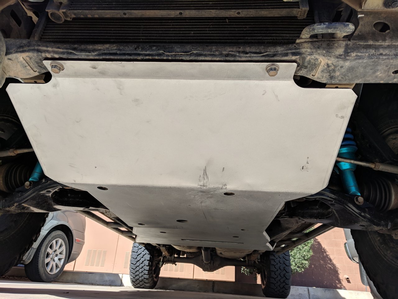

    Got the skids all cleaned up and installed... mostly. Just need to drill the (2) 17/32 holes in the frame for the T-case and wait till I run down the gas tank to get rid of some of the swell. Cut out the notch for the factory exhaust reroute and will fill it with plate to make it a flat bottom skid since I already have my exhaust tucked up for clearance.

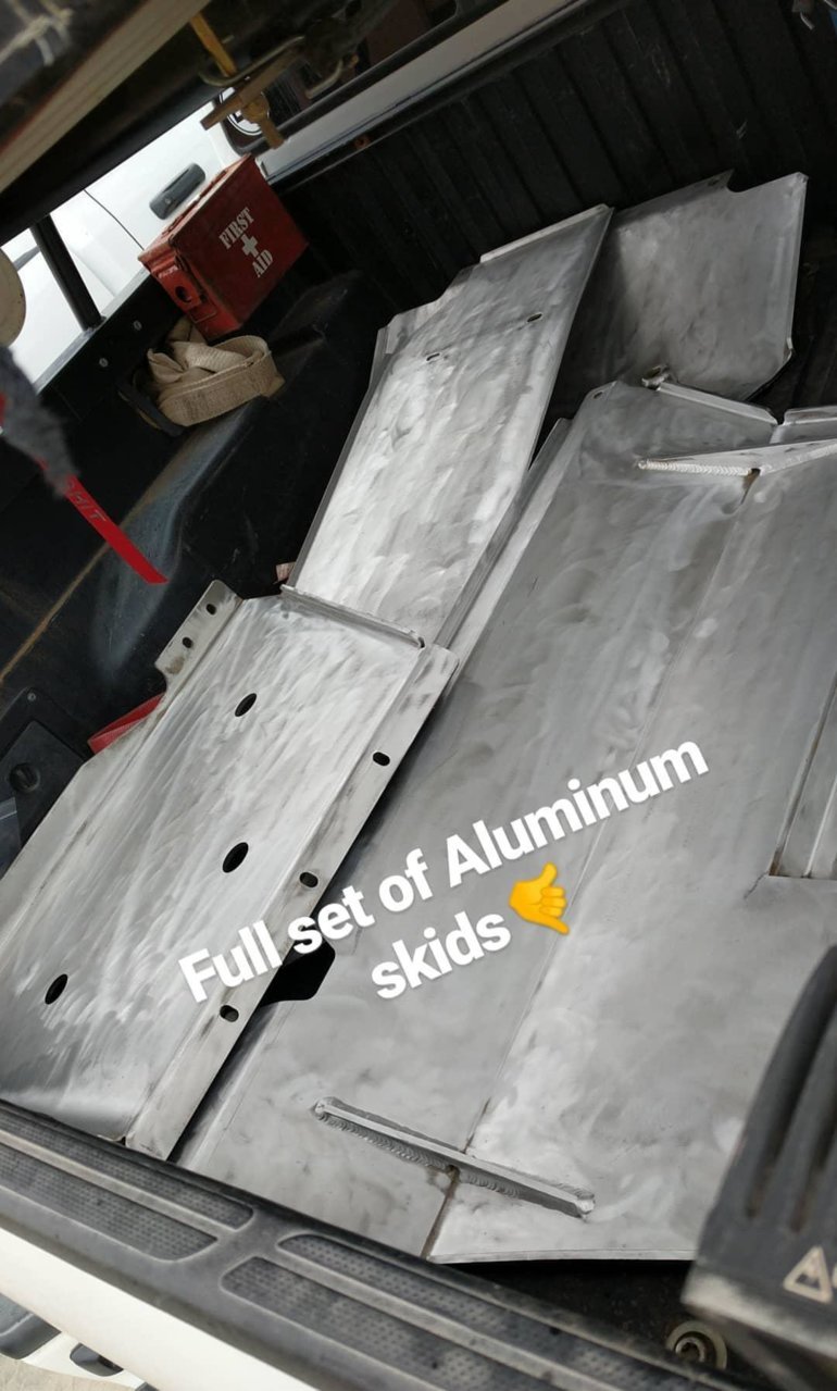

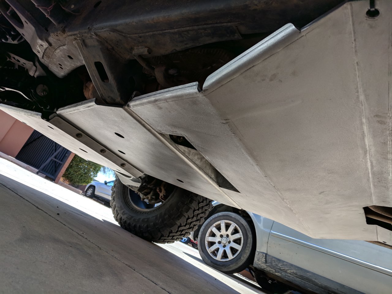

    Some shitty pics for now..
    Thanks @StOrMyThEtAcO again for the skids and breaking them in for me. Lol just had to massage the IFS skid a little with a mallet and force. Lol

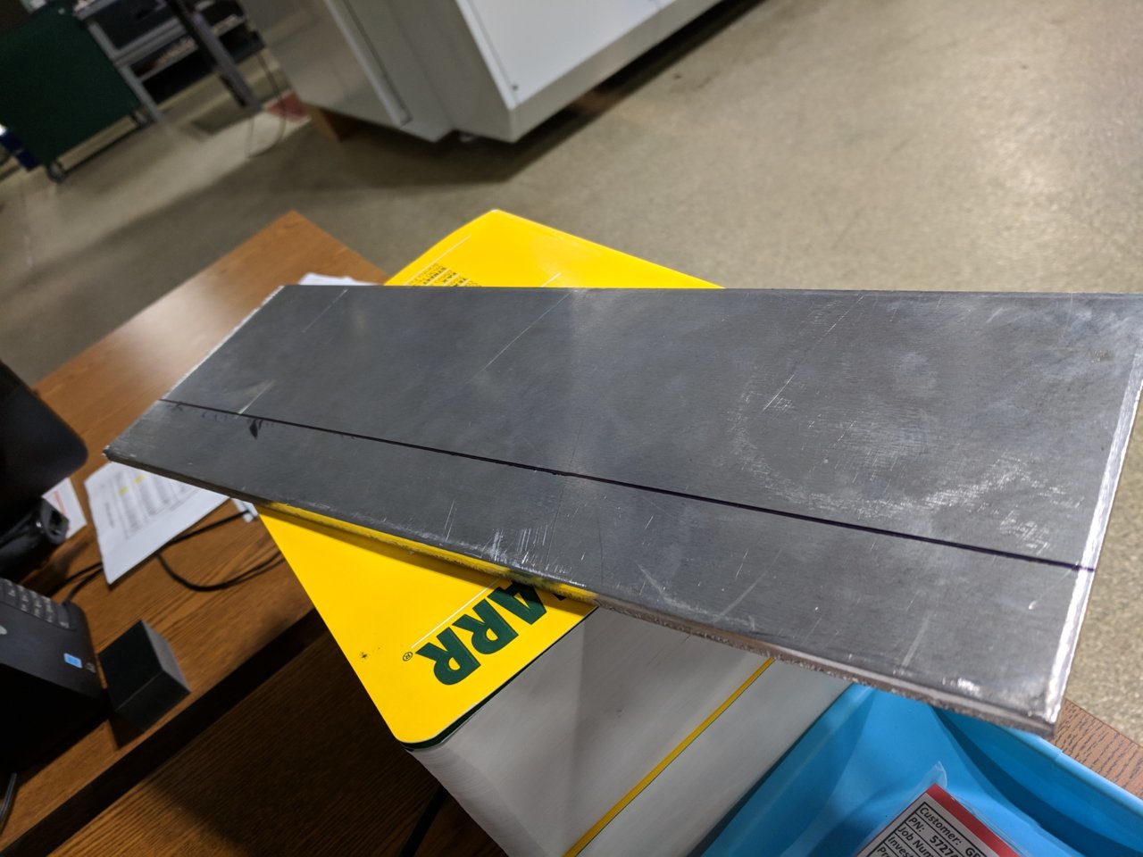

    Got my filler plate yesterday from AZ metals.

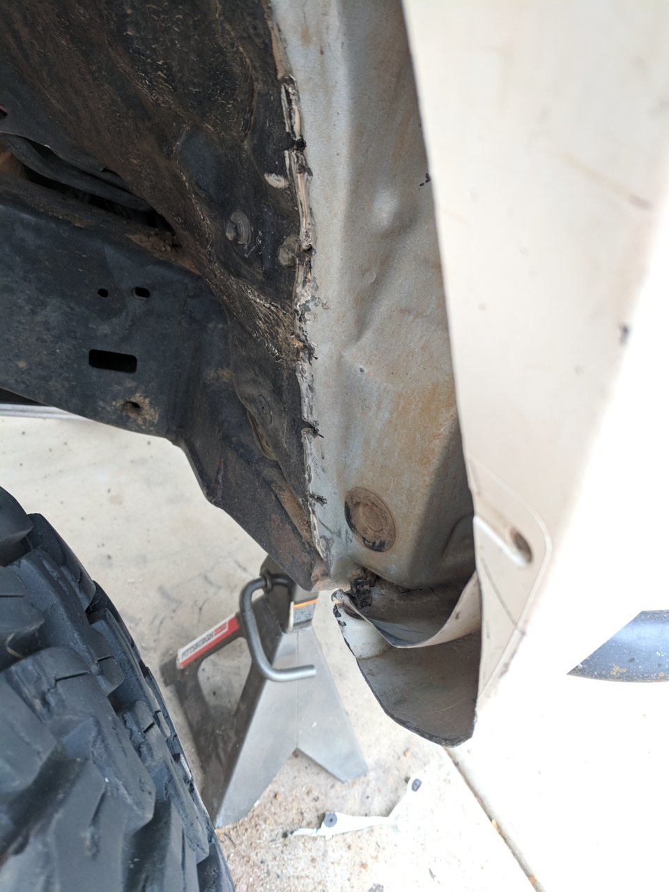

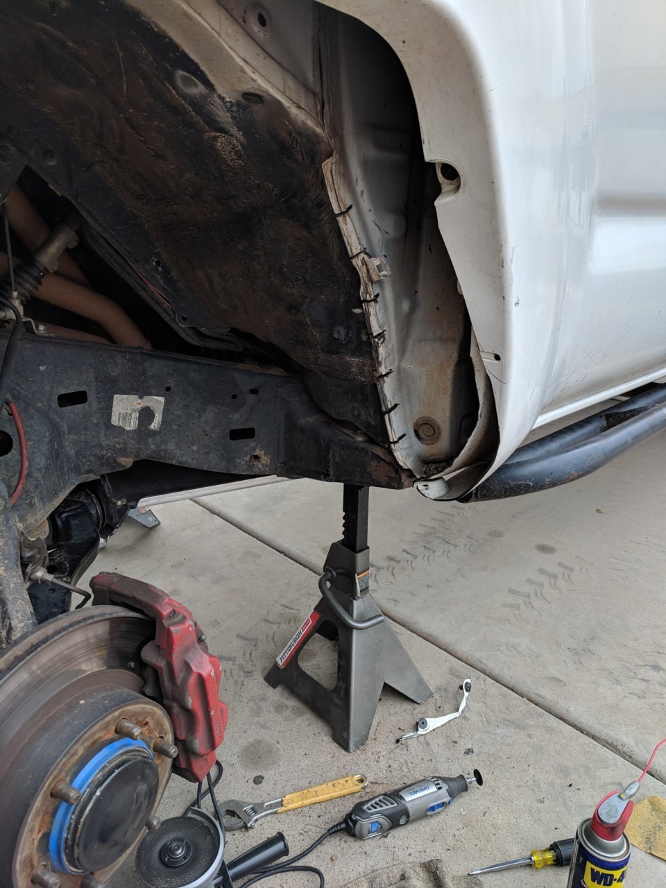

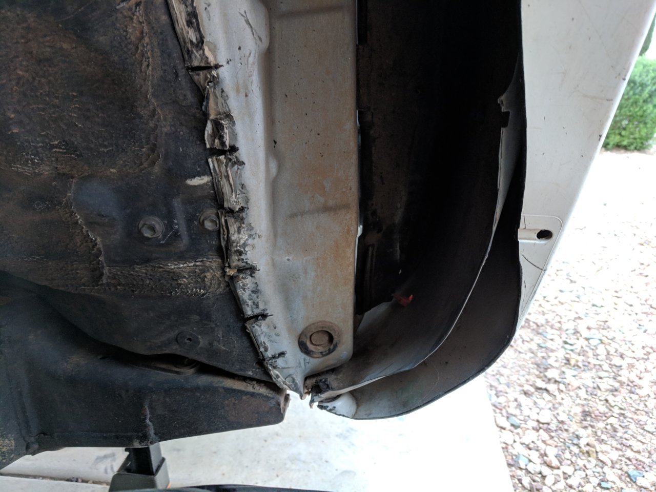

    Finally got to trimming my inner fenders and pinch weld. IDK why I waited so long to do it. super easy and room for days now. I notched the pinch weld with a cutoff then hammered it back. cut off more inner sheet metal fender and plastic fender as well. Got the gas tank skid mounted and started on the 2 rear bolts through the frame for the T-case. Got about halfway through one. Definitely need to get a better bit and or drill. The high speed steel bit I was using was brand new and started great.. then started burning up the bit even with being lubed.
    I also found some slop in my driver side UCA at the rear bushing/sleeve. The uniball seems to have some play as well. I assume both of these to be from the fender bender. Having the shop take the truck back in and take care of it.
