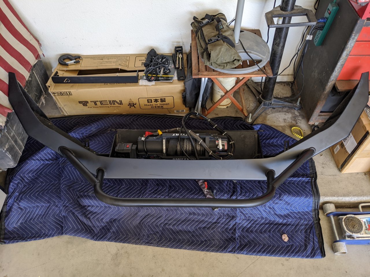

    Yesssssss. Thanks @AZBACKCOUNTRY
    Pelfreybilt single hoop in aluminum. Factor55 fairlead. Smittybilt x20 10k wireless synthetic winch.

    Can’t wait to see it on the Stormtrooper!

    Me either! Thanks again! It wasn't bad to unload myself either. Loving it
