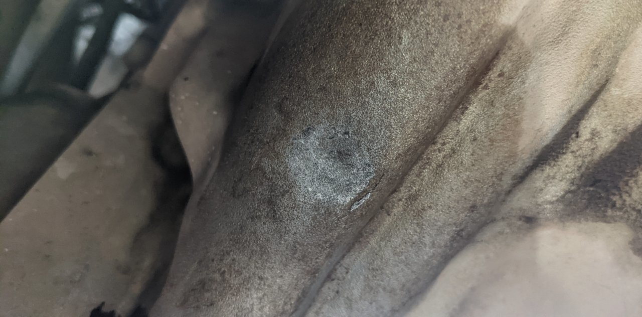

    Well... that escalated quickly. The truck still leaked after the shop re-sealed the oil pan so I took it back this morning. Apparently.. its the Upper pan.. what I was afraid of. They found a small crack from the front diff making contact due to worn out motor mounts. Quoted me 1200 for the repairs including a Toyota Upper pan. I'm going to make the switch to Solid mounts during this I think.. Wondering if I should do the Tranny mounts at the same time. I think I remember reading that both need to be solid.. @Torspd any insight? My concern is Solid Trans with my IPT valve body.. is it going to be too much shock with a solid mount?

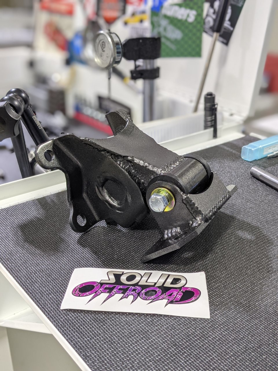

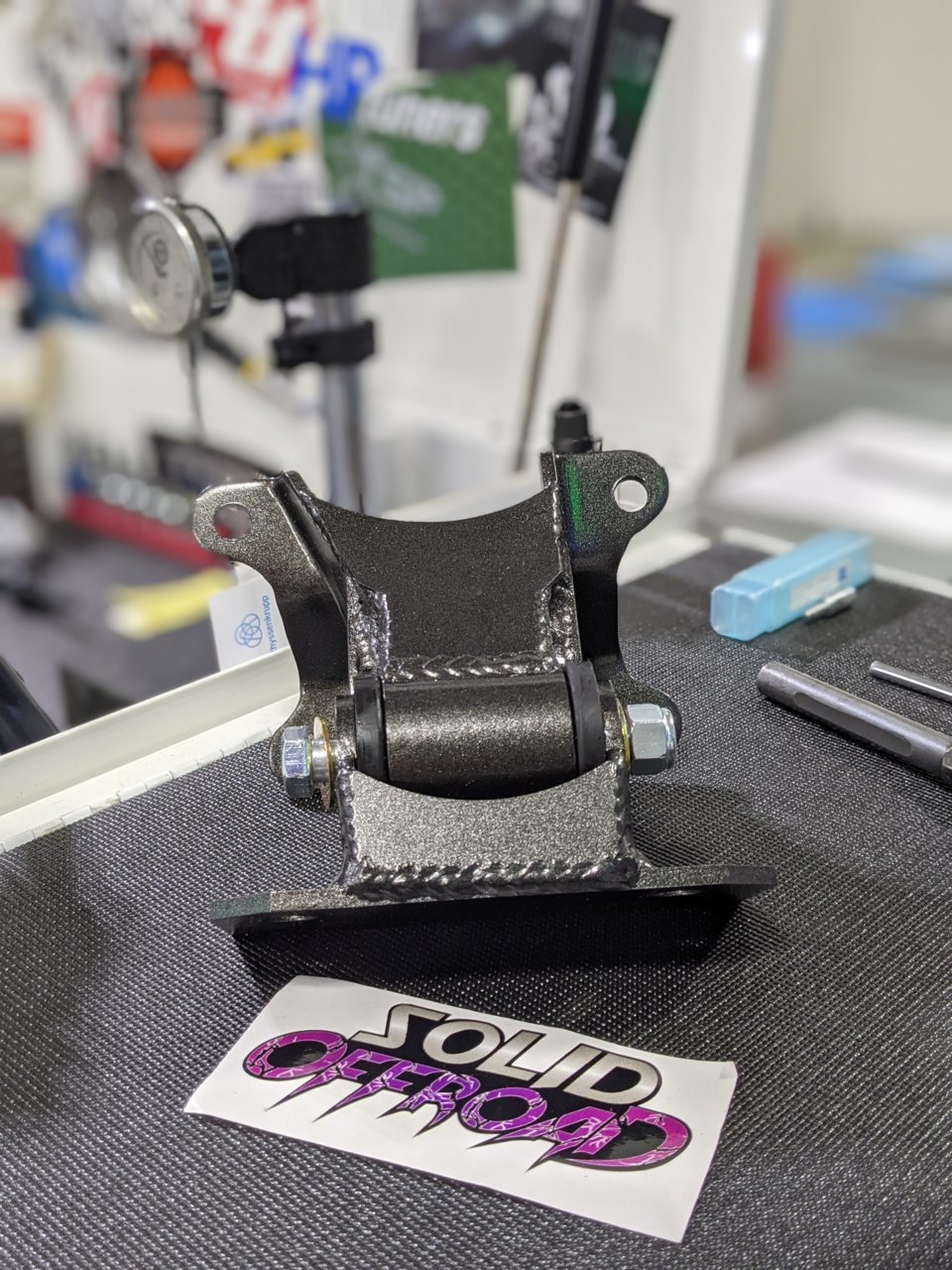

    More unplanned upgrades happening.. at least thats how I'm looking at it.. :rolleyes:
    Ordered some Solid Offroad solid motor mounts to hopefully stop this from happening again. Hopefully have the truck all back together the end of the week.

    Before even finishing reading this post, poly engine mounts came to mind. There are now three styles available, I believe. @Bonzen are mine, and the only that I have any experience with. Still profoundly proud of them. With an auto, and a soft trans mount, there will be extra vibes in the cab.
    You can do the engine mounts and wait on poly transmission mount. You cannot do the opposite.
    Being that you have an '09, you should not need the DMZ Fab engine mount gussets.
    The easiest manner that I can think of to fix your Upper oil pan, is IF the cracked area is accessible around the diff.
    You do have the option to drop the diff, while still attached to the hubs. Then access the oil pan. Still tricky with the steering rack. Grind a fairly deep groove then fill with TIG or MIG. Doing this however, a risk of aluminum shavings into the pan, is present. With only flushing by oil to remove. Prep by draining the oil obviously. The clean with acetone and preheat the crack with good quality heat gun on high.
    The longest method would be to take the pan off, and weld it on a bench.
    Time is what will dictate your choice of "field repair" or "shop repair."
    I'll upload a video from Welding Tips and Tricks. They use a two part spray to highlight how long the actual crack is.
    https://youtu.be/9VDCcAj7Nzw

    Here we go..
    Should get the truck back tomorrow.
