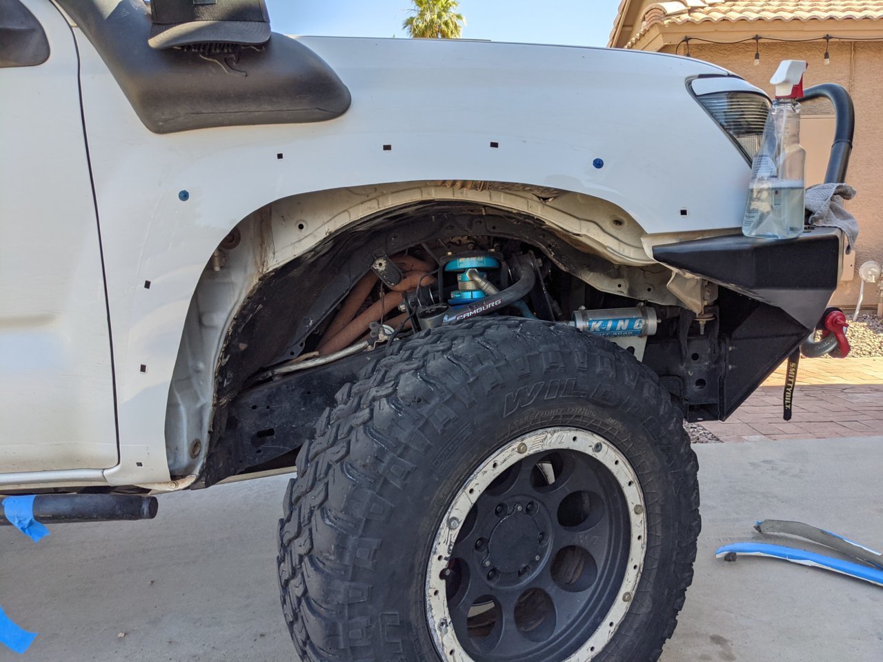

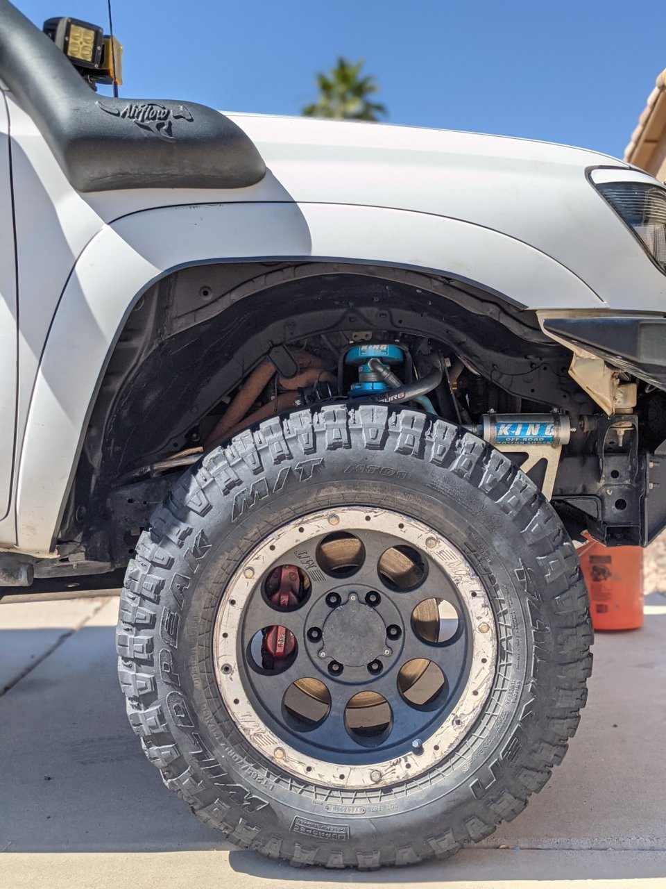

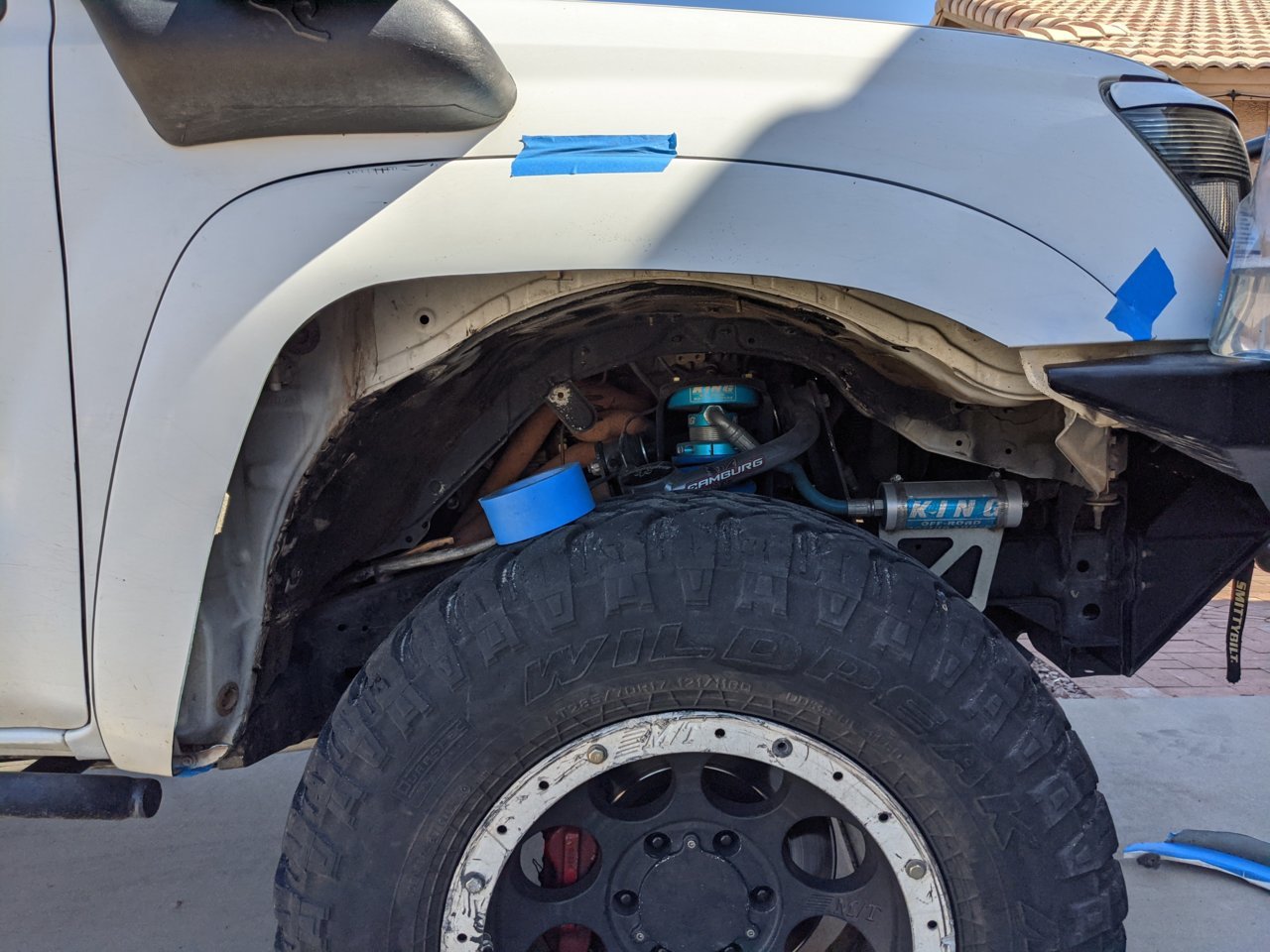

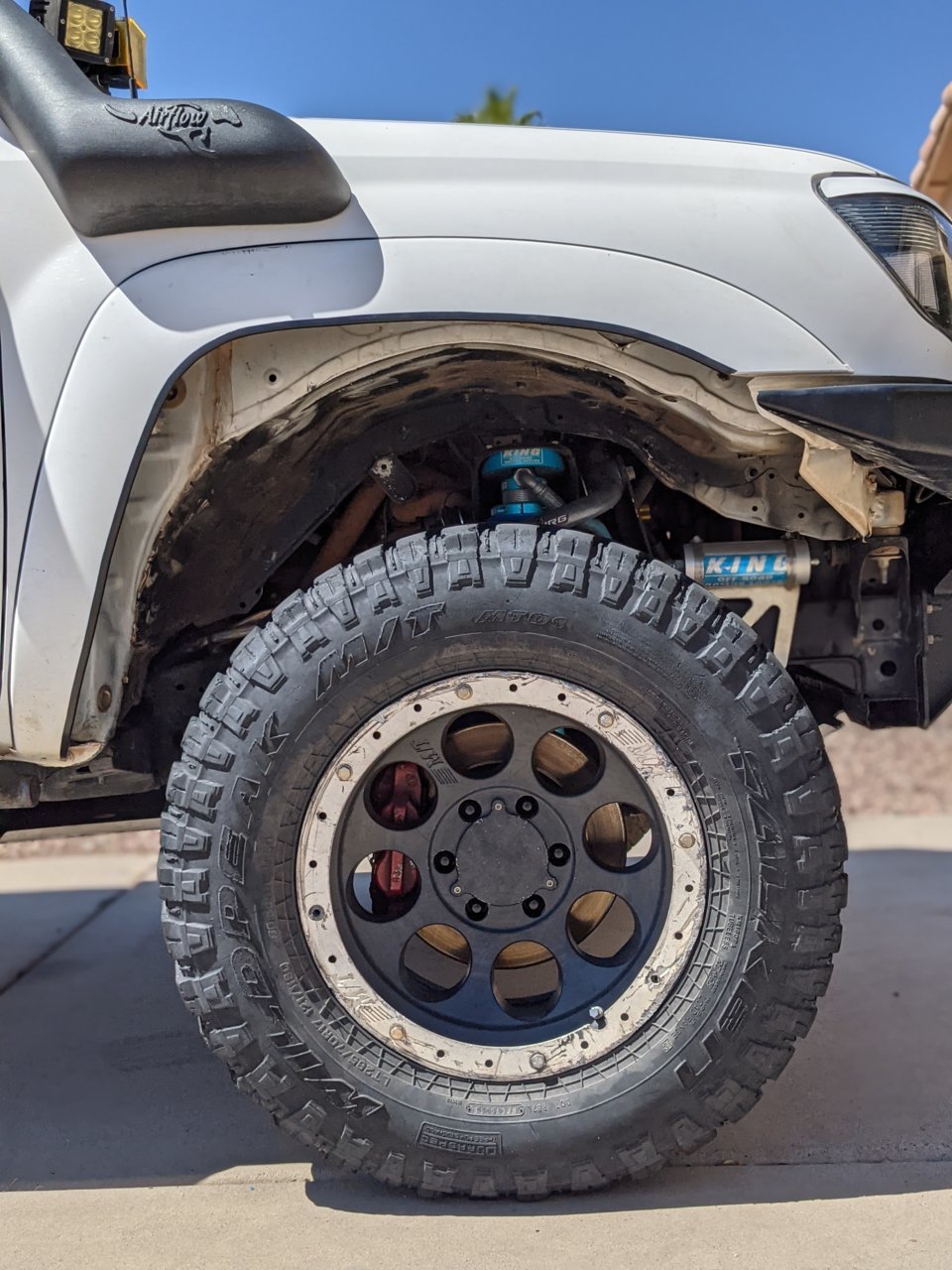

    Finished up trimming and painting the front fenders over the weekend. Need to find time to do the rears.. then maybe come up with some type of fender liner for both.

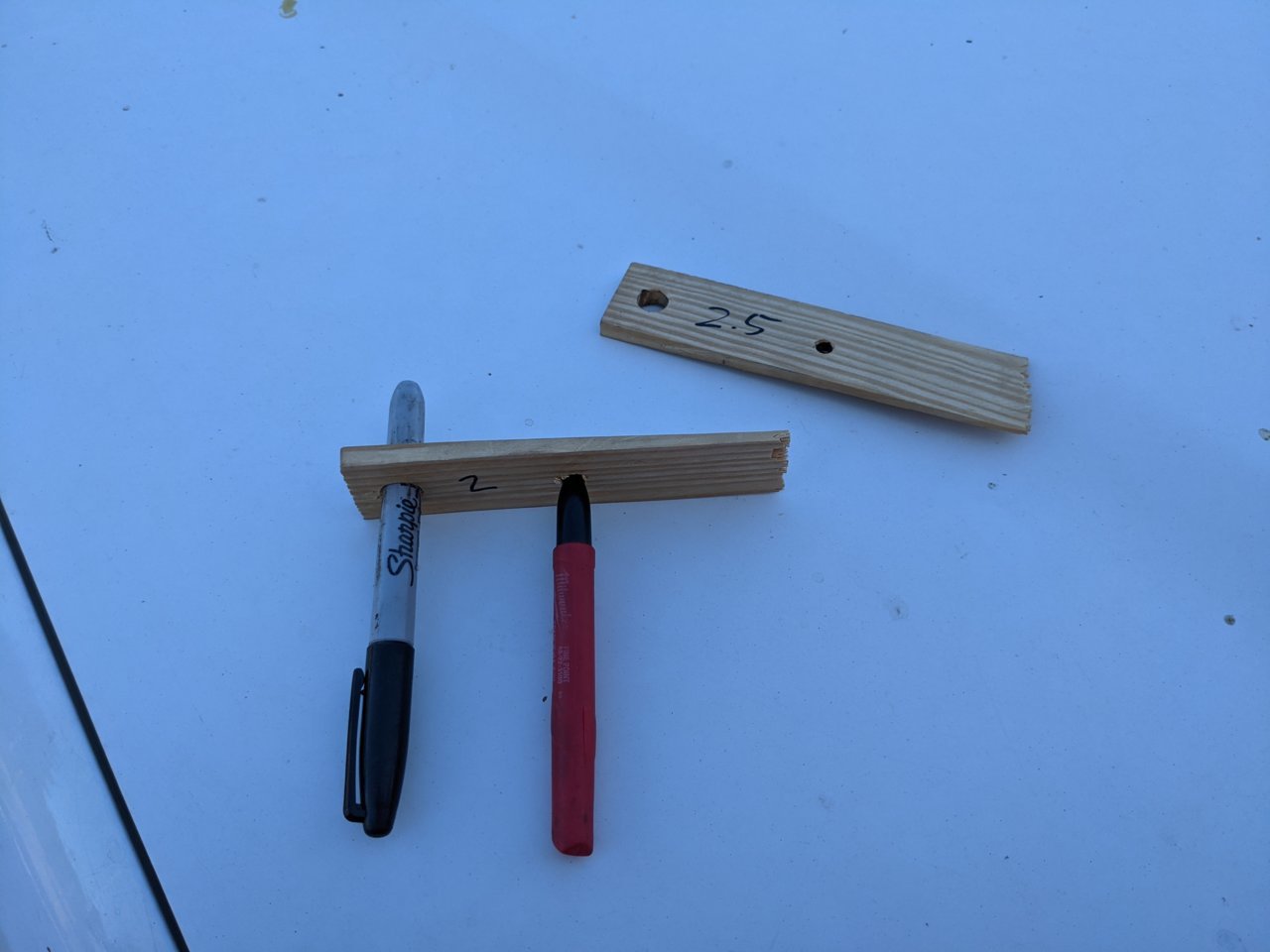

    Custom tools for 2.5" out of the sheet metal and 2" out of the flare. Used a fine tooth metal blade with the jigsaw for the main cuts, grinder to clean up, and Dremel to do the detail work.
    Reinstalled with new clips and added some edge trim to the flares..
    Then taped off everything really well and hit it all with Rust-Oleum Undercoat spray.

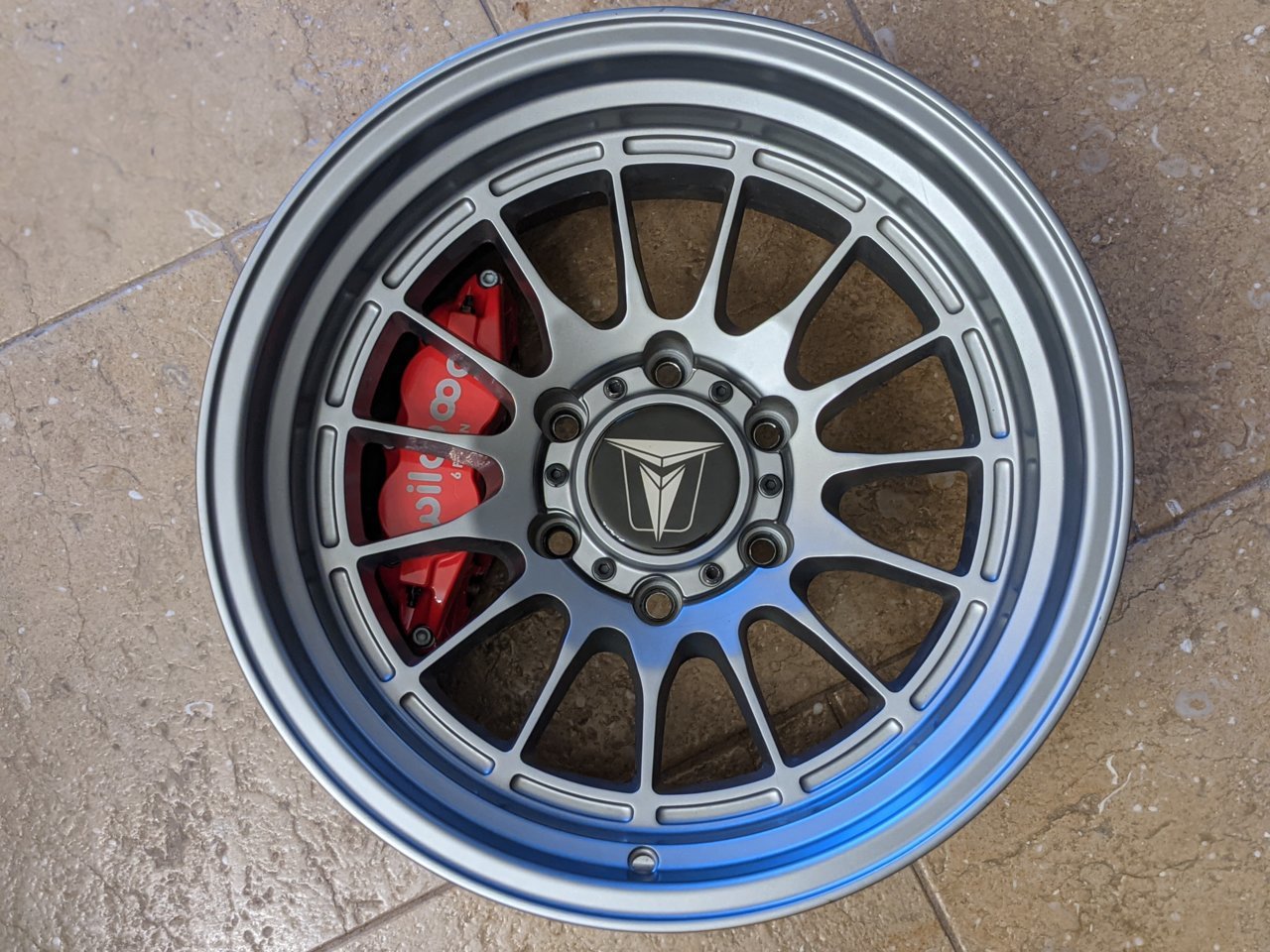

    Nom nom nom. I think this brake, wheel, tire combo is going to look killer! I cannot wait to get all this on the truck.

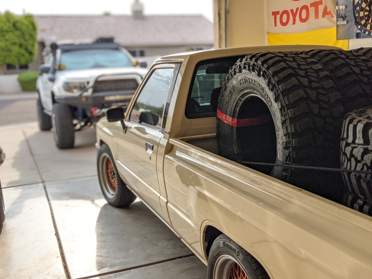

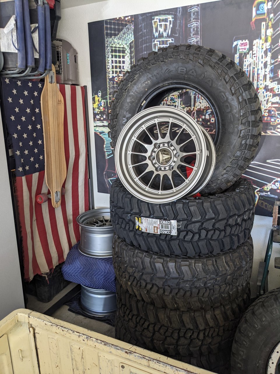

    Dropped off 4 tires and wheels. Waiting to mount the 5th until the matching spare gets here. Scored a Blemish Summit Dakar from them directly.. it's just Bronze.. so I'll rattle can it gunmetal and it should be a perfect spare wheel for my non perfect 5th tire.
    Hoping to get it on the ground and an alignment by the end of the weekend!

    Those will never clear the mini truck fenders
    XPOTRPR[QUOTED][OP] likes this.
