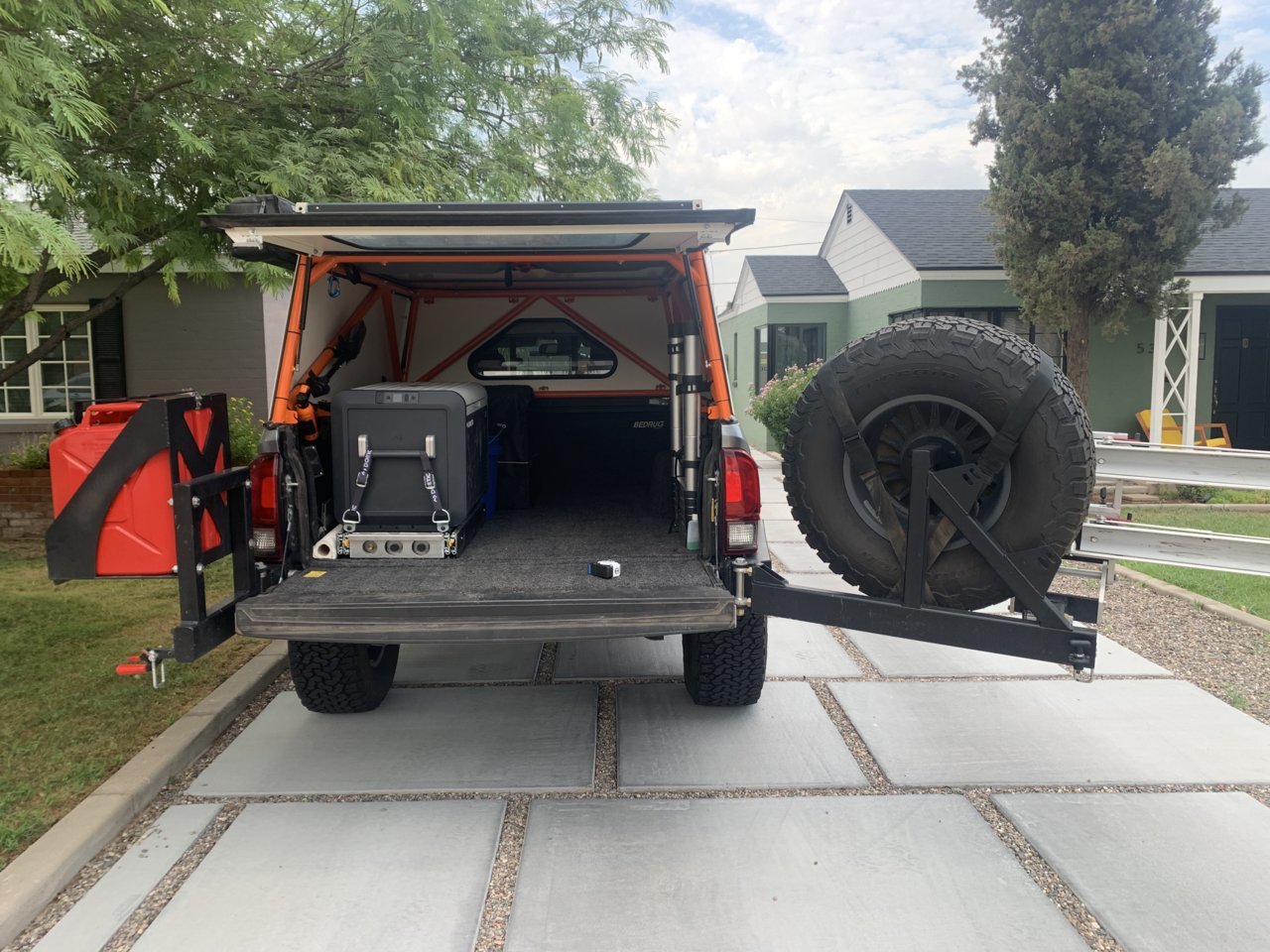

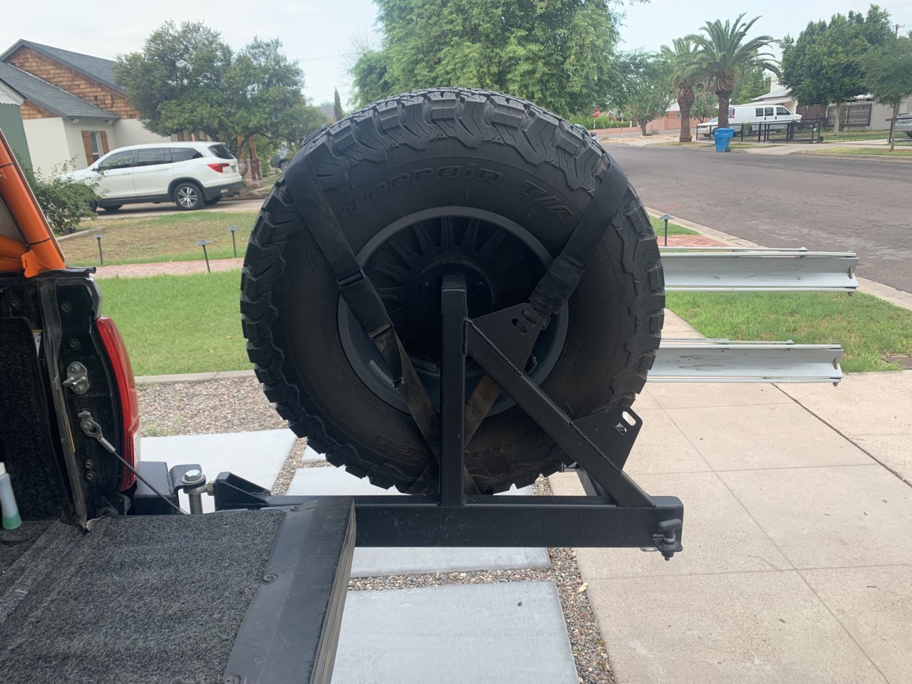

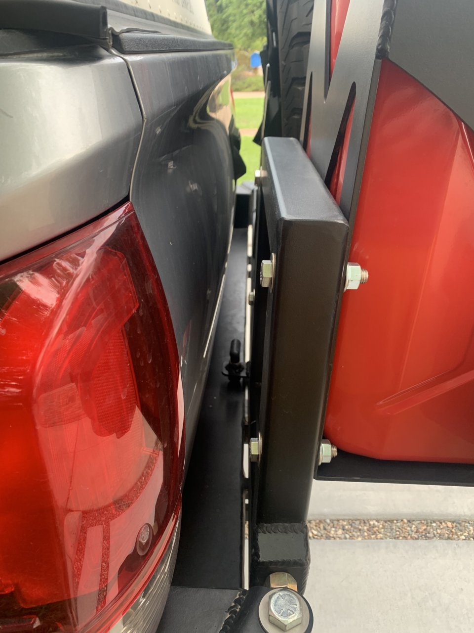

    2nd gen tailgates are pancake compared to 3rd gens, though Im not sure how the Coastal bumper sits comparatively. On a 3rd gen there is almost no room, especially with the backup camera. I need to relocate it because I cant see through the spare but its integrated into the tailgate handle so I wont be "removing" it, just adding a new camera somewhere else.
    Here are some pics to show there is less than 1" between the swing and the camera but there is about 2" between the actual metal of the tailgate and upright of the tire swing.
    In the second picture you can see how thick the tailgate is. 5" to be exact, I think a 2nd gen is 2" or less. A 3rd gen tailgate curves and bows towards the rear. This is much less pronounced on a 2nd gen but that still doesnt tell us if the swings sit farther from the tailgate or if they still tuck up close. Youll want these pics from someone with a 2nd gen.
    In the second and third pics you can see how much room there is on the swing to attach a table. With the swing open to exactly 90 degrees so the tailgate can just barely open, there is 22" of usable space. When the swing is open all the way there is 32" of usable space. One of the downsides of this bumper is no latch to hold it open so keep that in mind when choosing camp spots, you want to be as level as possible. I plan to use the 22" number and figure out an easy hinge/cable/latch setup for my HDPE slab. Its lower on my to-do list though so might be a bit before I get it done.

    More room than I remember. Thanks for checking. I’d guess you’ll have about 1” more room @XPOTRPR from the tailgate thickness and curvature

    I'll have to sit down and respond. Thanks for the pics @Atl-atl. I also can and plan on relocating the camera. I think the biggest thing is coming up with a "frame" for it. I saved those pics you just posted so I can draw on them later. Thinking some 1" square tubing for uprights and a top horizontal bar on the tire side.

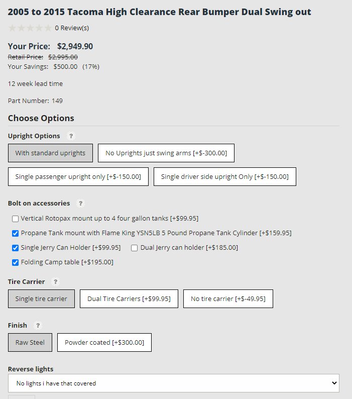

    I do like the BAMF Dual swing out... lookin at them now. priced it out...
    3k... double what my Coastal was. and thats not even painted or PC'd. BUT.. I do like their swingouts and design... hmmm...

    Yeah thats what I am saying. For the coastal priced out I am at 1450 each so I could buy one for each vehicle for the price of one BAMF. But it is damn sexy!
