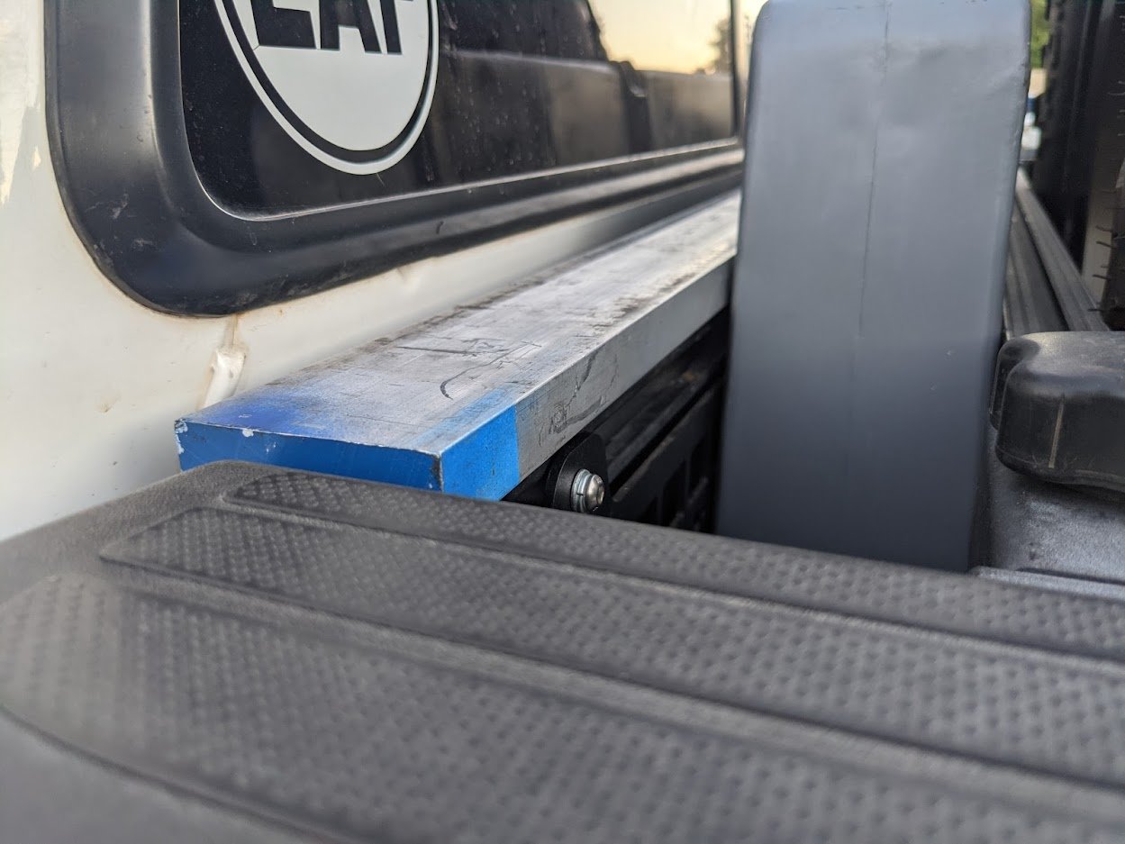

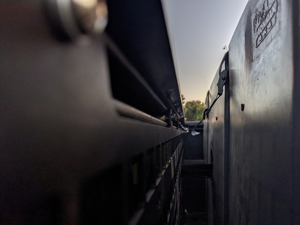

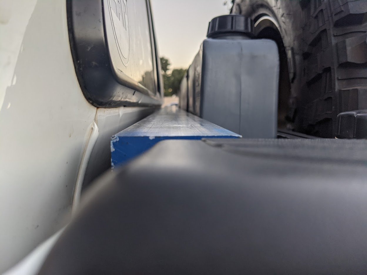

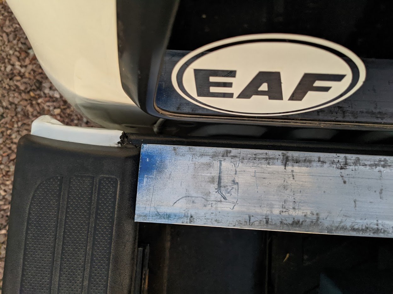

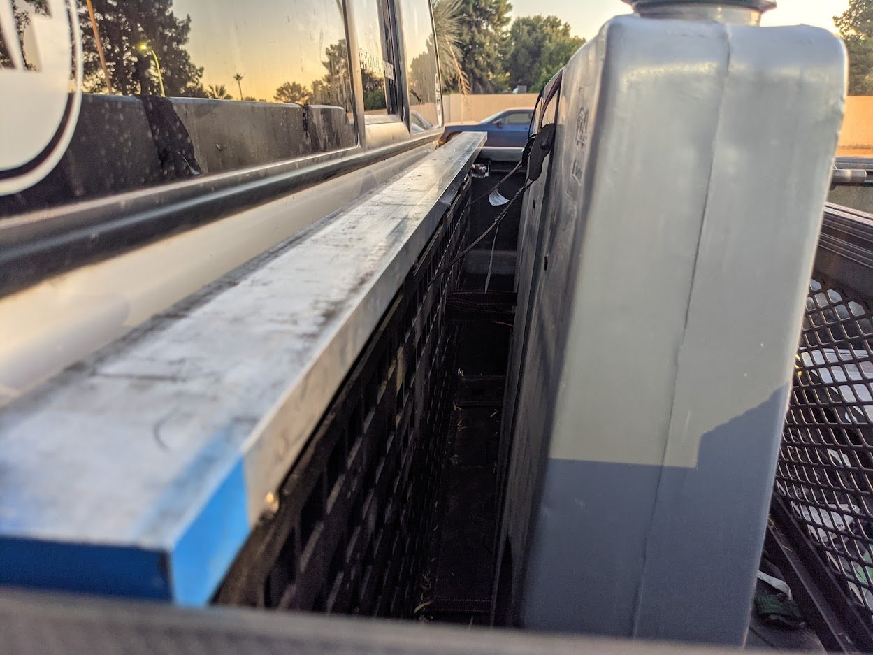

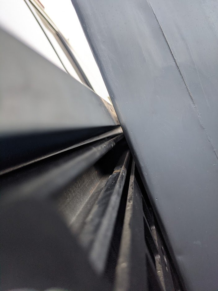

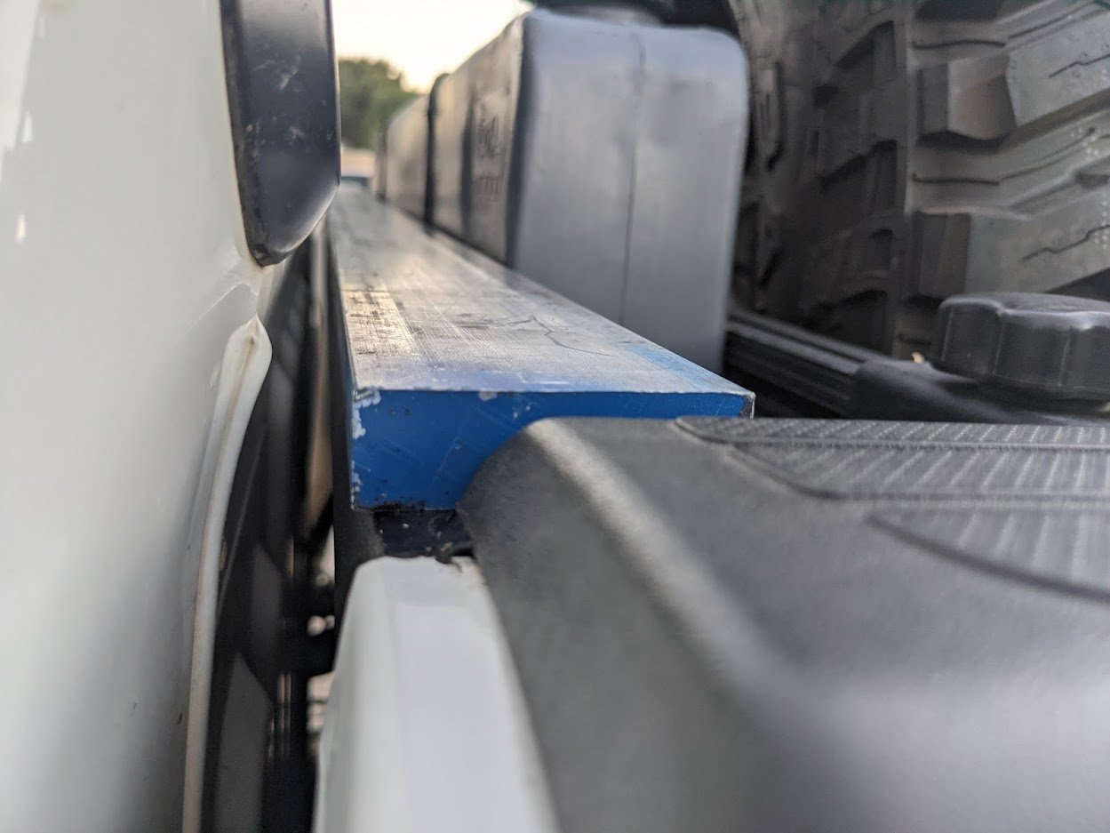

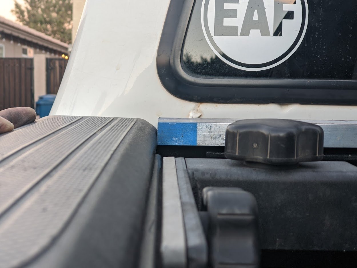

    Alright, found my stick of 6061. Going to cut it to length tomorrow and start playing with it more. So far.. I think it might work out pretty well. My biggest hurdle is going to be figuring out my water tank honestly. I'll need to space it at least another 5/8" off the Molle Panel that's 1/8" thick for a total of 3/4" spaced from the T slot. I'm glad I found this out now though and not up there. I'll get some stock and work or cut some 2x4's up, space it, then strap it back up. That should make enough room for this bar idea and the X1 tab.
    Ended up going with 3/4 x 2-1/2" bar. Its over 6 foot long though and hanging off the truck, so its slightly angled when trying to lay it down to fit.
    Where it sits with the water tank as is.
    Here you can see the ~1/8" gap between the T slot and bed height. It only protrudes 1/4" with the water tank in place as is. I plan to fill that gap with another piece of 1/8" x 3/4" or 1" aluminum flat stock. It will be sandwiched between the top bar and T slot and the bolts ran through it all with nuts inside the T slot.
    This is where it "needs" to sit. per our measurements and thinking. 3/4" off the T slot.
    Shifting that bar towards the rear to get the 3/4" overhang overall from T slot for the X1 tab to locate on, leaves 1" to mount to the T slot and 3/4" of contact on the top of the bed (total of 2-1/2"). I figured between the bolts (thinking 6) and some 3M tape and or Butyl Tape underneath and in key areas will really stick this thing down and seal it up nicely.

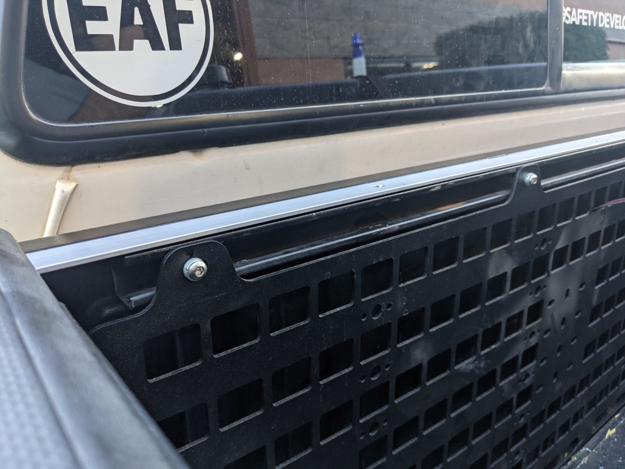

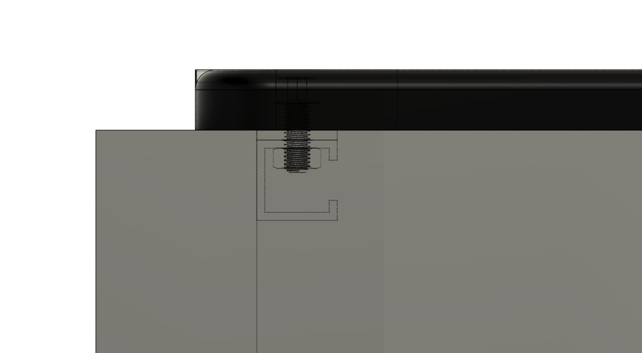

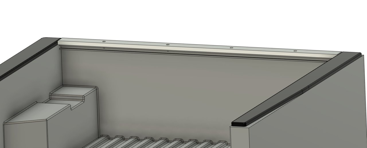

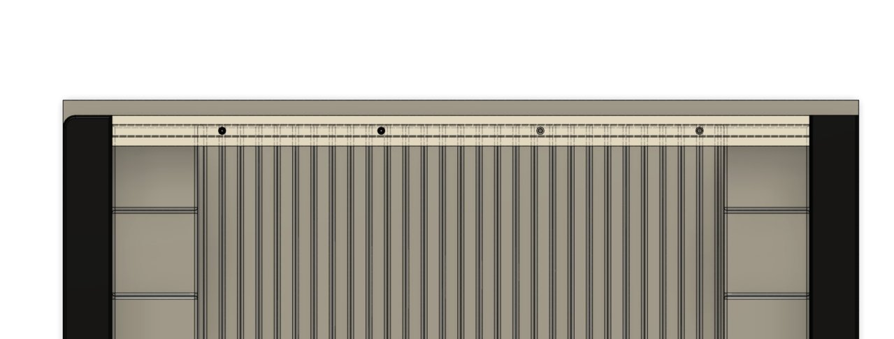

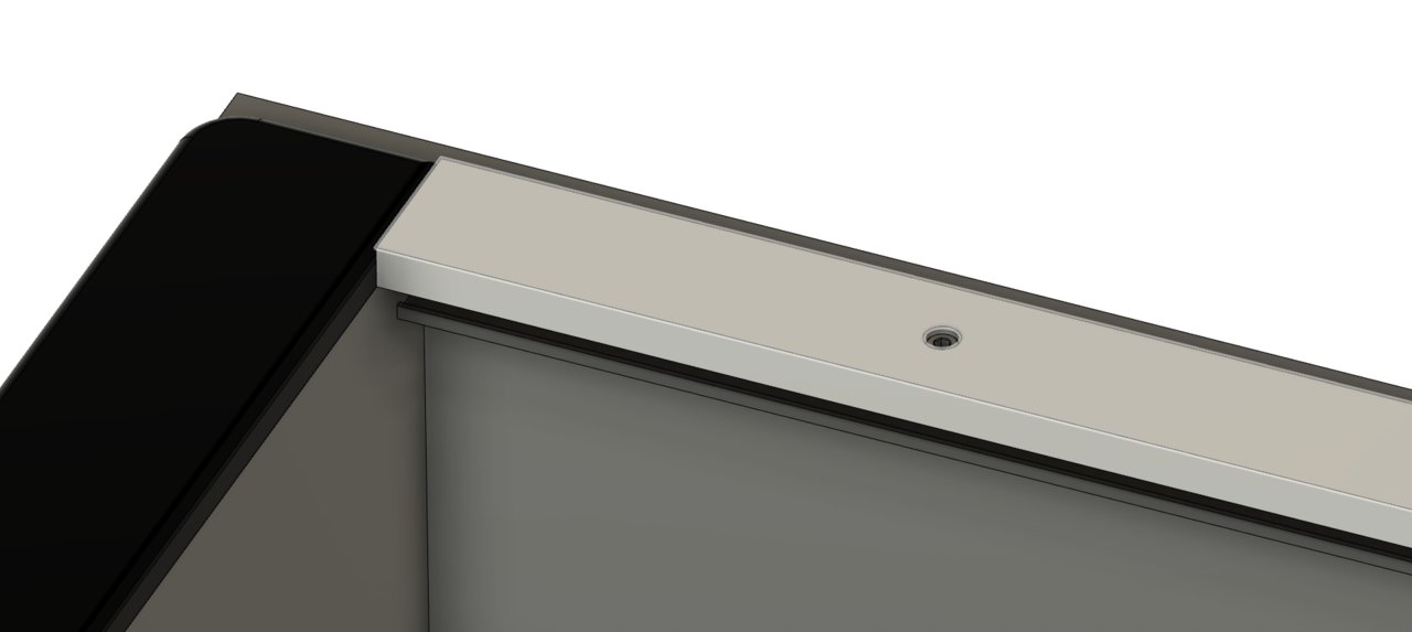

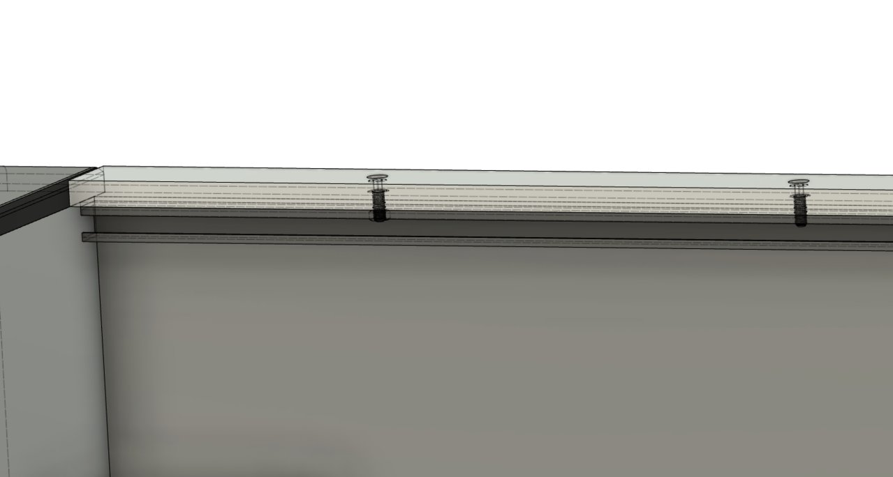

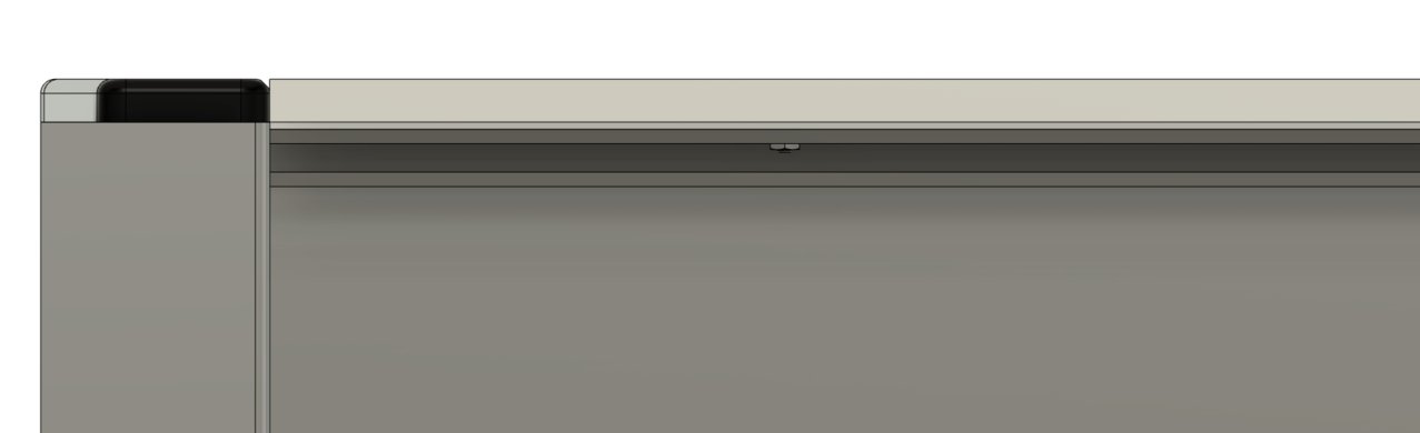

    SO here's what I'm thinking. I think I'm just going to make it and see what happens. If its an issue, it can easily be unbolted and we're back to square one. I'm hoping this will make it like a 3rd gen and they can just adapt that to mine. IDK..
    4x M8 x 1.25 Socket head screws by 22MM long. With appropriate hardware.
    and there's my problem.. lol Just need to space it..
    Spaced out and a little extra for the X1 tab. I'll just go 1" spacing from the Molle panel and should be good.
    Slashaar and Torspd like this.

    Are there available unstructured nuts, or "extended"/tall nuts? Getting a wrench or tool on the regular height nuts may be a challenge.
  17. Nov 16, 2021 at 7:39 AM
    #9897
    XPOTRPR
    XPOTRPR [OP] CNC Programmer/Machinist
    May 29, 2011
    #57449
    31,177
    Josh
    Chandler, AZ
    > BUILD LINKS >
    I thought about that.. But I think it'll clear.. just gotta angle the wrench a bit vs going straight into the T slot.

    Strong wing nuts may also be a choice to consider, should you encounter an issue.
    XPOTRPR[OP] likes this.
  19. Nov 16, 2021 at 8:42 AM
    #9899
    XPOTRPR
    May 29, 2011
    #57449
    31,177
    Josh
    Chandler, AZ
    > BUILD LINKS >
    Ahh true. Good idea.

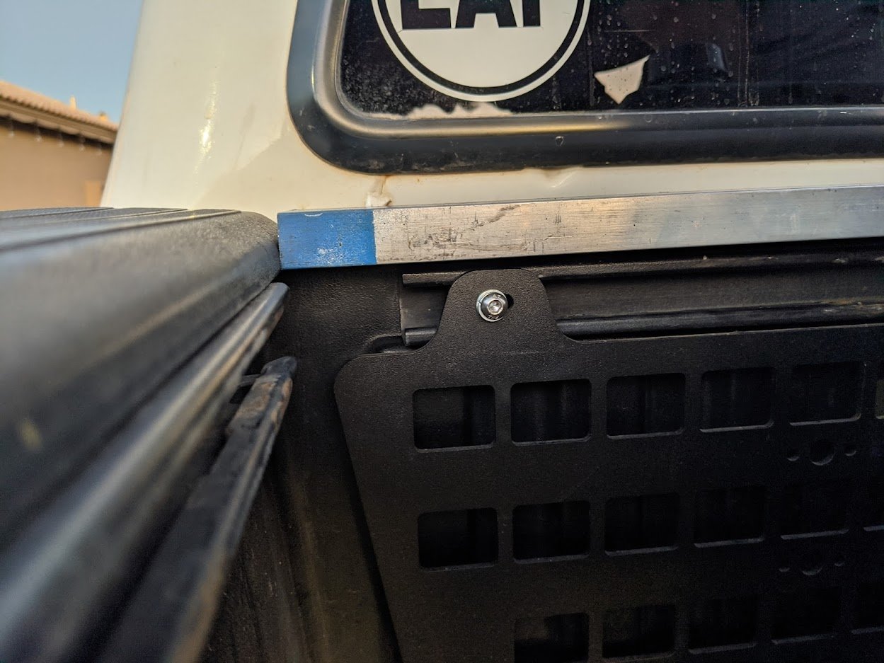

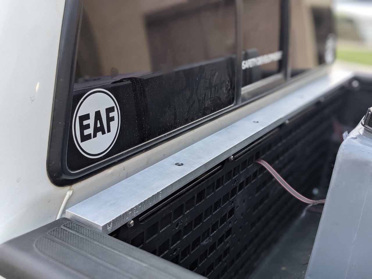

    Got some time to kill before our install today.. guess I'll make a little update.
    Finished the front bed filler thing.. hopefully it works without issue with the camper. Luckily it is easily removable if not.
    1/8" x 1" flat stock fills the gap between bed and T Slot rail.
    Secured the top bar with x4 M8 x 1.25 Socket heads.
