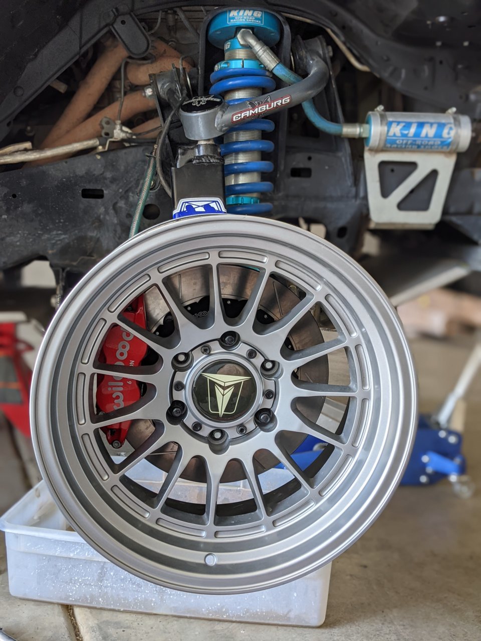

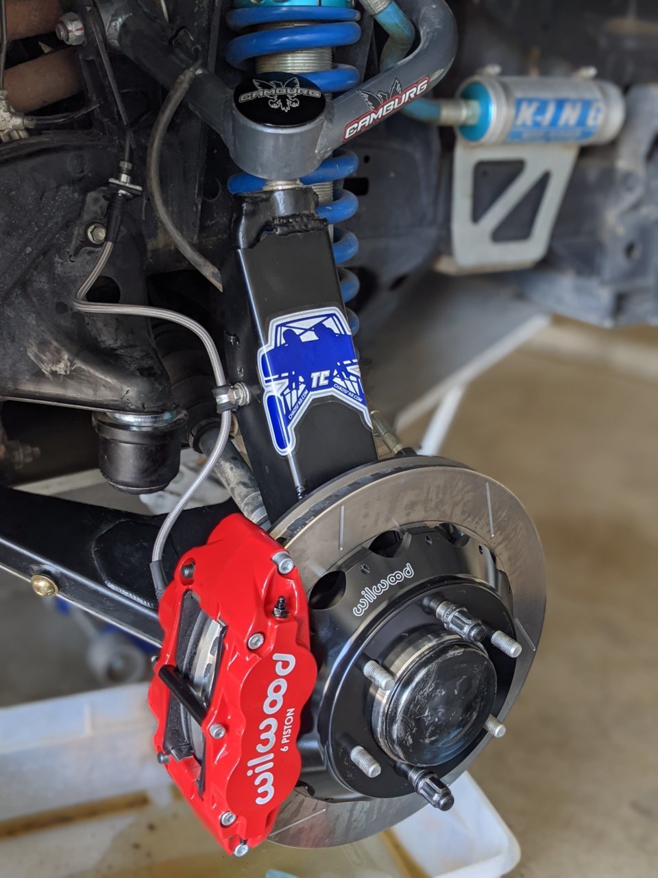

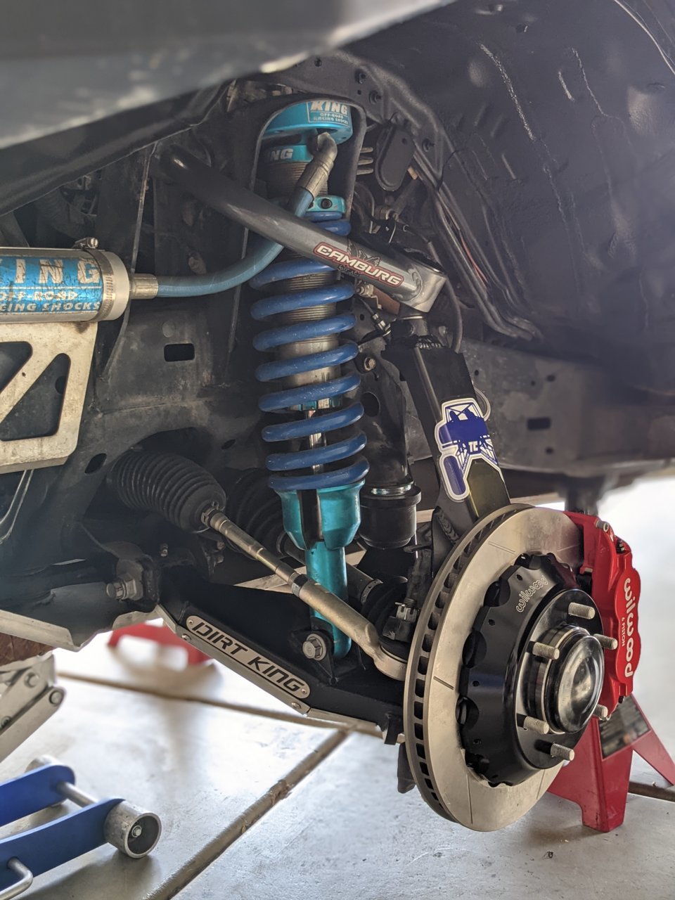

    How’s the brakes for you? After I heim my front steering and install the spindle reinforcements I have had for a year now; I’m looking at upgrading the master cylinder to a Tundra swap kit and Willwood brakes. I saw you went with the 140-14577 kit, I’ve been looking at the 140-14578 kit that is a little over a half inch larger rotor. They say you need 18 inch rims to fit that brake kit and that’s what’s holding me back, I’d rather have more tire than rim for actual desert racing once I go 35s.
    I wish the smaller kit was more than just .28 inches above stock. The larger Willwood kit is .58 inches larger than the smaller one and .86 inches larger than stock. I feel like they could’ve split the difference a little better.
  12. Dec 25, 2021 at 2:36 AM
    #9952
    XPOTRPR
    XPOTRPR [OP] CNC Programmer/Machinist
    May 29, 2011
    #57449
    31,177
    Josh
    Chandler, AZ
    > BUILD LINKS >
    They've been awesome. I have a little review about them on the previous page actually. Yeah, I personally wouldn't run 18's.. that's just me. Even with the "smaller" kit.. it's still larger than OEM.. but you're also gaining an extra piston on the caliper.. shedding weight on the entire setup, etc.

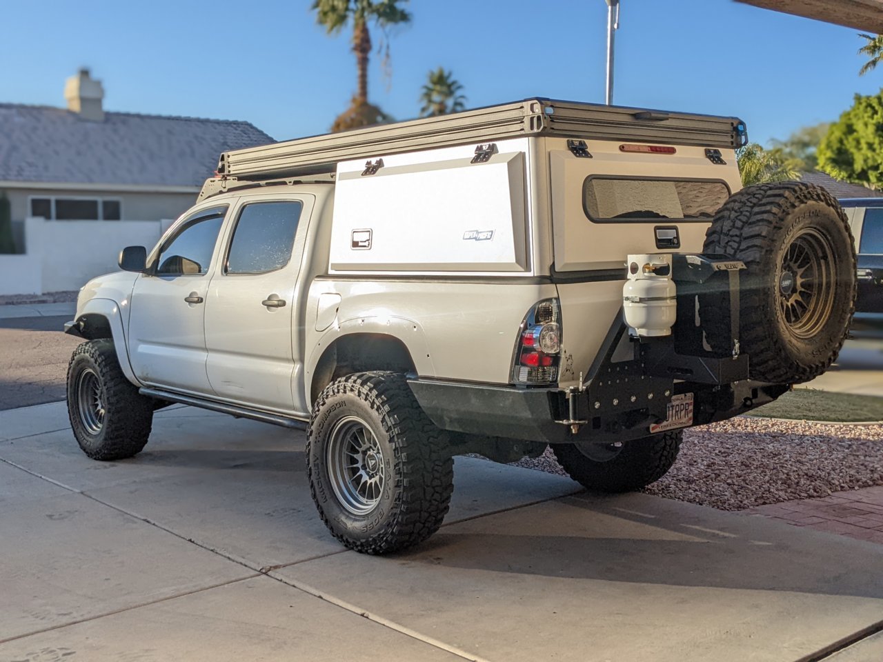

    > BUILD LINKS >
    Almost got the bumper 100% finished up. Need to add one more table. Swapped in new tail lights and wired up the 3rd brake light as well. Did some organizing and cleaned up the inside some now that everything is out. Scheduled my appointment for leaf re-arch for the 21st. Until then it sits.
  20. Jan 17, 2022 at 8:52 AM
    #9960
    XPOTRPR
    May 29, 2011
    #57449
    31,177
    Josh
    Chandler, AZ
    > BUILD LINKS >
    Finished up the rear bumper accessories and tables. Got my Wavian Jerry Can fitted and the propane fully mounted. Then made a quick little latch pull with some Paracord, ran up to the swing out and through the spare.. then added an old Winch line pull for a pull handle. A quick pull and it unlatches.. vs trying to fit between the tailgate and flip down table to get the the latch.
    Also, I wired up a Blue Sea 12v plug with some length of wire to use it with our power pack for the time being for 12v water. Wanted to test it all out as well before committing to a mounting location, hose runs, etc. Should work great for KOH in a couple weeks. Hoping to run a little section of hose to the swing out for a camp sink/shower.
