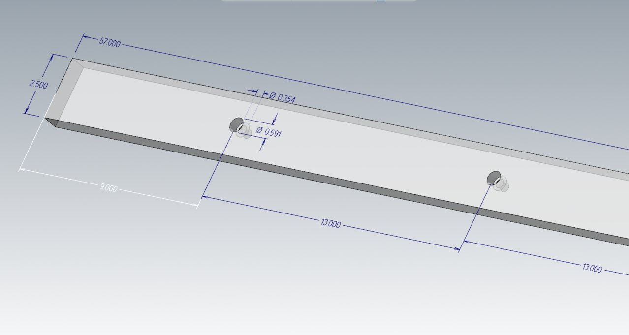

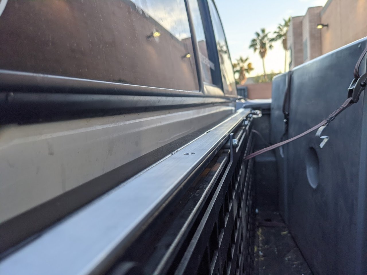

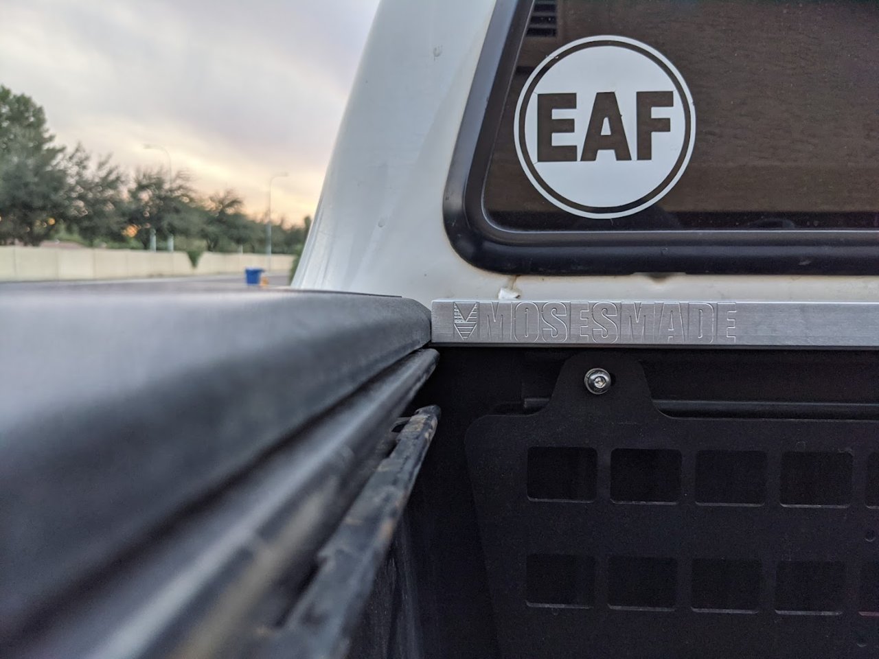

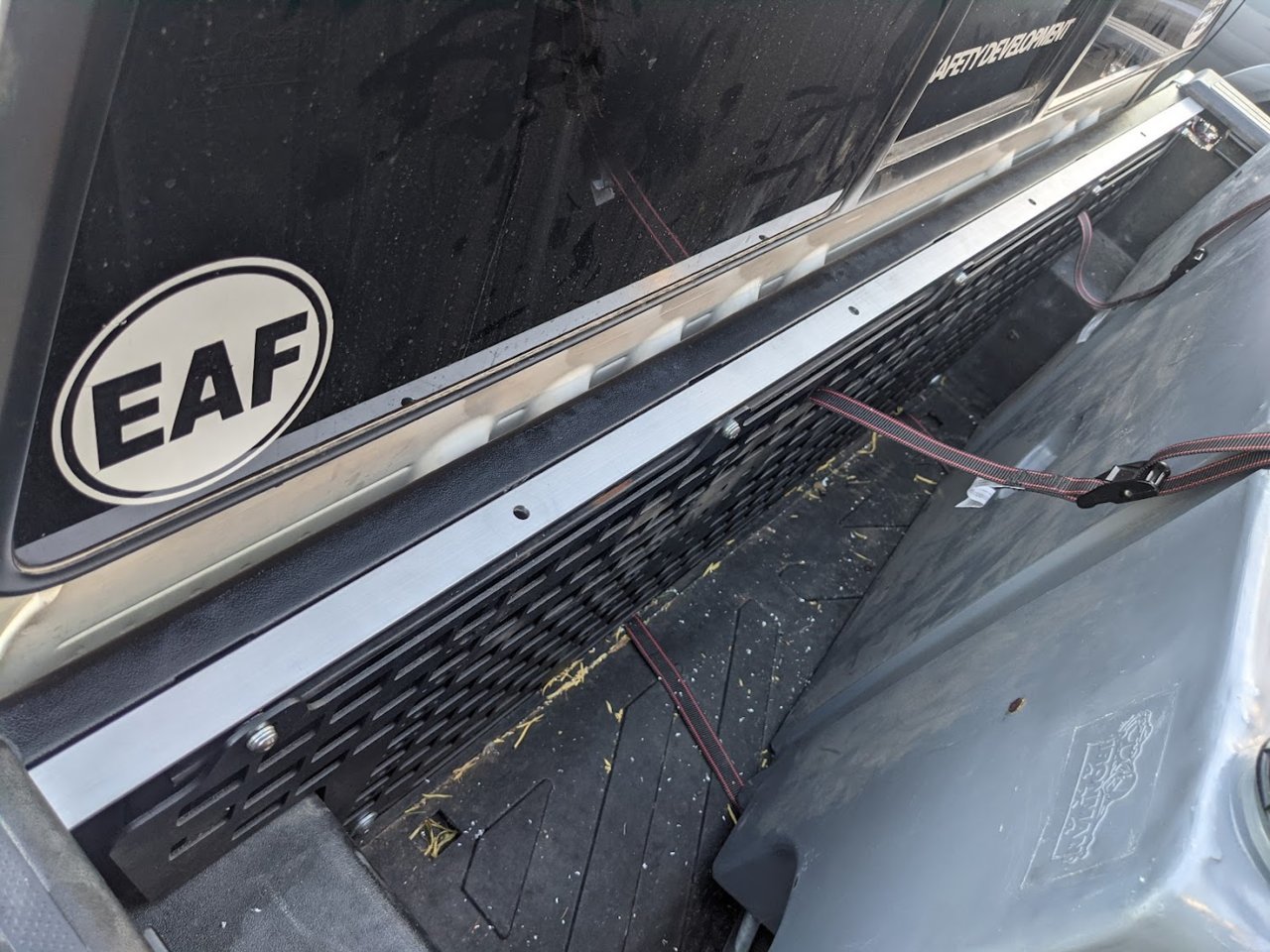

    @nudavinci64 Here's some Dims for the front bar I made. Its 57" long, by 2.5" wide, by 3/4" thick bar. Thru holes are .354" and Cbores are .591" by .415" deep. I also used a piece of 1" wide by 1/8" thick aluminum flat stock underneath.. center of the holes.. to fill the slight gap between bed and t slot. This thin piece will also need the same thru holes and spacing put into it.
