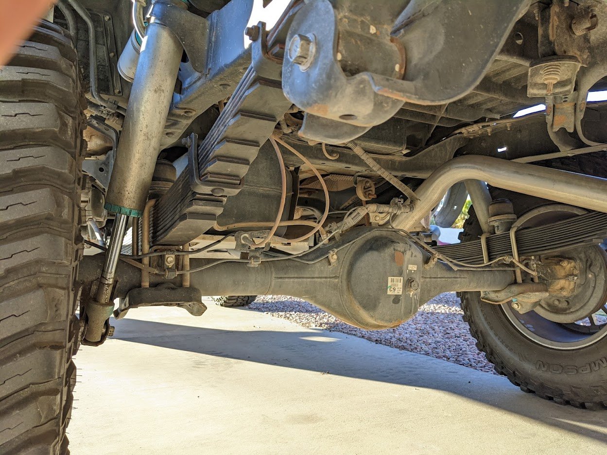

    Truck's done. They added a leaf and re-arched them... netted me about 4" of lift in the rear.. so some slight rake I imagine. I will find out when I pick it up.. They did say my shock has only about an 1-1/2 of down travel and offered a solution of relocating the lower shock mount and extending it. I said no thanks.. as I dont recall that ever being an issue with the ET Kings. Picking it up today, so I'll poke around more.. and it should settle some with time and once I add some more weight/gear.
    @snowsk8air2 you know more about this shit than I do.. what say you? I was just a little confused. It's been years since I've even thought about leafs and rear shocks, lengths, etc.

    Odd I would think you would have less up travel rather than down travel with it being higher. 4” is pretty high. I think even with my super heavy pack I’m close to 3”.

    I have about the same currently at about1-1/2" to 2" of down travel till I bottom out the shock about 1" till I hit bumpstop. So not to worried about it. But still with 200lbs of weight to add... I think its going to be cutting it close when you are on dirt weighted you may be close to riding your bumps and feeling everything rather than letting the suspension do its job. So if you do relocate the bottom hanger it wouldnt do much. If I am thinking of the problem correctly. Im confused and just rambling now.

    same boat.. I was confused for sure. Once I get it and see it all and get the rest of the weight in there and it settles, I think it will be fine. Probably the same thing that yours is.. and what mine used to be before it started sagging with the weight. Its just been so long...
    worst case.. I just pull the extra leaf they added.

    It's actually probably completely fine. I prefer up travel anyways.. and that's how I have the front setup.. so they just matched it and saw that's it's all up travel and hardly any down. It's fine.. I'm sure they were just looking out.

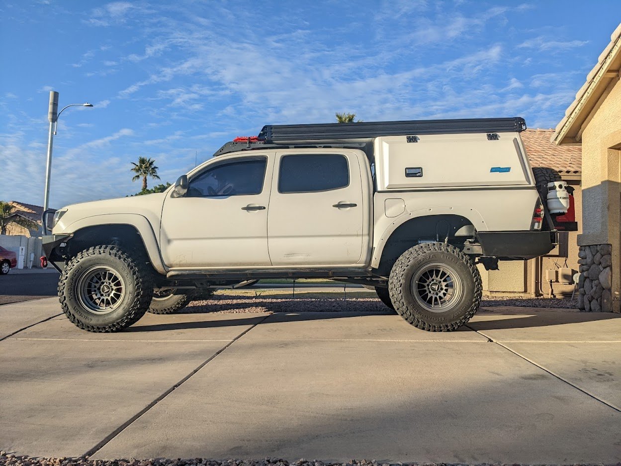

    yesssssss.... not too bad at all! they had me all worried. It rides great, nice and balanced with no sway or anything. no jarring stiffness, etc. VSS once again does a solid job. I will always recommend them.
    19" ground to frame up front and 19.5" in the rear. other measurements confirm its only about 1/2" of rake right now. Should settle, especially with the rest of our gear loaded up. Super happy with it. Hoping to finally finish cutting the rear flares and get those back on this weekend, as well as start messing with a self alignment.
