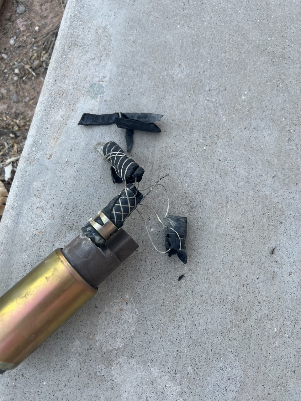

    I have power! When I installed my fuel cell I had to lengthen the fuel pump bracket and the hose inside the tank. Apparently the hose I used was not fuel safe. When I tried to remove the hose it just fell apart, tried to bend it and it just broke. I was probably losing fuel pressure right there. Now I have a P1130 pending, which is air/fuel ratio not expected, I assume because it’s getting a ton of fuel now. Disconnected the battery and will try again in a bit

    2nd drive no pending codes and no light :bananadance:
