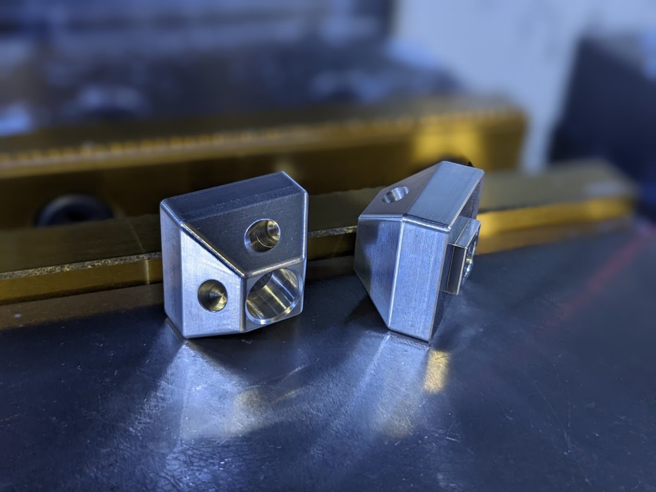

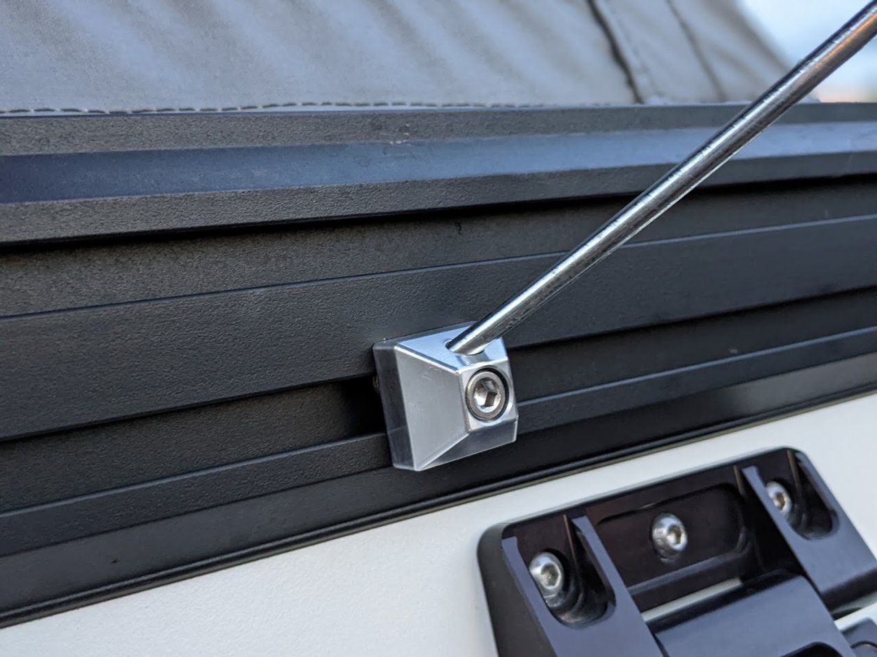

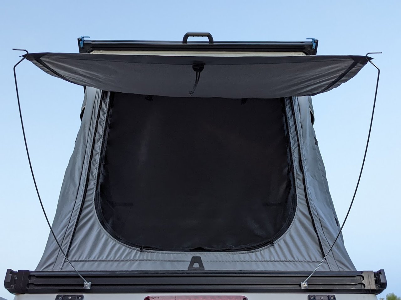

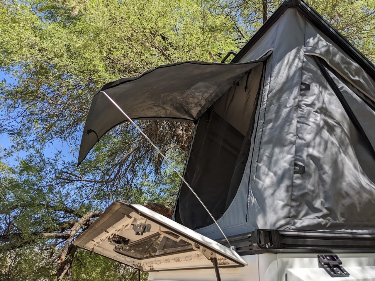

    Finished up these little guys Friday and tested them out yesterday for the day with Lyd out by the lake. Need to make a couple changes but they are very close and work pretty well.. even with some wind gusts.

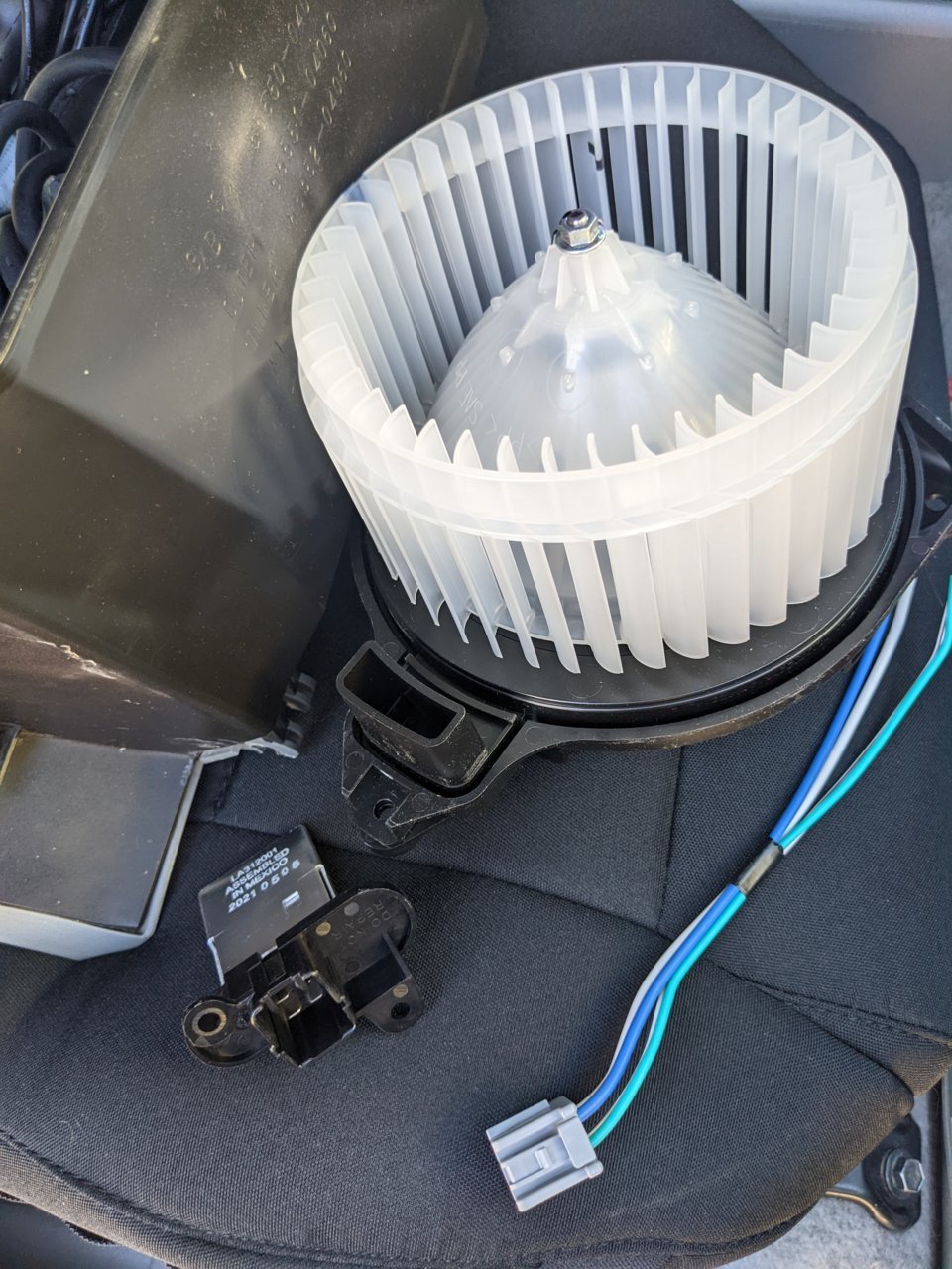

    Got some much needed little things done on the Taco the last week or so.

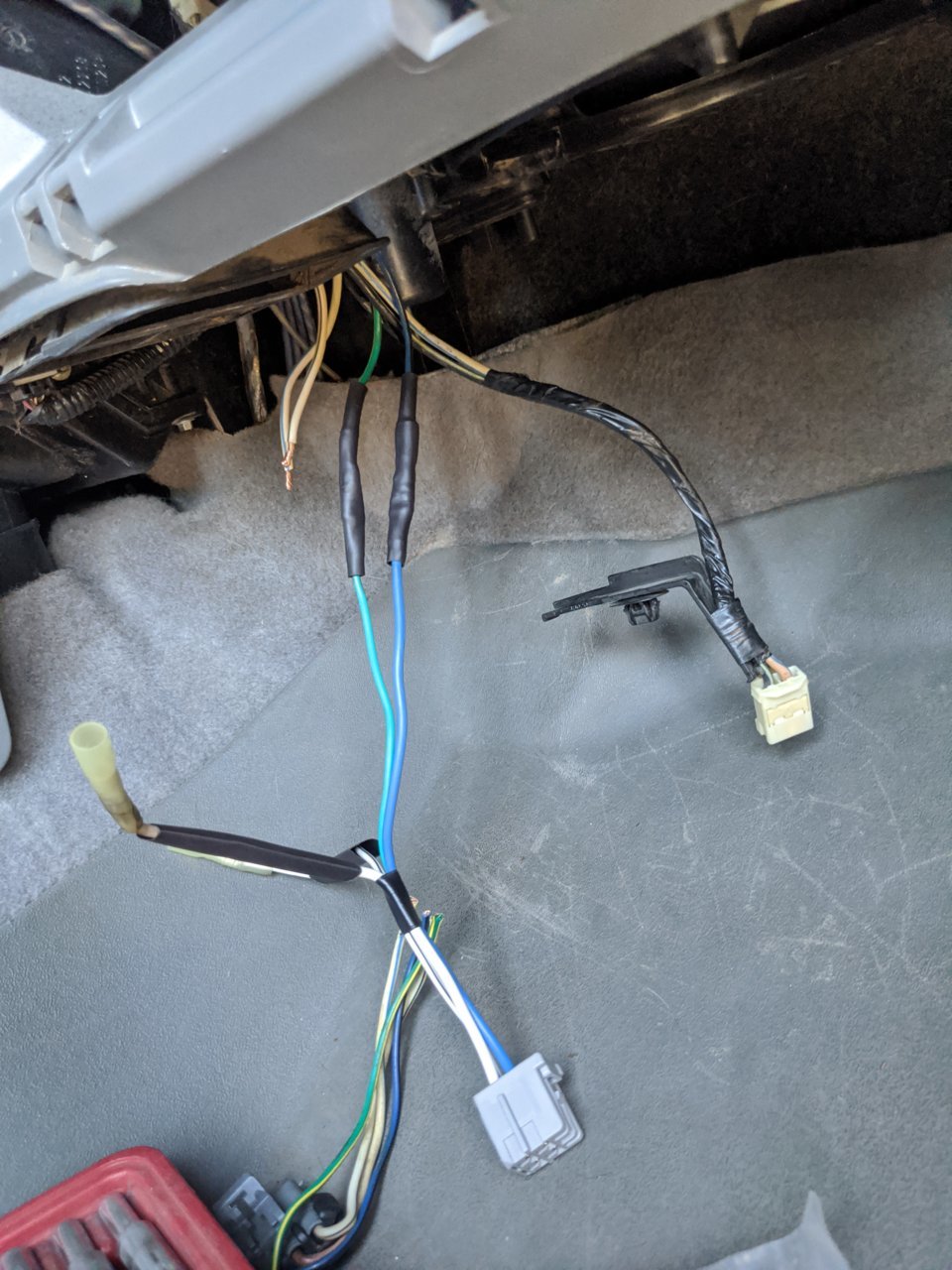

    After years of dealing with a finicky and very noisy blower motor, as well as replacing constantly dying resistors, I found out there was a TSB for the entire system. It includes a new harness pigtail with new style plug that requires to be cut and spliced into the factory harness plus a new style resistor with mating plug. I also picked up a new blower motor that is a new version as well, and got a K&N washable cabin filter. Swapped in everything quick and easy since it's all under the dash, behind the glovebox. Wow is it nice to have a fully functioning climate control system and nice, quiet blower motor again. I have AC on every fan setting now and it blows hard and cold. I actually thought my AC was going out after all these years, but it was just a mix of a clogged cabin filter and a worn out, old, inefficient blower motor.

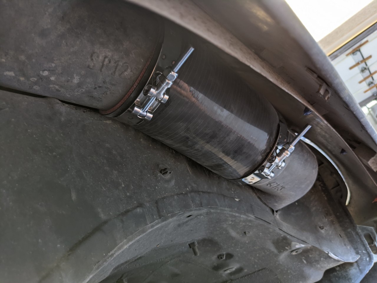

    Also found my Airflow snorkel tubing was toast. Crumbled in my hands during inspection. Replaced it with a 4"ID silicone coupler.

  14. Jun 16, 2022 at 8:56 AM
    Torspd
    Torspd Tor-nication
    Sep 18, 2009
    #22958
    26,301
    Tor
    The Great America!
    MMVI 4.4L 4x4 Access Cab
    Torspd Custom Turbo kit [] Borg Warner 9180EFR Turbo [] Haltech Elite 2500 [] TiAL Q BOV [] TiAL V44 Wastegate @ 15psi [] CP Pistons [] CP Carrillo Rods [] ARP Head studs [] ARP Main Studs [] ARP Header - Head Studs [] Ported Heads w/ 1mm oversized valves intake/exhaust [] Brian Crower Forged Stroker Crank [] Darton M.I.D. Sleeved Block [] Kelford Camshafts [] Torspd 160* T-stat mod [] APR Large Fuel Rail [] Walbro 460 LPH E85 Fuel Pump [] FueLab FPR [] APR T56 Conversion Kit [] KP RACING Built T56 [] McLeod Racing Custom Twin Disk Clutch [] One Piece Aluminum Driveshaft [] MGW Shifter [] Custom lowering kit [] Ohlins Front Coilovers [] QA1rear shocks [] Custom Ron Davis Radiator [] Dual SPAL Electric Fans []
    Just means your nose filter was working harder. ;)
    Good thing you found that degraded "coupling". Doesn't really deserve that name anymore. That would have been bad to have trust in it, then find out after the fact. The silicone will hold up much better.

    and for real.. Glad we didnt commit to that water crossing a little while back. lol I think so too.. plus create a better seal I imagine.
