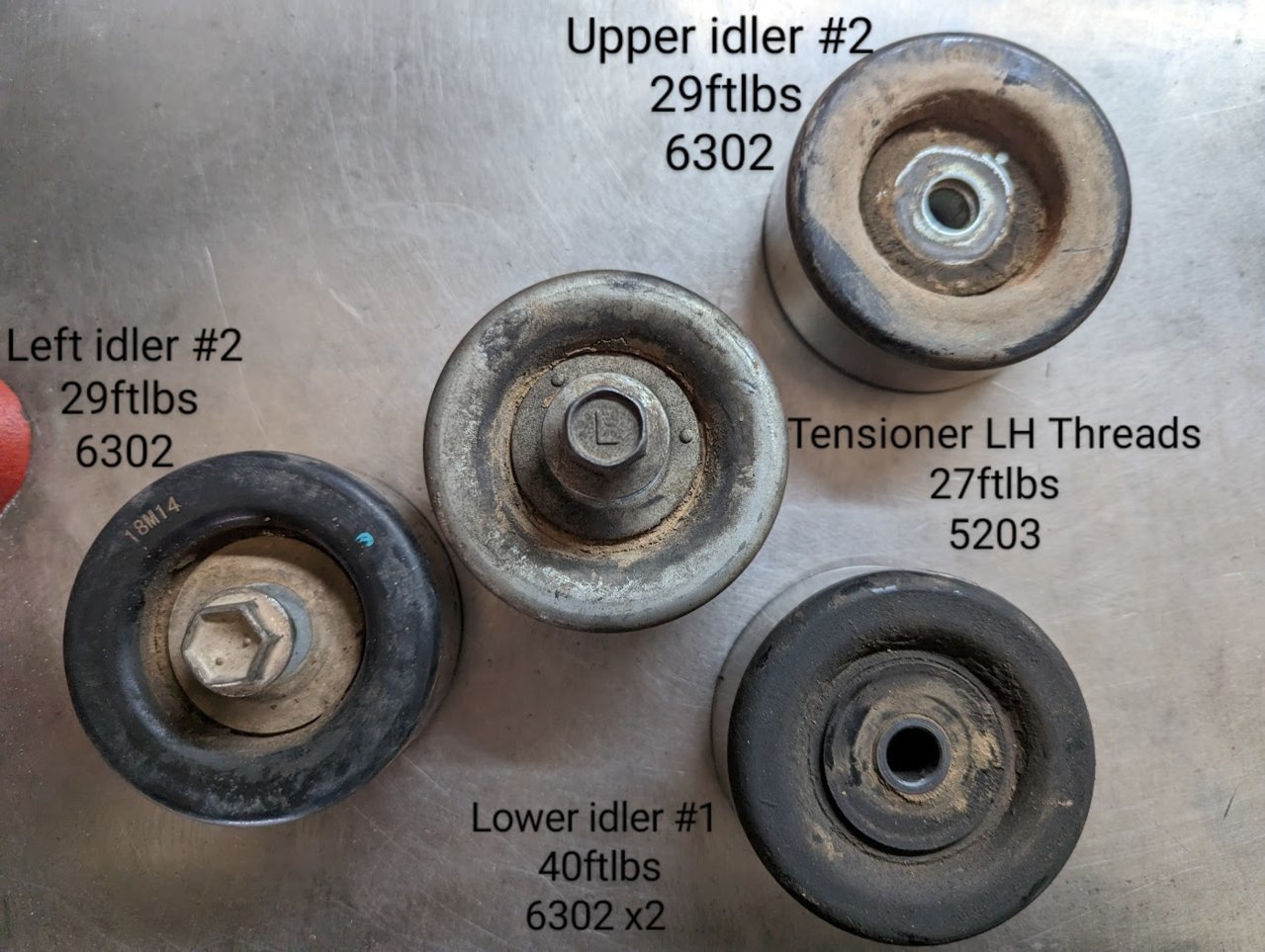

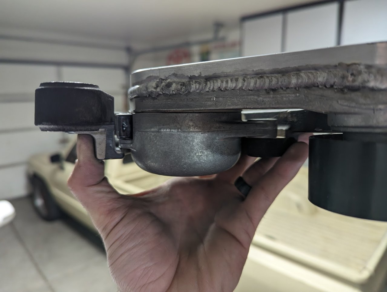

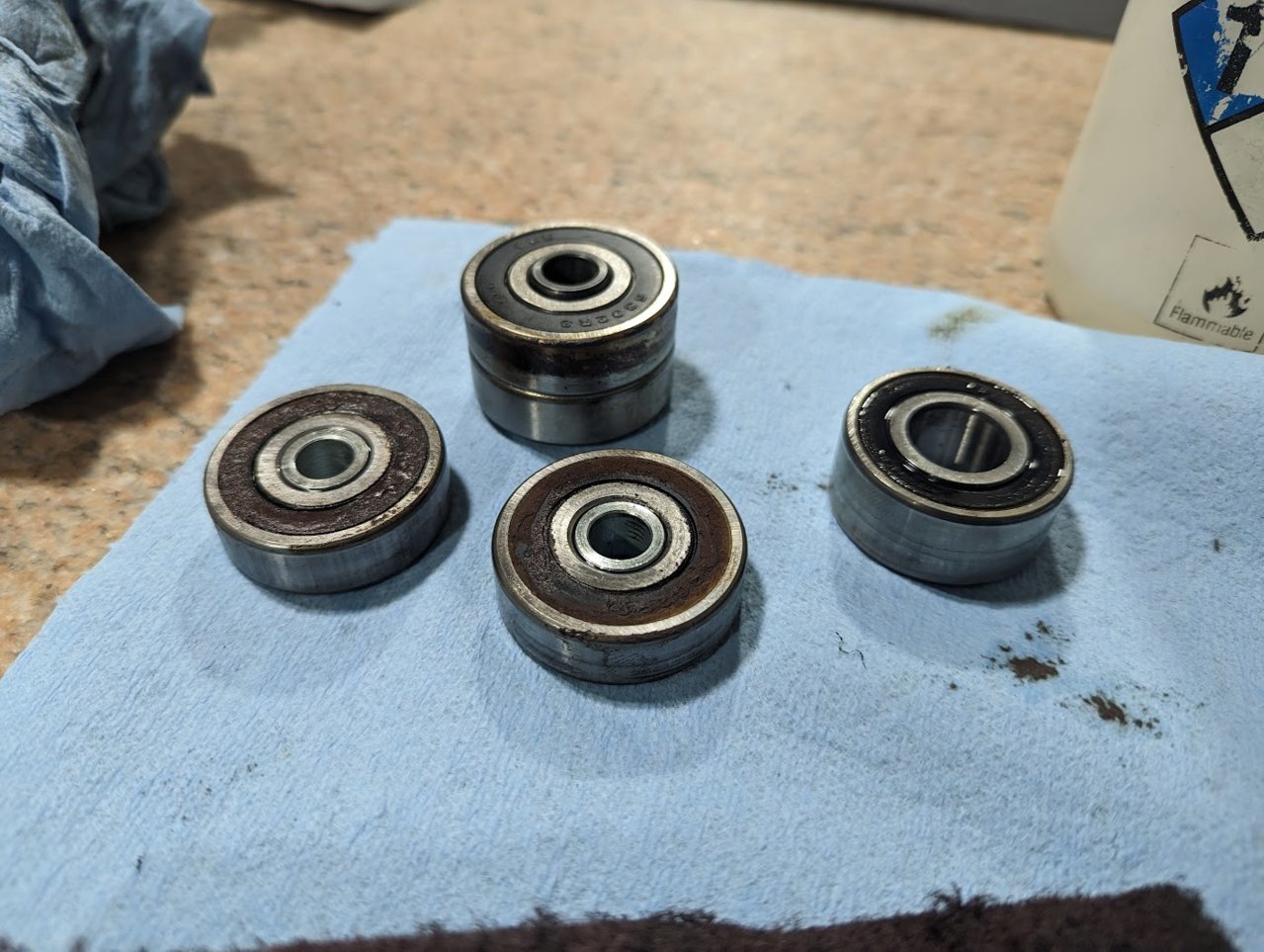

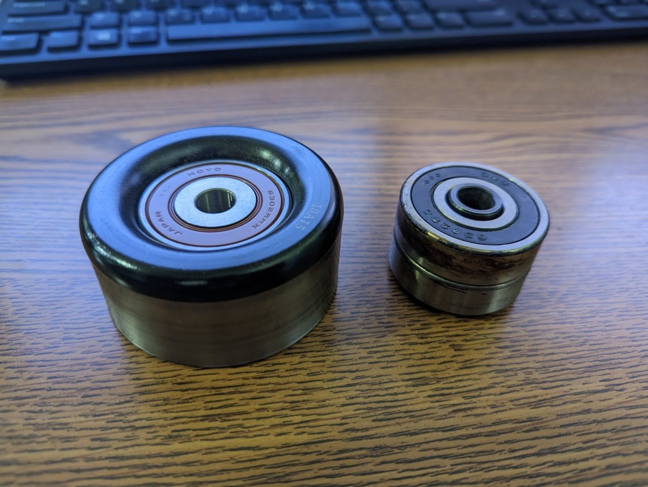

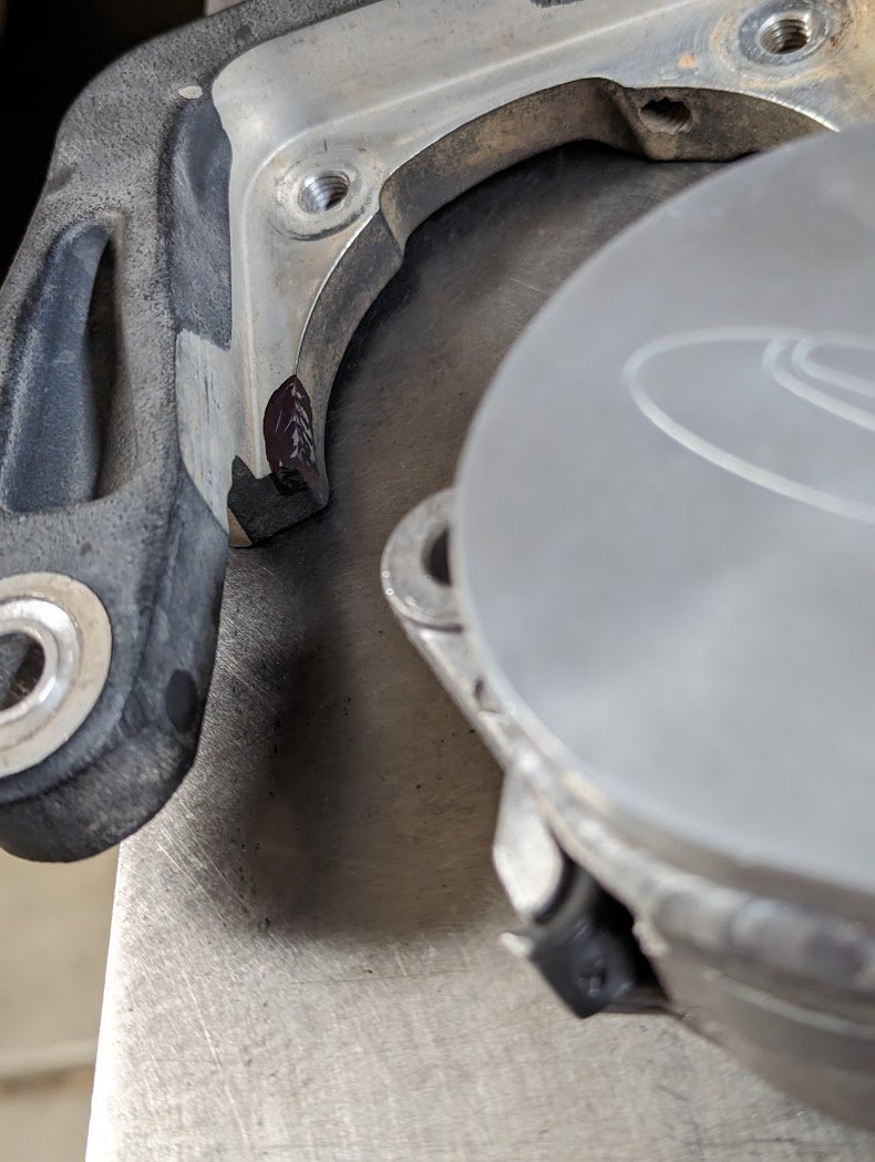

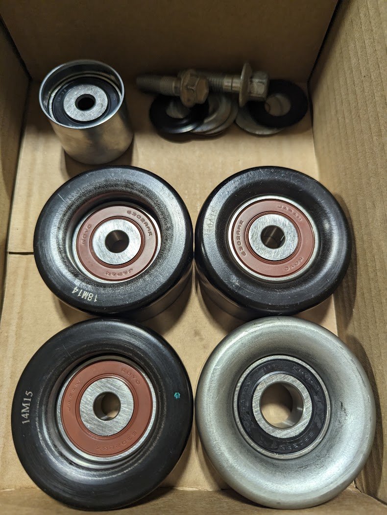

    So coming back down from the mountains over New Years I broke my 3rd S/C tensioner. Made it home luckily, but tore into it to fix and upgrade things so this hopefully wont happen again. Ordered an upgraded Tensioner from Steeda. Same as our trucks but for a Mustang, just has a chunk of billet burned onto it to help brace it and make it more rigid and eliminate the weak points in the casting. Just needed to modify (grind for clearance) the S/C tensioner bracket and trim the spring on the Steeda itself. Took the opportunity to replace all the bearings in the engine and S/C Idlers as well, including both tensioner pullies. I also wanted to be able to use a factory 5 rib S/C belt.. so I gathered parts to do the pulley wrap mod @BillDaCat8 came up with so I can run a factory 70.5" belt and not have to cut off any ribs. I also picked up 2 new belts, for the engine and S/C. Between all these fixes and upgrades, this should help prevent anymore stress in the system and hopefully help with any belt slip I was getting in the S/C system.. if I was getting any.
    I pressed out and in all the bearings at the shop with the press, and gathered all the random hardware and parts I would need to reassemble. During the installation of the engine tensioner pulley, I set the torque wrench to the Spec'd 27ftlbs.. and it snapped the bolt. I even tested at 10ftlbs prior and it went fine. So.. reassembly stopped and a new engine tensioner ordered. I need to unbolt and move the Alternator and AC compressor to gain access to the tensioner bolts. I'll tear down everything, replace, reassemble, and install the new Steeda tensioner and do the pulley wrap mod last. Hoping to get this all buttoned up for KOH.
    -_THaytH3wpRcsMyCYJKIGOKj-hpIo073YYohytQ_0e9fc288b326b6f1e283afe62c85a7f2f217160a.jpg
    cut down Steeda spring
    3vSrFAqufGUAKc_1nONyB3lcckEm0vfY2wiPow_-_82865e087661fad29ff04e55f11189fa4b09b4a1.jpg
    S/C bracket ground down for clearance
    3MsjupKriTxZePFaix3KJkHnBu340EC-xFJHLoVr_61089117ab58f1837656916bdf161a0ecc2ae666.jpg
    PdtAeRv5XTKcO_9E3Rk1I4u88DYUlSMUv8ZaR6U6_f221d4920853610ac57050df28301e710b94bb15.jpg
    R5zl_bNsXt4DbLvHT7ZY_WDEOsnx2E_IPUZh9gFJ_cf353697b841853479a5eb9b843b642960efeb12.jpg
    i94VO4xU319O3119RfW7c9RDEq6v3tROwzC8swZX_395a0cf5f6b95395e9488e486a1ed29266927281.jpg
    Lower 2 S/C idler bearings swapped in
    1xZmyKvcQQWpjVKqPrbrmhnYTVnA-QOSO0ZOc-Qp_929489d68a20e2c63bc81f37ca8f49830e5782d3.jpg
    Layout and bearings for engine idlers
    DNhjhJHKeh9wYY9WcLWiyE1SbQNlEbBlBI1ZqAYL_38490e087ce211f71b910e4e226bd32a638b7e9f.jpg
    old bearings pressed out from engine idlers
    APCI6k5BpNHpOAmW0rGBGiKOgA5tOty3iB7EDUsI_03a3365de7c2906b3f2fc9a24add25c7f5d0d665.jpg
    new bearings pressed in
    iSlgONMfOLnUqqXeRmu7QH0abUqeFCX-hMq2H-nw_38607686d6f7db0e1aa772e67fdab7374366bea6.jpg

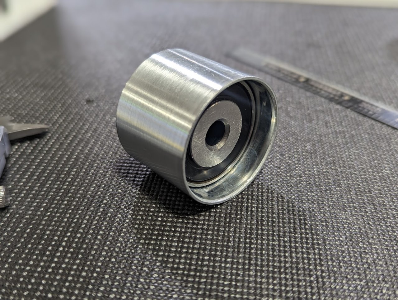

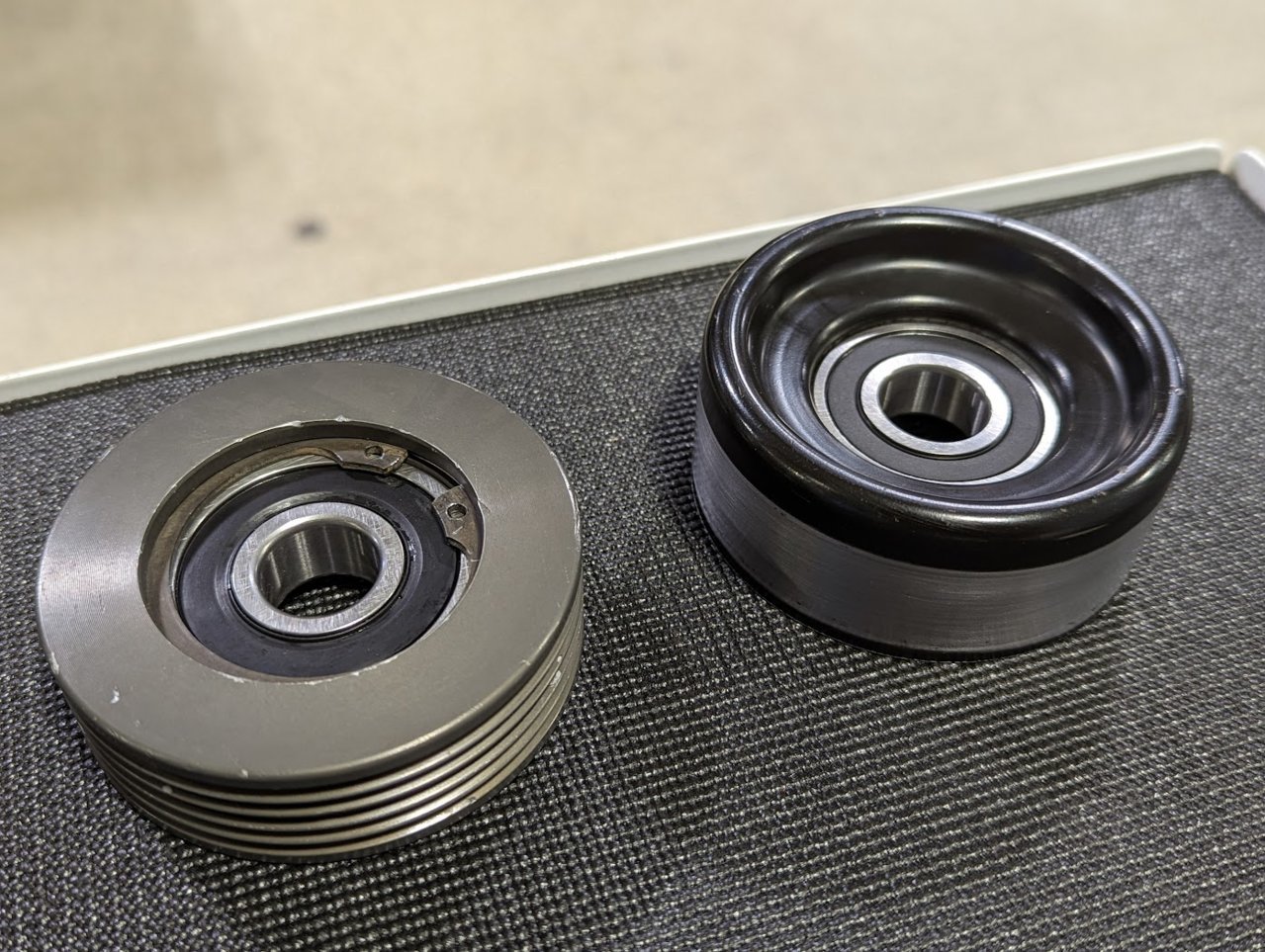

    modified VW roller for pulley wrap mod
    khWnRK5ONlGKAfXBX1zleFnn77yg81cnpSmc0dSj_02e9de9212fe5c0908c6fe52fe47b1072b0ee48f.jpg
    6cmf-kavbeHLxlQqdrOignOqrmGri8rbT46K7HMt_0574f6852b548146e5487fcc1ac2b4fe51f64648.jpg
    Spacers/washers were required to get the spacing correct with the new bearings for the Idler #1. You can see the old Idler #1 bearing has a sleeve that sits proud of the bearing race on each side. I had to add about .080" total of thickness to get the Idlers back into the correct spot. before and after below..
    zTuGKNemovOQu4s_7c_NsAdN8OeB9O578t6U6-7R_25829a654744585aef71e9ee20973384ede5c3bf.jpg
    before
    RKXNSpNYEnIQahNA-G7wyF3ANLIVU_CceIutc6MC_edde6b9de5adfd880cfc3bccec8b64f97adc016a.jpg
    after
    4LmGcTQZEyTtBZ4Rhu8sOQn32kSAgfhjS8GE9EqU_2fc45af4630d92823348688fb891031bec89d5af.jpg
    -WSW0wjAapLySMhdbXDe7dfLUMBT-2Y0yB4tfIXc_a75df53edb072d41b049040b544e0dd03868df8d.jpg

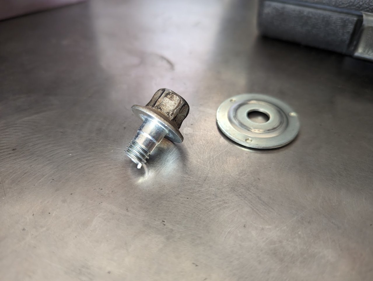

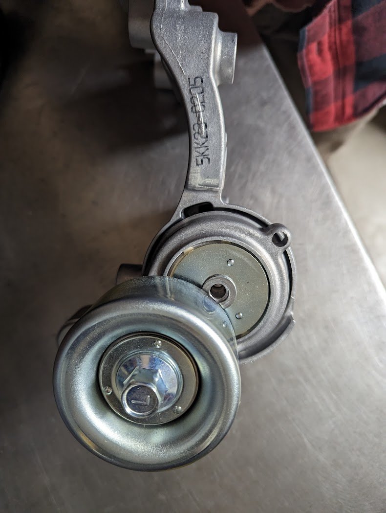

    then.. catastrophe struck... snapped the engine tensioner pulley bolt while trying to torque it to spec. 27ftlbs my ass...
    QfVRmnWGqrqh5Gpz6ZbE43bSyptxFDtqMd_ZpcTE_588381965803938522be8b4662798b497b98bfaa.jpg
    I'll just got hand tight next time... :faceplam: Ordered a new OEM tensioner.. just gotta slap it all back together now.

    Might've been weakened over time from the 2 failures, or is this not for the S/C?
    XPOTRPR[QUOTED][OP] likes this.
  10. Jan 24, 2023 at 9:30 AM
    XPOTRPR
    XPOTRPR [OP] CNC Programmer/Machinist
    May 29, 2011
    #57449
    31,159
    Josh
    Chandler, AZ
    > BUILD LINKS >
    This is the engine tensioner.
    Slashaar[QUOTED] likes this.
  11. Jan 24, 2023 at 9:33 AM
    Slashaar
    Slashaar Trail Limo Supreme & Certified Hole Massager
    Nov 23, 2017
    #236717
    15,513
    Josh
    Kansas City, MO
    2015 Tacoma TRD-Sport DC LB
    Coastal HC Front, 6112s+650lb King Coils, JD 62 Swap + 14" Fox 2.0s
    glazed over that. oops. :oops:
  12. Jan 24, 2023 at 9:41 PM
    BillDaCat8
    BillDaCat8 Well-Known Member
    Jun 25, 2017
    #222348
    1,915
    Jake
    PHX
    07 4x4 Access Cab M/T
    My shit is all stock.
    I’m suspicious of that 27 ftlb spec. Reverse thread, right ?
  13. Jan 25, 2023 at 5:18 AM
    XPOTRPR
    May 29, 2011
    #57449
    31,159
    Josh
    Chandler, AZ
    > BUILD LINKS >
    Yessir.
  14. Jan 25, 2023 at 9:30 AM
    XPOTRPR
    May 29, 2011
    #57449
    31,159
    Josh
    Chandler, AZ
    > BUILD LINKS >

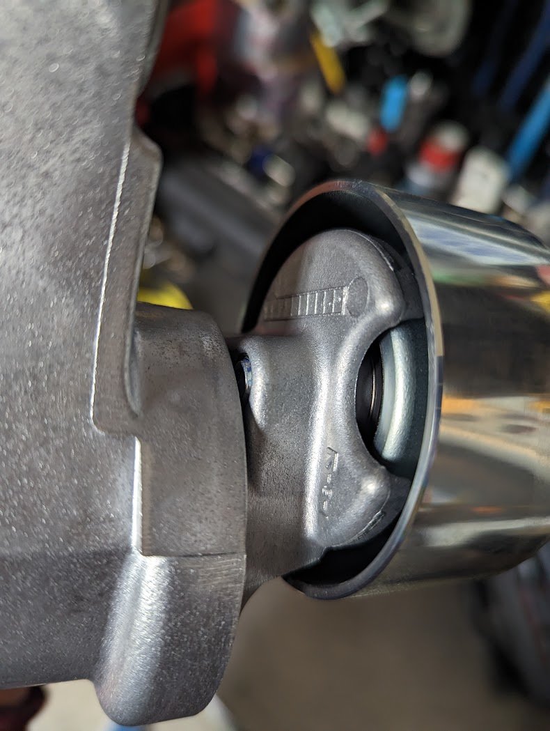

    @BillDaCat8 Photos of the new tensioner..
    qmTCsJvmNCt6WqVikm3ODQqcPD3wHE-Nh53zid2d_3b0b51d5b64676d72e8c3b57b9473dd7171b3d22.jpg
    I'm curious to check the bolt after I pull the old one.. wondering if it bottomed out somehow into the tensioner body.. You can see how close it gets here on the new one.
    rBZDwdPzVt0MwEX6xRQFXmhuAI-HCrkKfgDEA0tK_7bb2145c7528f5102df7e06d1e6bd4f4abf3b29a.jpg
