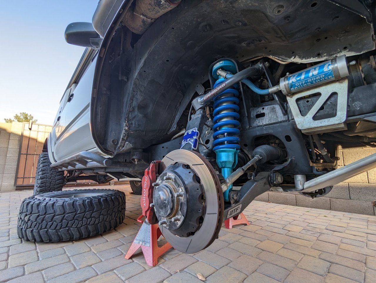

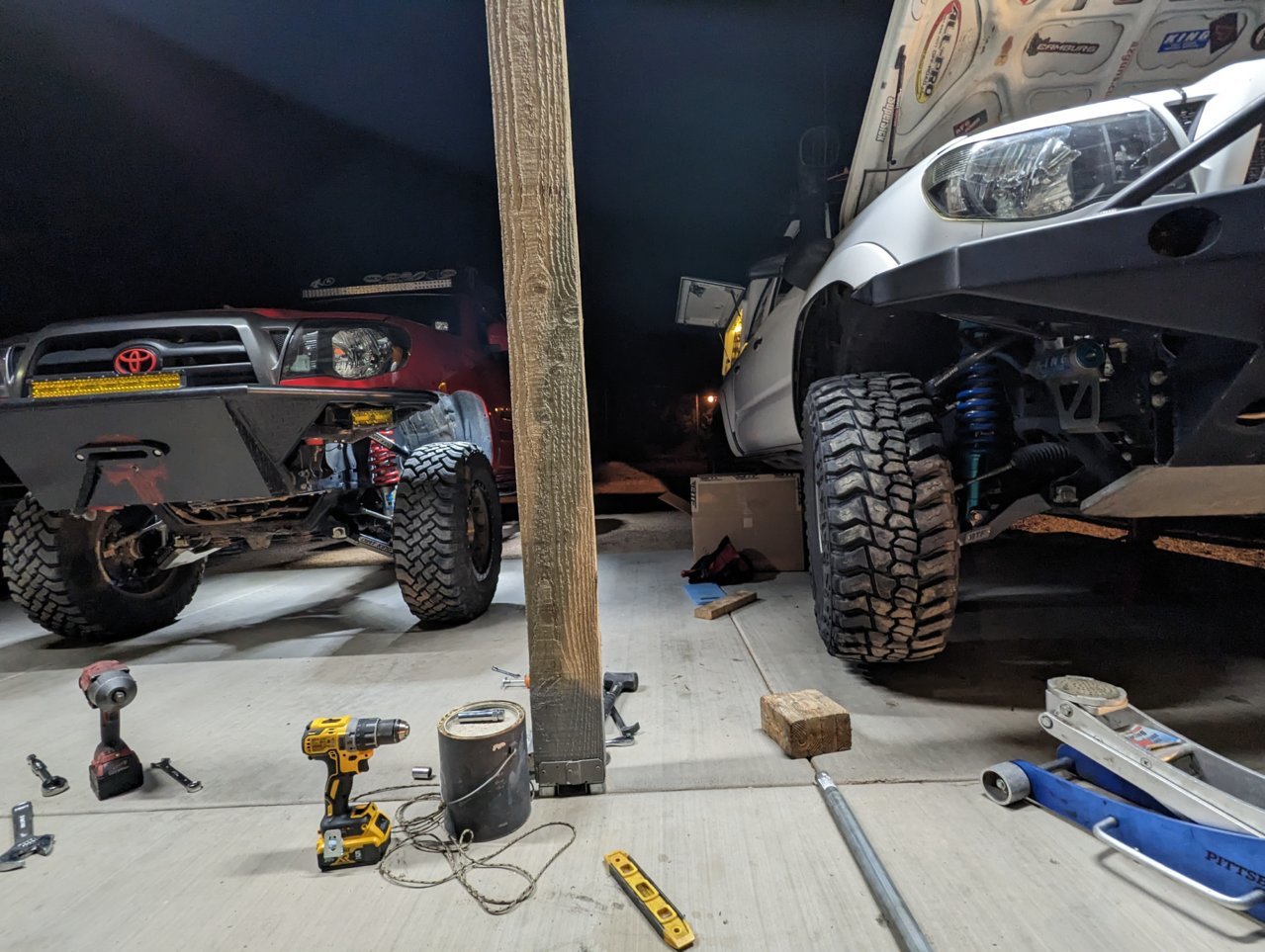

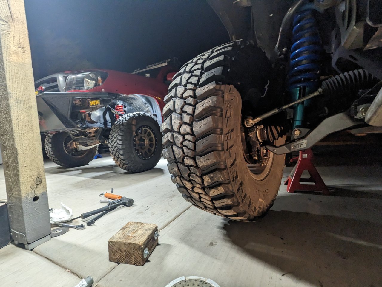

    Done. Good time with @Yacob_D and @Southwest_Taco_Jonez working on Tacos yesterday. I showed up after they had been going at it for hours prior doing a slew of other mods.. then we knocked out the LCA swap. Went pretty smoothly, especially with both of us running Poly Taco Tabs. Huge improvement on firewall clearance now with these BTFs. Need to get better pics.

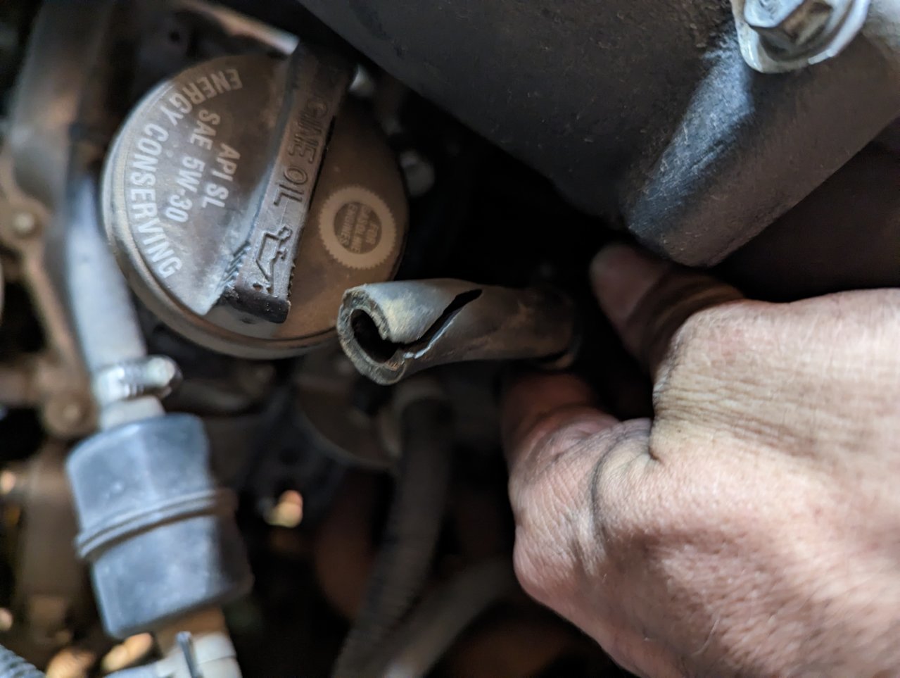

    Also had some p0171 and p0175 codes pop up on the drive over. Ended up being a split fuel vapor hose off the VSV. Cut it back 1.5" and back to good now.

    Some better pics of the BTFs..

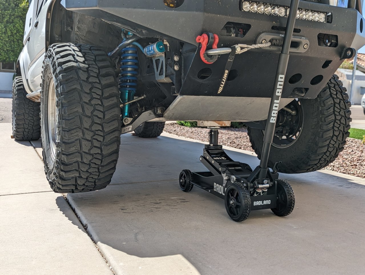

    My badlands jack finally came in. Definitely an awesome floorjack for only 300 bucks. Stout and good quality. Did a little testing with the BTF's over the weekend.. just a small 4x4 trail out to where we go shooting.. didn't even air down or anything, but so far so good. Excited to really test them out. Parking the Taco in the backyard now to pull my Camburg uppers to swap out the Uniballs.. It's time.. been a couple years and they have some slop in em. Going to wait until the rear swingarm shows back up to start messing with the suspension again.. but the plan is to hopefully pull a leaf or two to drop rear ride height.. and then swap my coils from the 700s back to my 650s and adjust front ride height to match the rear. One more alignment then should be good for a while. Last thing will be tuning shocks. Either locally (preferred) or send out. Still need to send out my 2nd set of Summit Dakars for beadlock conversion too.

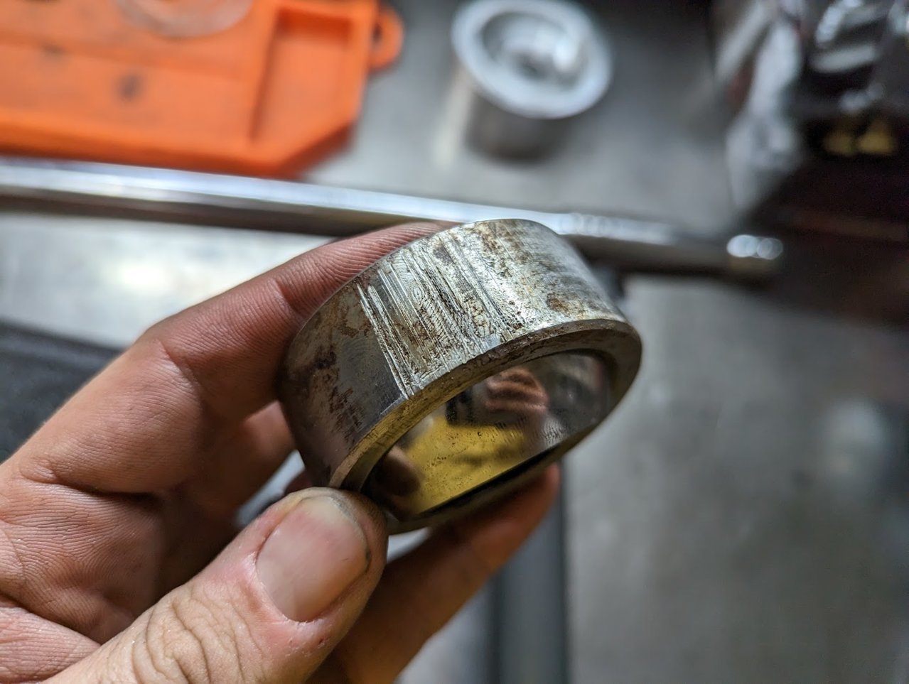

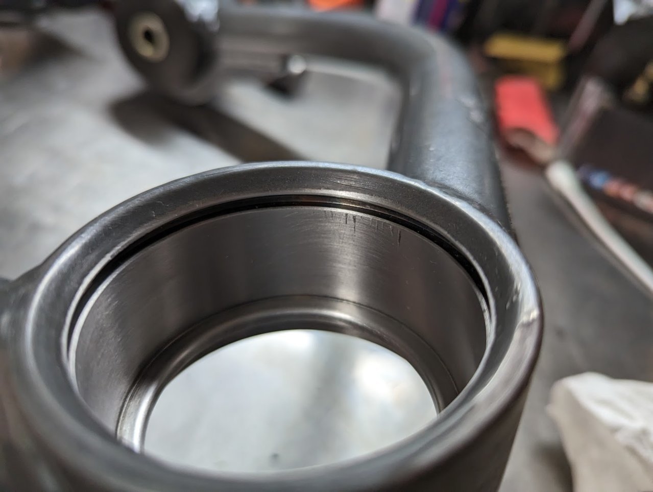

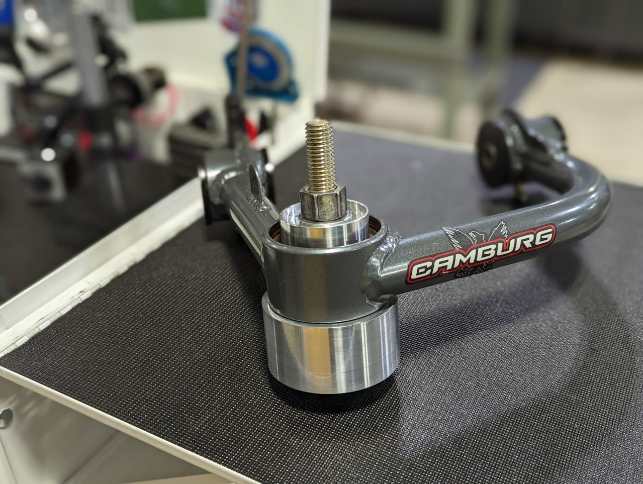

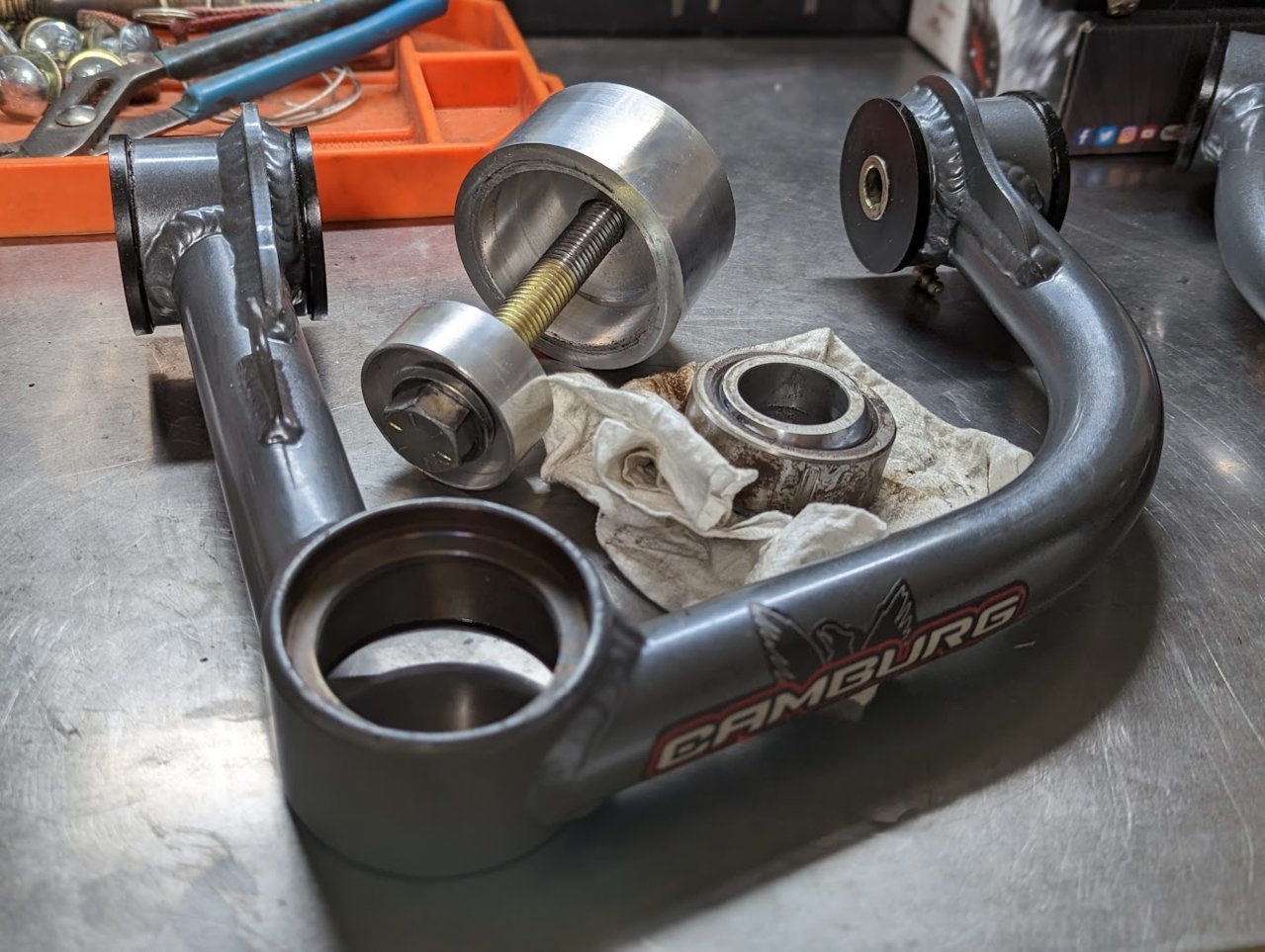

    Been slowly rebuilding my Camburg UCAs the last week or so. Made a removal/install tool for the 1.25" Uniballs, cleaned up the cups, need to order a bushing kit today and then slap them all back together. Cleaned up everything up front and I'll do a fresh coat of paint/undercoat before re-install
