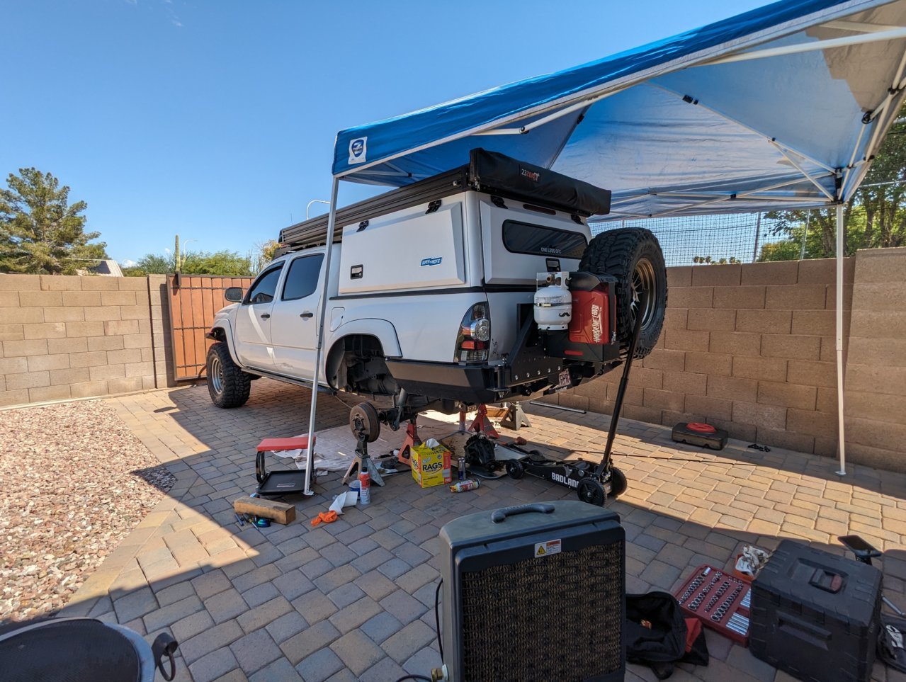

    Going to run around this week to grab supplies and materials needed, get the Taco in the backyard. Maybe start tearing into it this weekend.

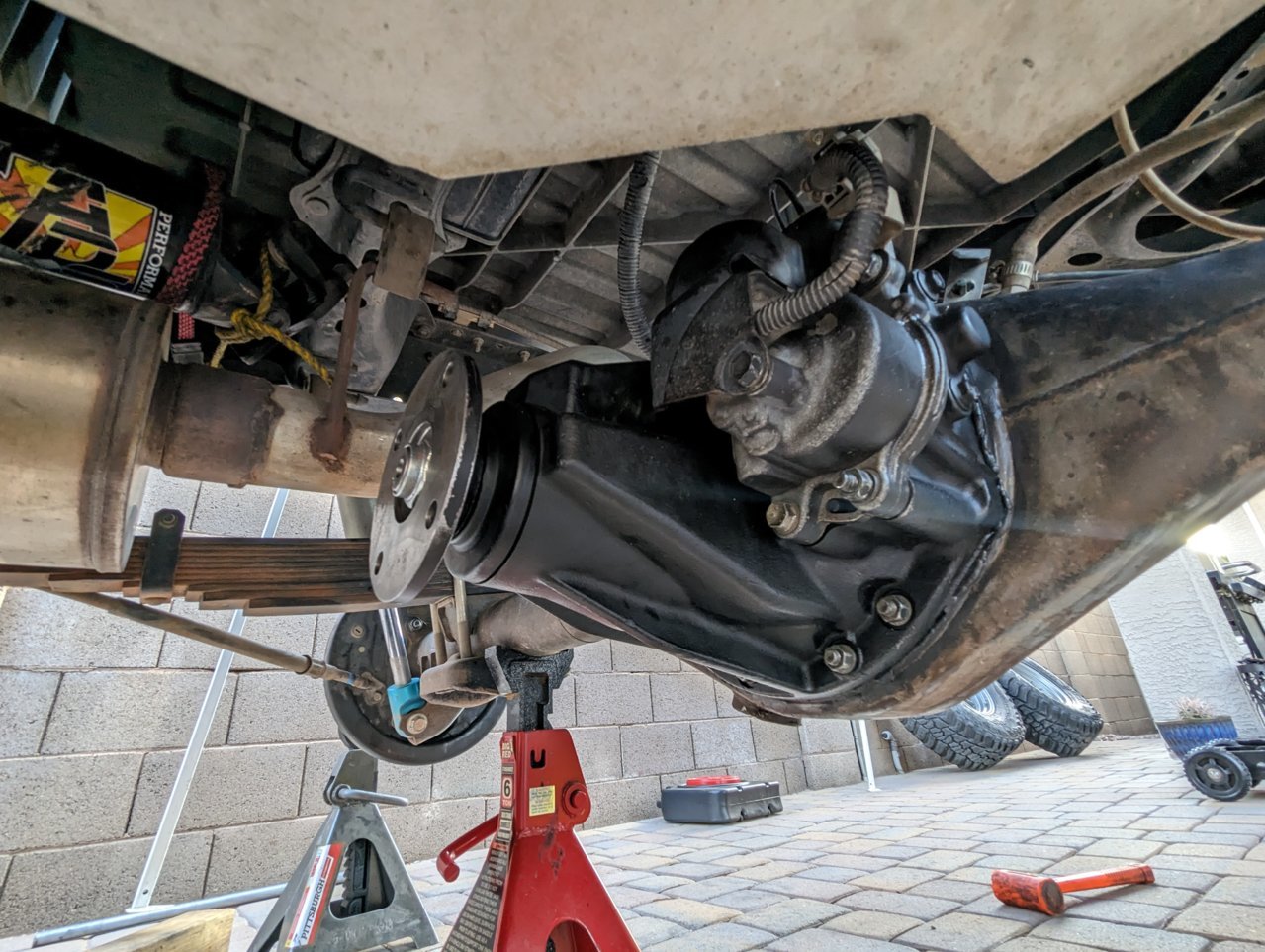

    Replacement 3rd from ECGS is in. Thanks to @Yacob_D @prise and Q for the help and chillin.

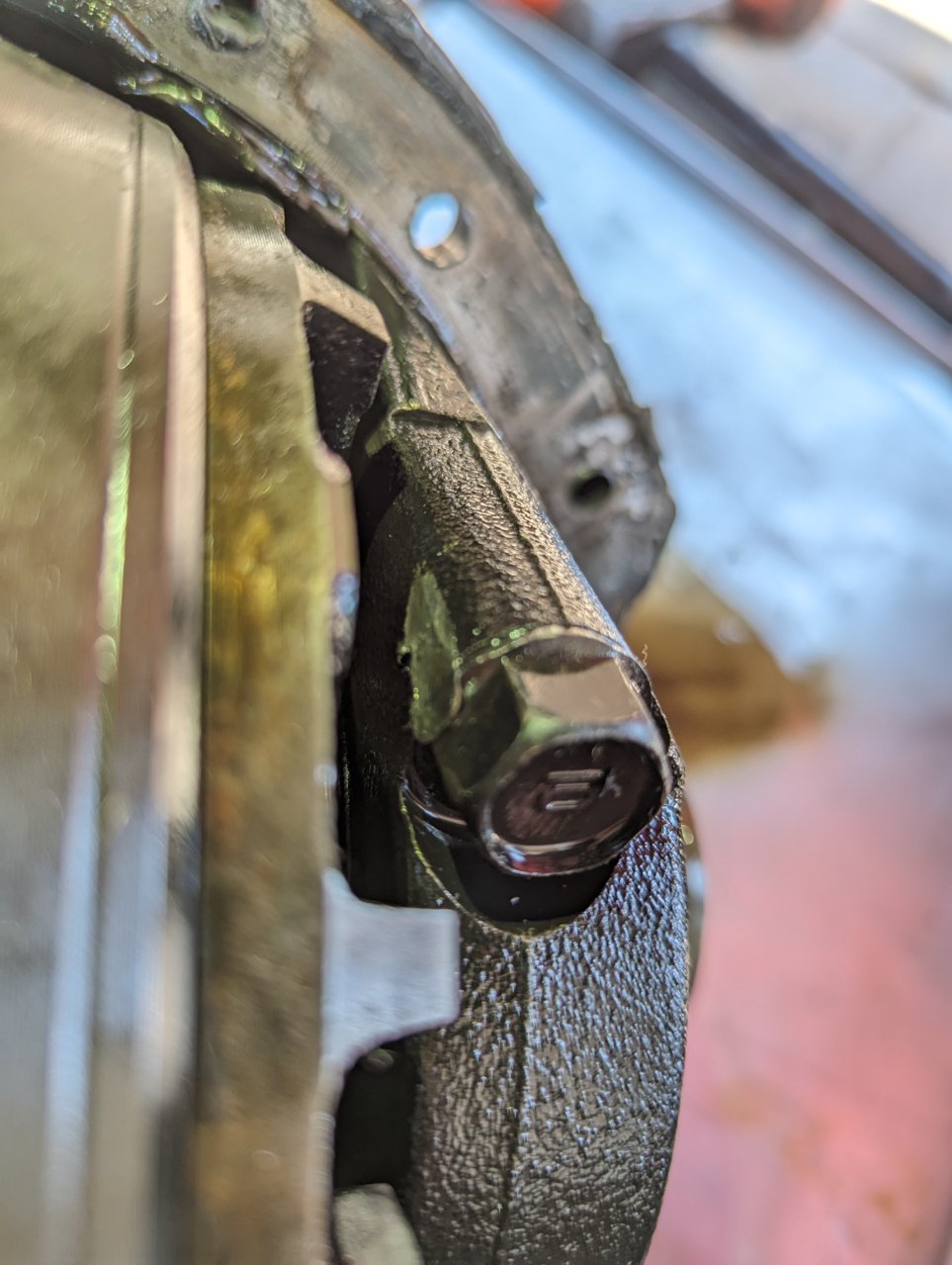

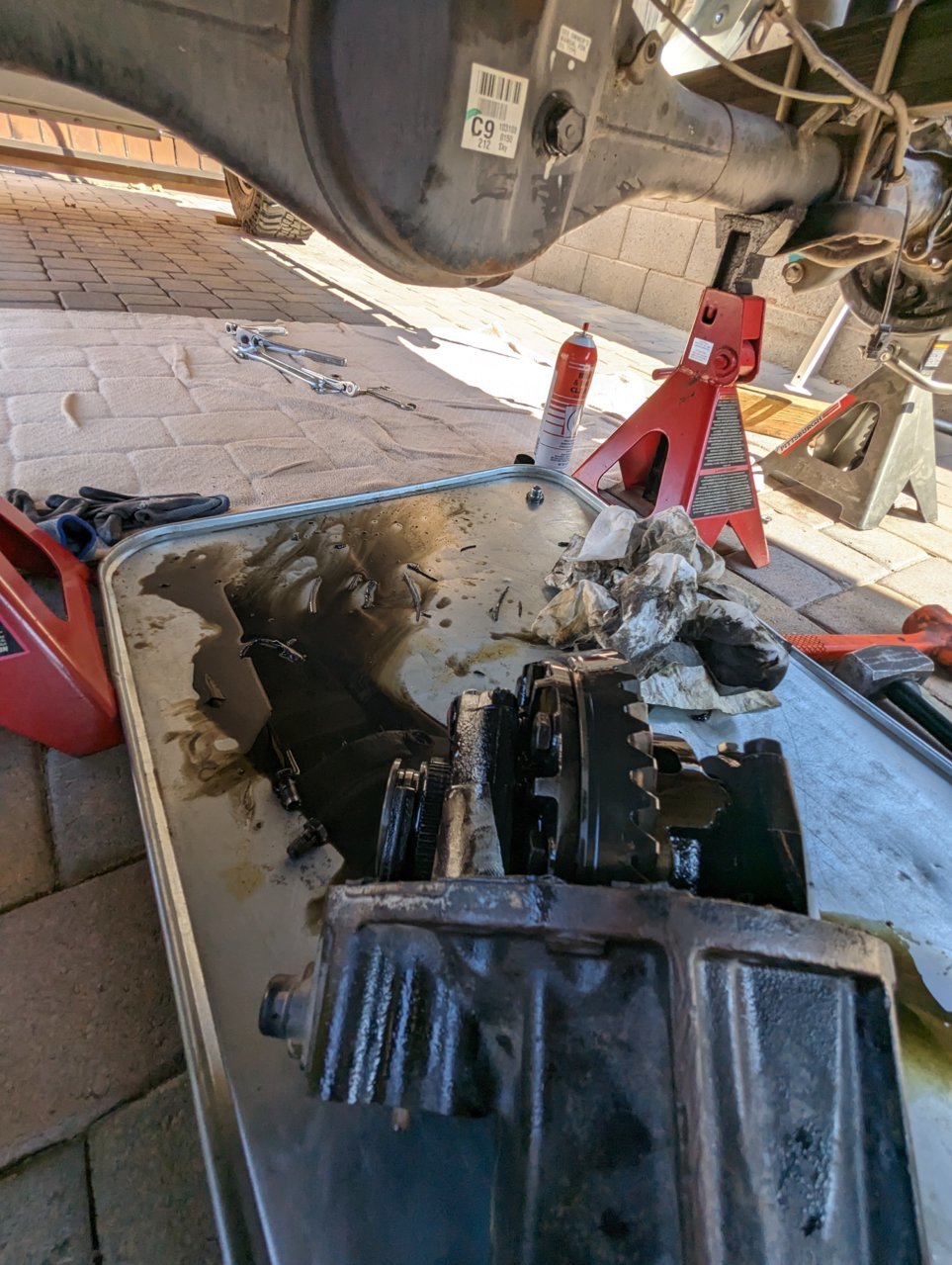

    All of the ring gear bolts were loose. 2 were backed out completely and one of them was about to grenade the whole thing as it was making contact (the sound I was hearing) and wearing into the pinion bearing caps and whatever else in its way in the housing as it rotated around. This 3rd has been in the truck for 6 years now. There were no signs of loctite.. but it has been through the ringer and seen some heat.. so maybe the loctite finally failed. New 3rd has locks on the ring gear bolts so definitely some peace of mind there that this shouldn't happen again. Was good to actually find something wrong too.. glad it wasn't for nothing and also caught it before it left us stuck somewhere. Need to get the driveshaft balanced, but it needed it anyway after candy striping it at KOH. After everything and replacing the dead battery from it sitting, I'm glad to have it back on the road. Time for break in and some trips!

    Wow, what a find. You certainly were blessed not to have that fail completely out in the country.
