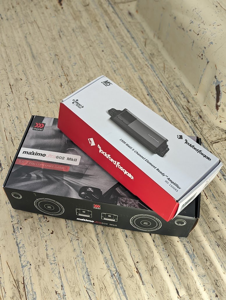

    Slacking on some updates. Stereo has been all finished up for awhile and sounding great. Added some sound deadening to the front doors while I was at it, I'm not sure why I waited so long.. massive improvement. Everything sounds great and its essentially an entirely new system. Also, Finally got the cameras wired in and working how I want with the truck. Now I have 2 front facing, one being in the digital rearview mirror whioch records and acts as a dashcam, and the other is mounted on the front bumper pointed down and out to be able to see trail obstacles and over rises/peaks, etc. That front facing is wired into my Headunit and I can toggle it on at anytime. The 2 rear facing cameras are the one included with the digital rearview mirror that is mounted up high on the back of the Super Pacific and records as well and the second one is low on the rear bumper under my spare and jerry can mount. That one is triggered to come onto the headunit when put into reverse. Now I have a fulltime rearview image that is a general overall/wide view.. and a view dedicated to reverse and I'm able to view both at the same time. Also did a balance and rotation on the Taco as well as some other little maintenance items.
    and some recent pics of camping and stuffz..

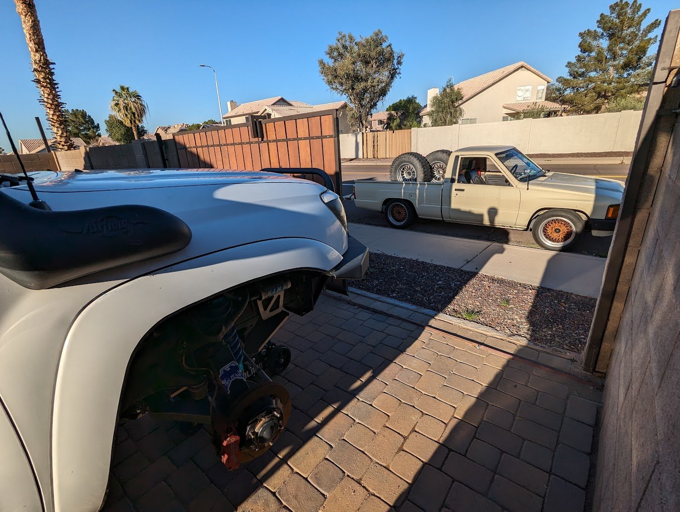

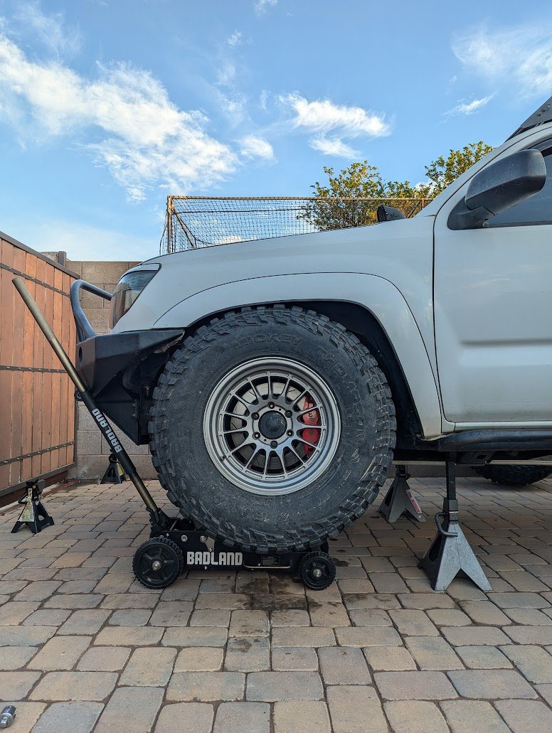

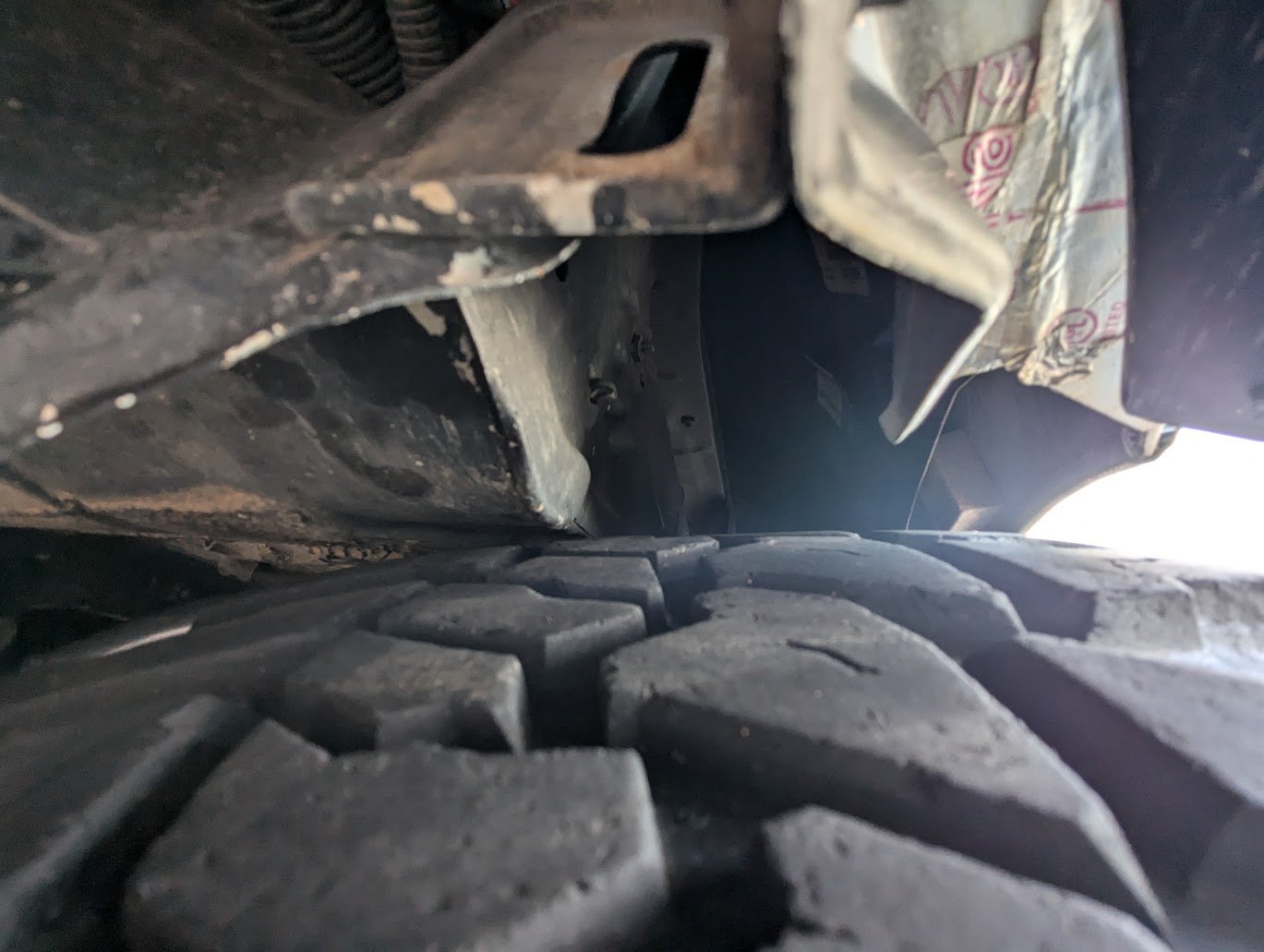

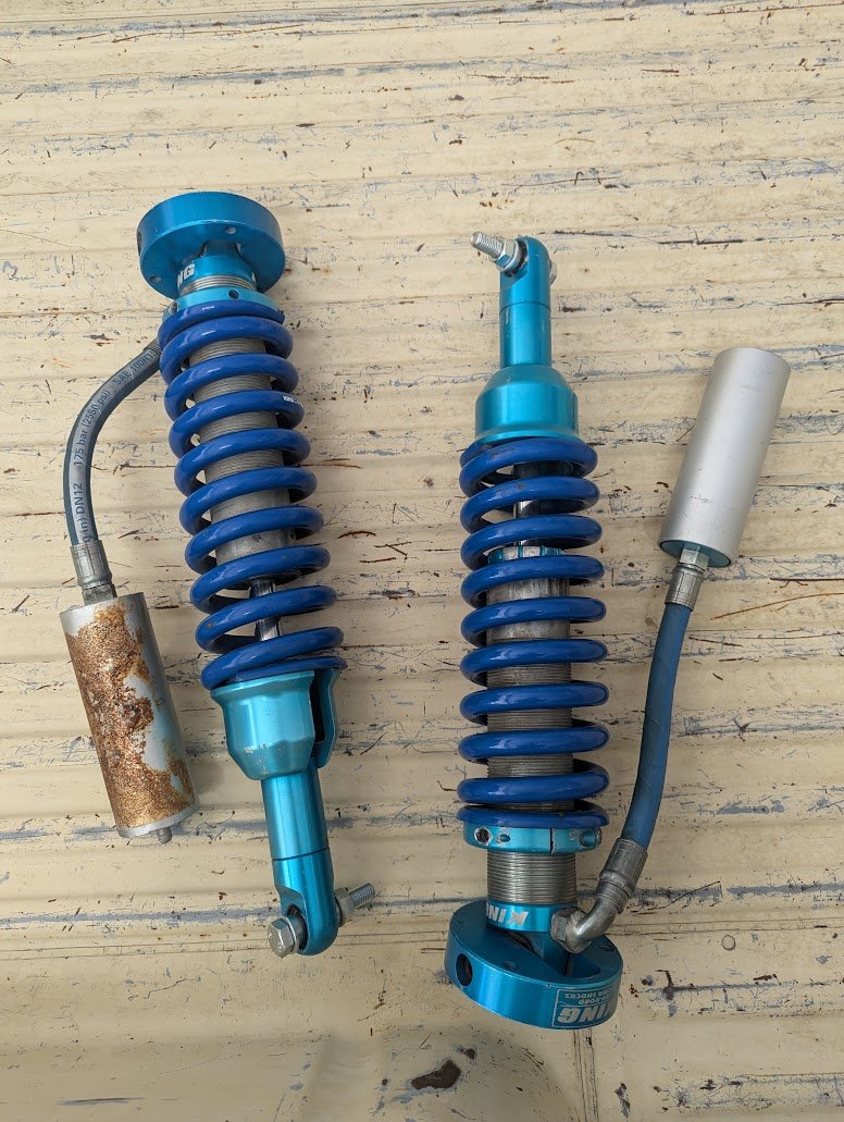

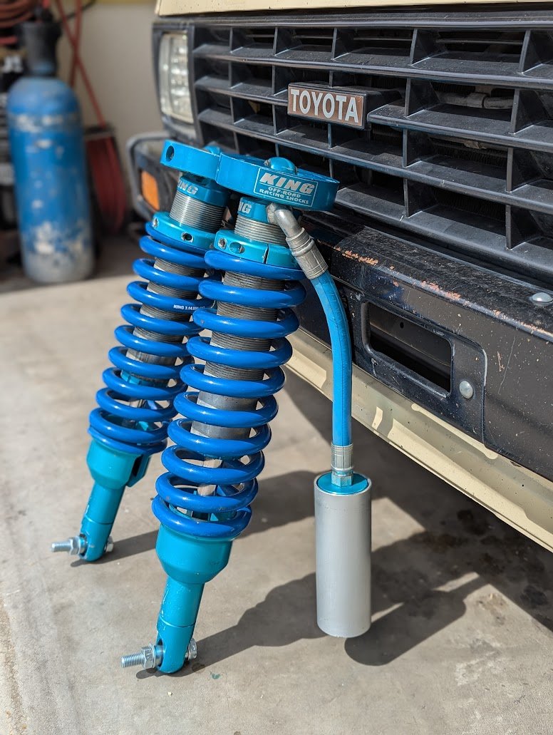

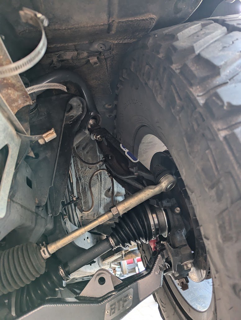

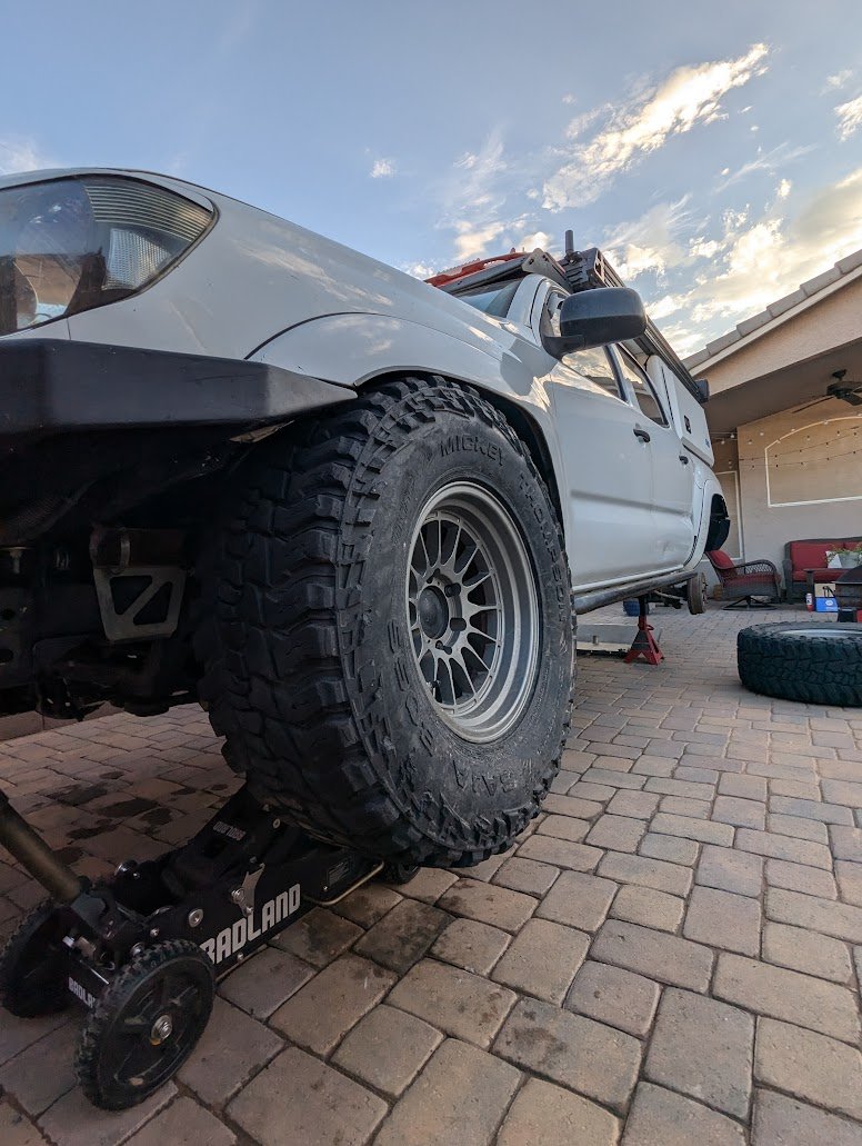

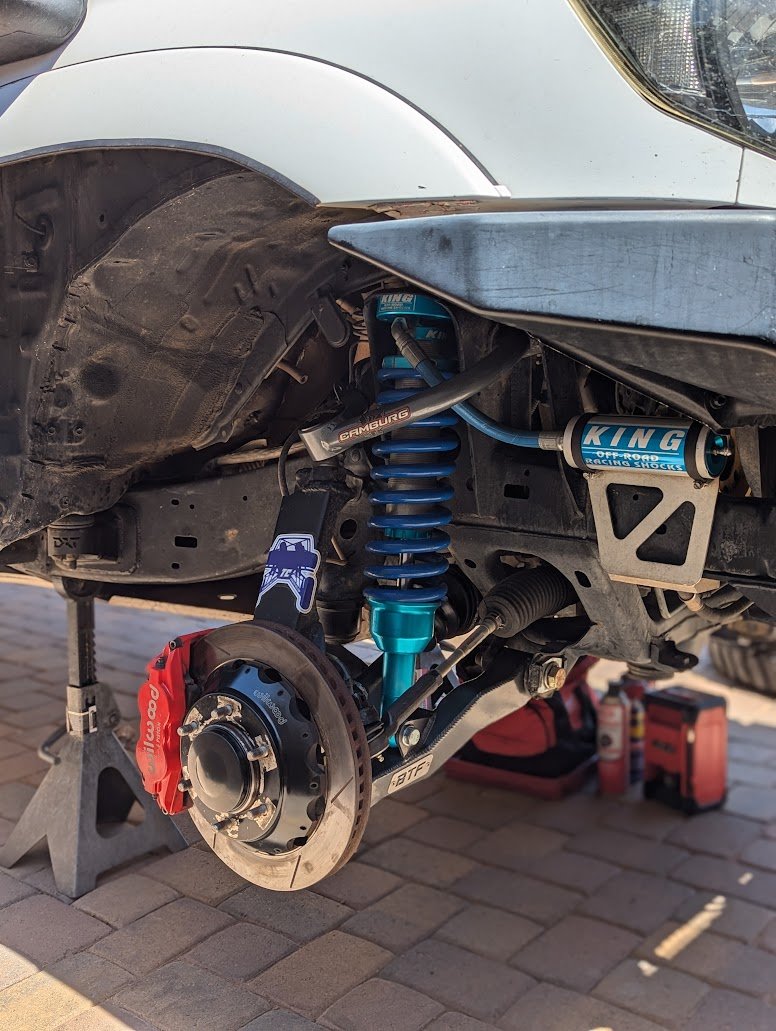

    Also, rebuilt the front end again and cycled to check clearance and bump height. Swapped back to 650# coils, adjusted bump stop height, fresh rod end hardware, fresh CVs and outer tierods, cleaned up the resi's and shock bodies, etc. Lowered ride height some as well. Much better now.. a couple more little tweaks to the front and I'm content with it. then to adjust the rear to match.
    AP1GczPhVJ8VJ2saTFLLbSYKZuNgV4YUB7j_RTI8_72a9d3f5ac376d3b12169a7e7283dbb5d7cf4c0e.jpg
    AP1GczOWlLvA0mkwKFbNaM96oa8VrKwZJ3swLvR9_34a661344900ddb8b041a1708c847da2b83c3c4d.jpg
    AP1GczP4OMTgwoPFyIk9pmUn7HHfBM8VptNyPOk0_11666a69a23004d154b284628e082a59b3c0d814.jpg
    AP1GczODa_P_jDtTNruscLMy1GLHXx6GmVPVZNXu_8dc252656ca3ac2db5448bd7c5a5e45b61725f10.jpg
    AP1GczOTk17bLklkqu3sGGpwldayqQDR6iwnszIJ_473714ec5f93e7d51693f450336d8771b5814982.jpg
    AP1GczOOQzn_ZdzubQpmVxvF05FOnlX1sXRAu5VW_fe17a735488d6cb1413e335dd8e0733dea5ecbe4.jpg
    AP1GczPhHpVVIzH_HSJuqOrZI32zh_ZpNxxCaGfS_5abf31b8da4073aa735e72acb96a2d303ac11d4a.jpg
    clears everything, while turning as well, and maxes out at/on the inner fender. Bumpstops are set to stop up travel right before contact.

    Did you buy a set of coils for the swap? I think I have atleast 2 sets here at the hoist you could have had. Hell one might be yours
    XPOTRPR[QUOTED][OP] likes this.
  16. Aug 4, 2024 at 10:57 AM
    XPOTRPR
    XPOTRPR [OP] CNC Programmer/Machinist
    May 29, 2011
    #57449
    31,179
    Josh
    Chandler, AZ
    > BUILD LINKS >
    I had a set of 650s sitting at the house.. honestly .. you might have my old 600s. Haha.
