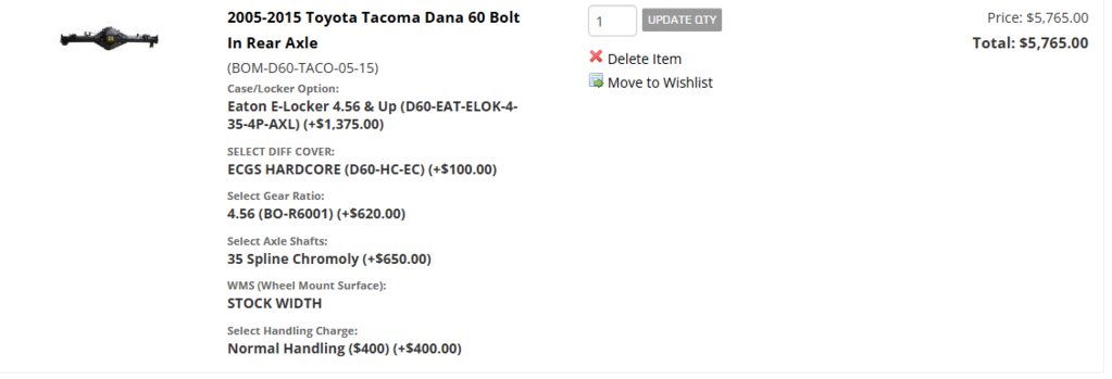

    HMMMM... now I'm going back and forth. Thinking the Dana 60 from ECGS might be a better option for a few reasons.
    By the time I get new 30 spline axle shafts, shipping of everything, etc with the Diamond axle.. I'm not far off from the price of a Dana 60 WITH 35 spline shafts from ECGS. Chunkier axle and gear set for sure too. Less ground clearance.. but I can get the Eaton E locker to keep the factory E locker setup (and can match the front with a Eaton E locker later too). PLUS.. if ECGS would be willing to work with me since its their 3rd in there now.. that could help out a bit as well.

    I guess I was just basing the locker setup off what they had in house to make it easy.. If I was going to have to split up stuff that makes it a little less enticing for me... and the fact ECGS has everything I need including the customer service and warranty is a big plus.

    See, thats the thing.. I can get it all through them. Dana 60, gear set with the ratio I need + E-Locker, 35 spline shafts, etc. hmmm.. sounding better and better for sure, especially if they can work with me. Gonna have to call em and see.
