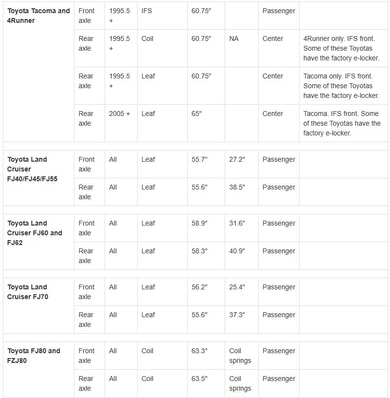

    I've been trying to determine what 4runner rear axle he used for the rear swap.. so I can figure out front and rear axle widths and get them to match. I think the rear is 3rd gen.. which would be 60.75" Wheel Mount Surface to WMS. OR.. its a pre 96 4runner 58.5" axle. The first gen front axle is definitely 55". So I would do the front IFS hub conversion to gain 3" overall up front and would be solid if the rear is the 58.5" axle. If its the 3rd gen 60.75" axle, I would have to do the front IFS hub conversion + 1.5" wheel spacers.. which seems to be pretty common on these things to get all the axle widths to match. There are a few combos for sure..

    Oh the axles arent the same width? Figured he would of already gone down that hole when he did the swap. OG your wheels and tires would look so good! Going to be allot of rubber for that 22re motor to move. Even with the turbo. But it aint built for speed.

    He put in a lot of work on it.. but with the smog BS he didnt finish some things. The IFS hub conversion up front is pretty cheap and easy for DIY guys like ourselves. It uses all toyota parts sourced from other models/years and a little bit of fab/machining and I can net 3" total + gain the ability to easily pull the hub as a unit if a axle breaks. I would still need to add like 1 to 1.5 spacers to match the rear. The rear axle swap gained a factory e locker, disc brakes, but its wide and kind of the odd man out as far as widths go. So far, this is the only issue I'm finding with the setup he did.

    I would still need to run wheel spacers even with the hub conversion.. thats my only concern. OR.. I find a 58" front axle to swap in and do the hub conversion on that.. then no wheel spacers needed.

    :rofl: we just need 58" fronts and then do ifs conversions and we'll be matching.. and matching the rears. lol
