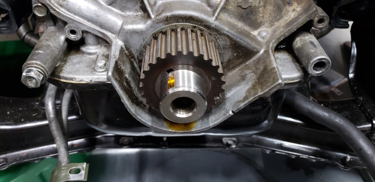

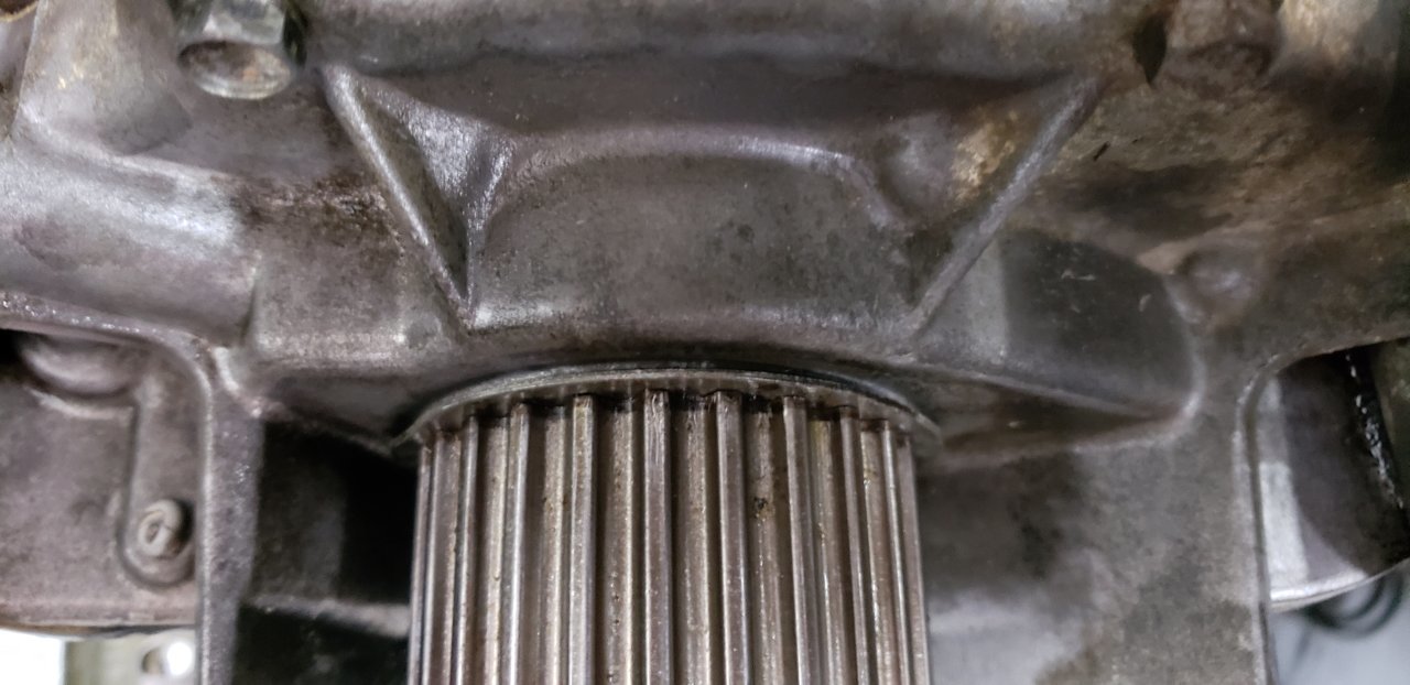

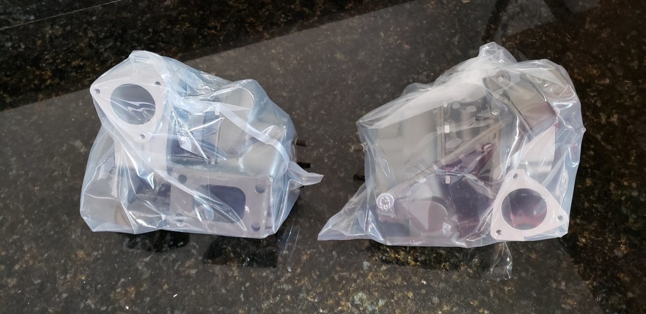

    Anyone have any brilliant ways to get a stuck crank gear off? I've seen guys drill two holes in them, tap the holes and use a puller. Kind of want to avoid drilling and tapping it but if I have to I have to.20190116_103523.jpg 20190116_103533.jpg

    Hmmmm could try using a leather belt to get around it. Maybe that plus some heat and or pb blaster?

    Spray penetrating oil on it and walk away for an hour. It will come right off. Don't pry on it much, if you do lightly and both sides at the same time

    I did this recently on my VG30, sorry man they really aren't designed to come off any sort of corrosion will freeze them on forever. I drilled a hole right between the keyway and the teeth and then used a dremel to get a crack started and used a cold chisel to widen the crack and work it off. New pulley is required but this is even how the shop manual does it, it is a disposable part.

    I've been spraying PB Blaster on it every morning for 3 days after I try to clean it up a bit with some breake clean. I have been also prying lightly on both sides at the same time with no luck. Going to try your method or drilling tapping.

    No prob man, better than trying forever to pry it. I tried and ended up bending the little back plate there and had to get a new one. If you hurt that back plate at all it'll chew your new belt up
