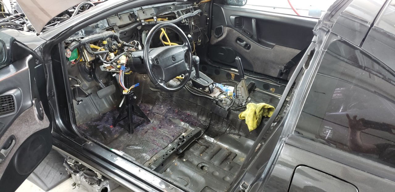

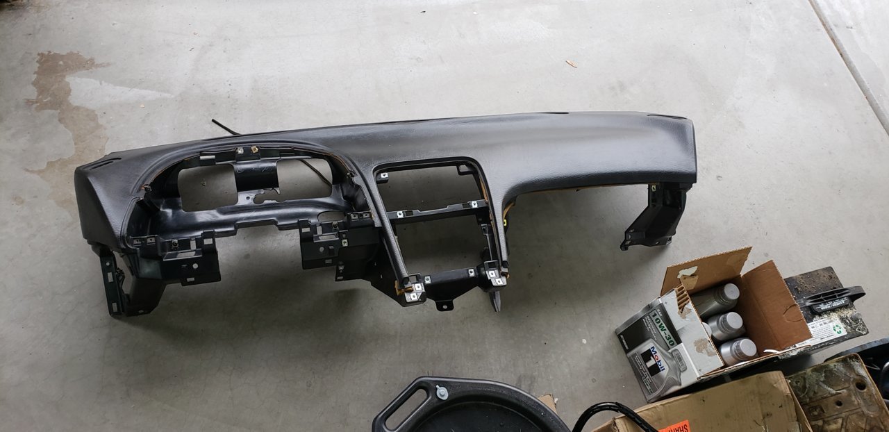

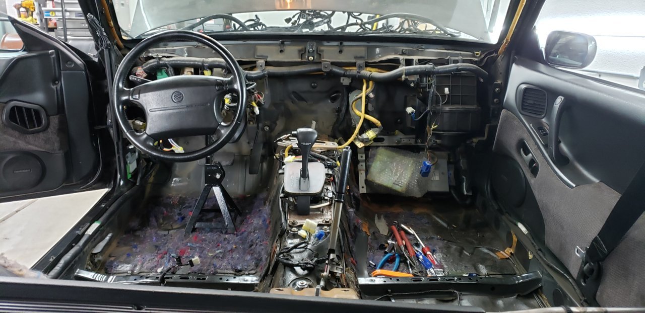

    Well my heater core is bad so I have to pull the dash...got it out today though!!

    bummer dude! did you find out during a flush/fill? lol
    good work tho!

    I was going to flush the heater core out a couple of days ago and it was spewing out into the cabin of the car

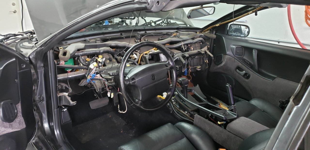

    Not bad for a day. Carpet was soaked so I'm getting new carpet too!!

    carpet kit and dash cover laying out to get its natural shape back. This week I'm going to start tearing into it. seat belts should be here tomorrow. plan is to get it torn down, install the stereo.. then clean and install new carpet, seat belts, etc.

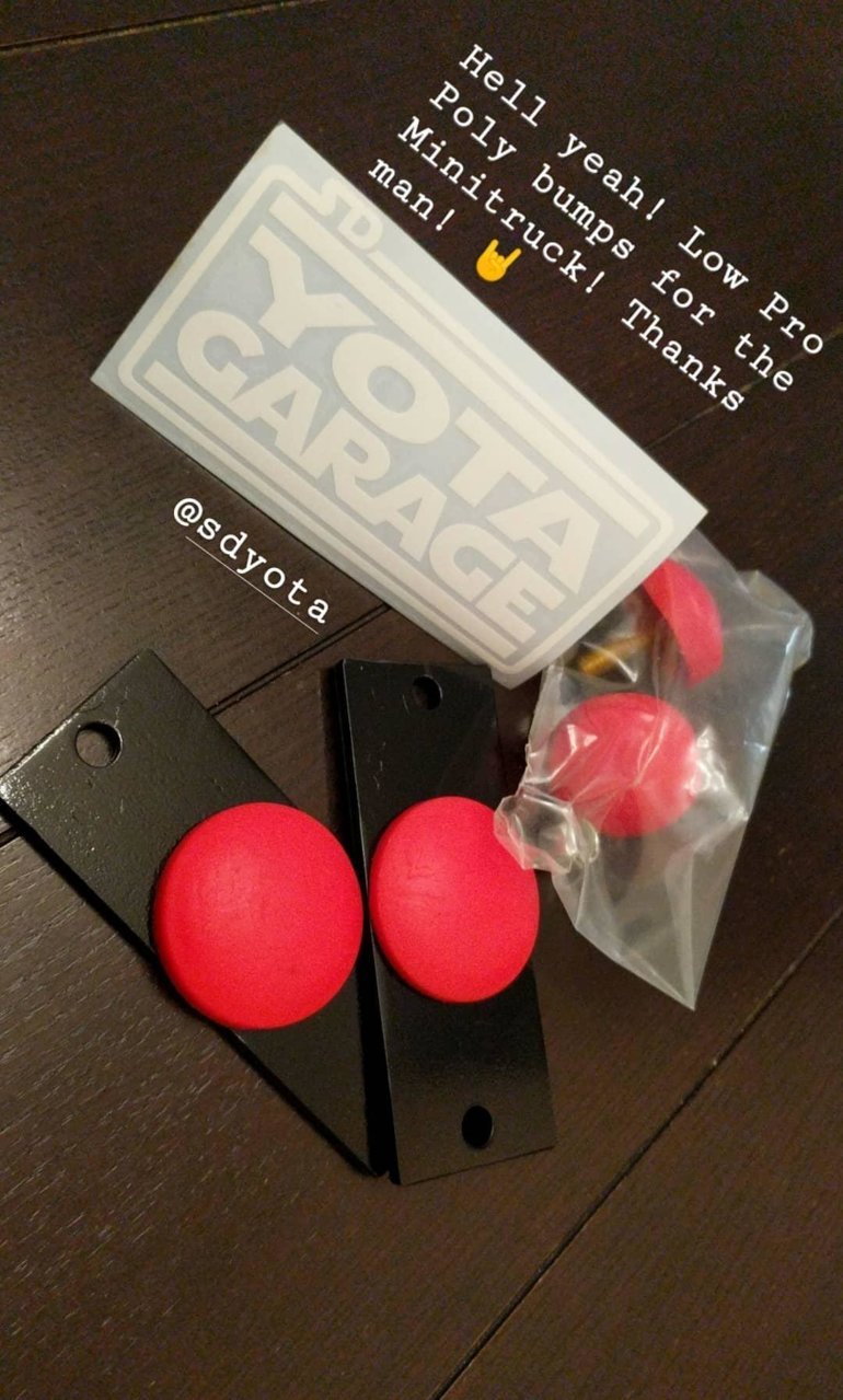

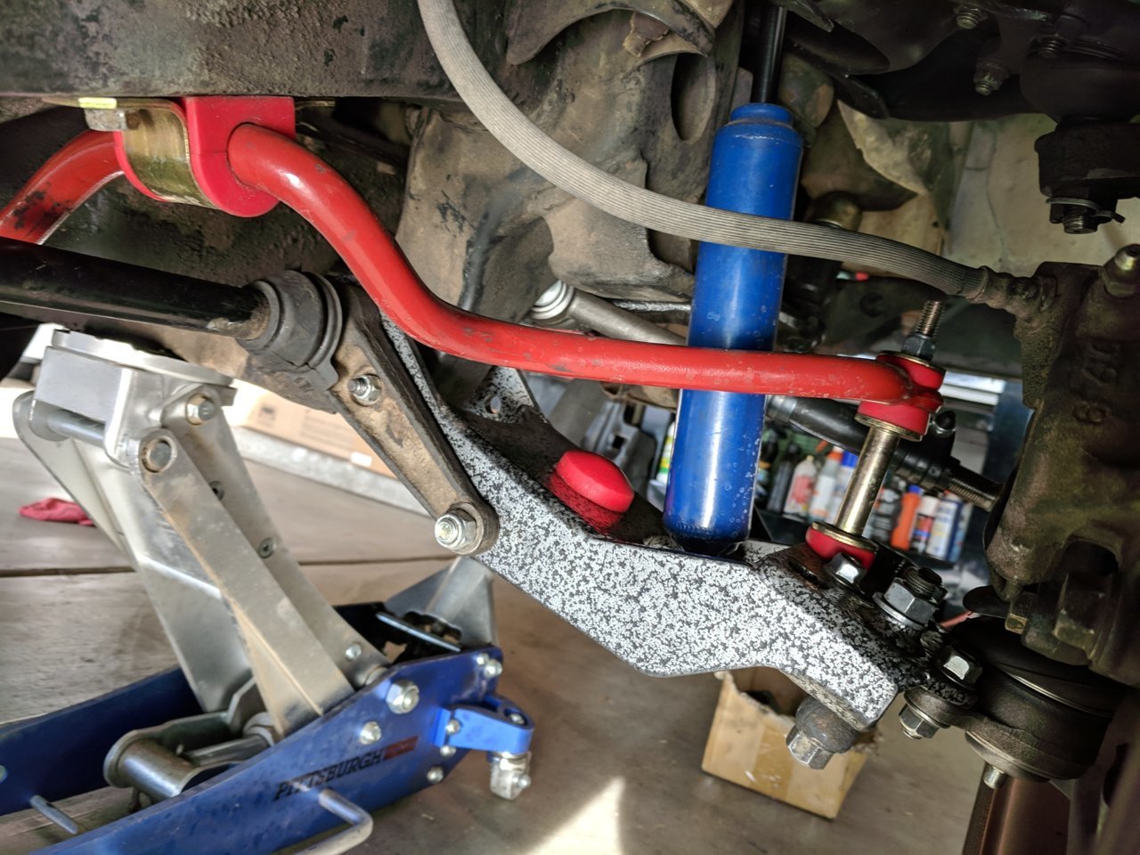

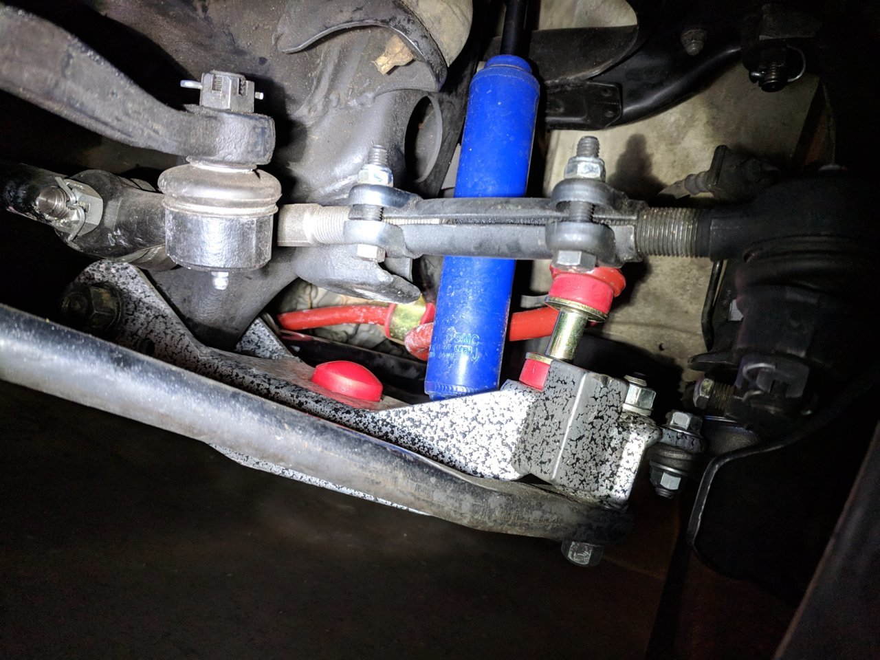

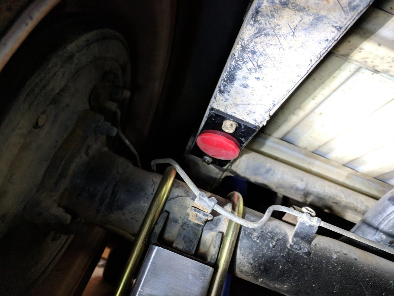

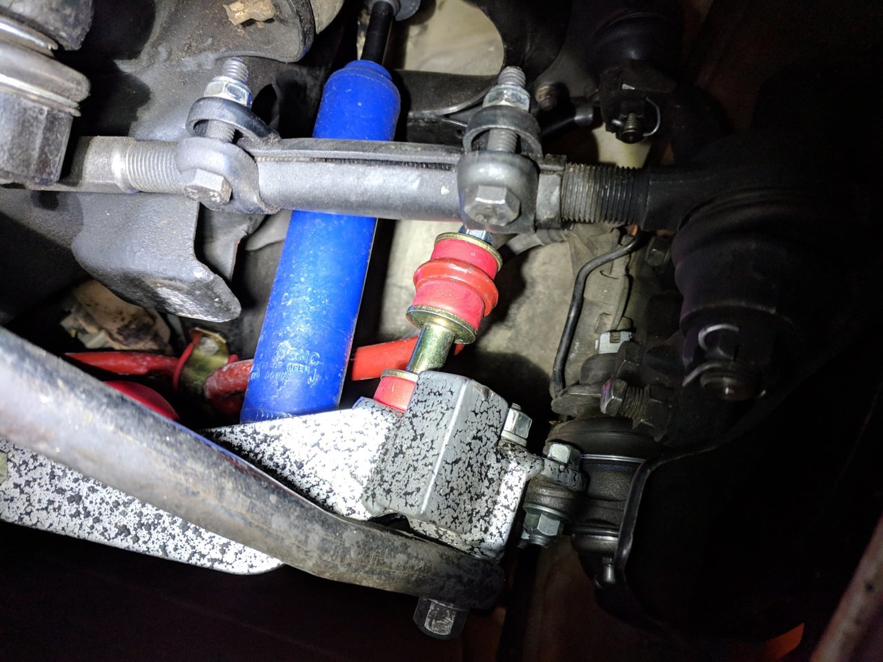

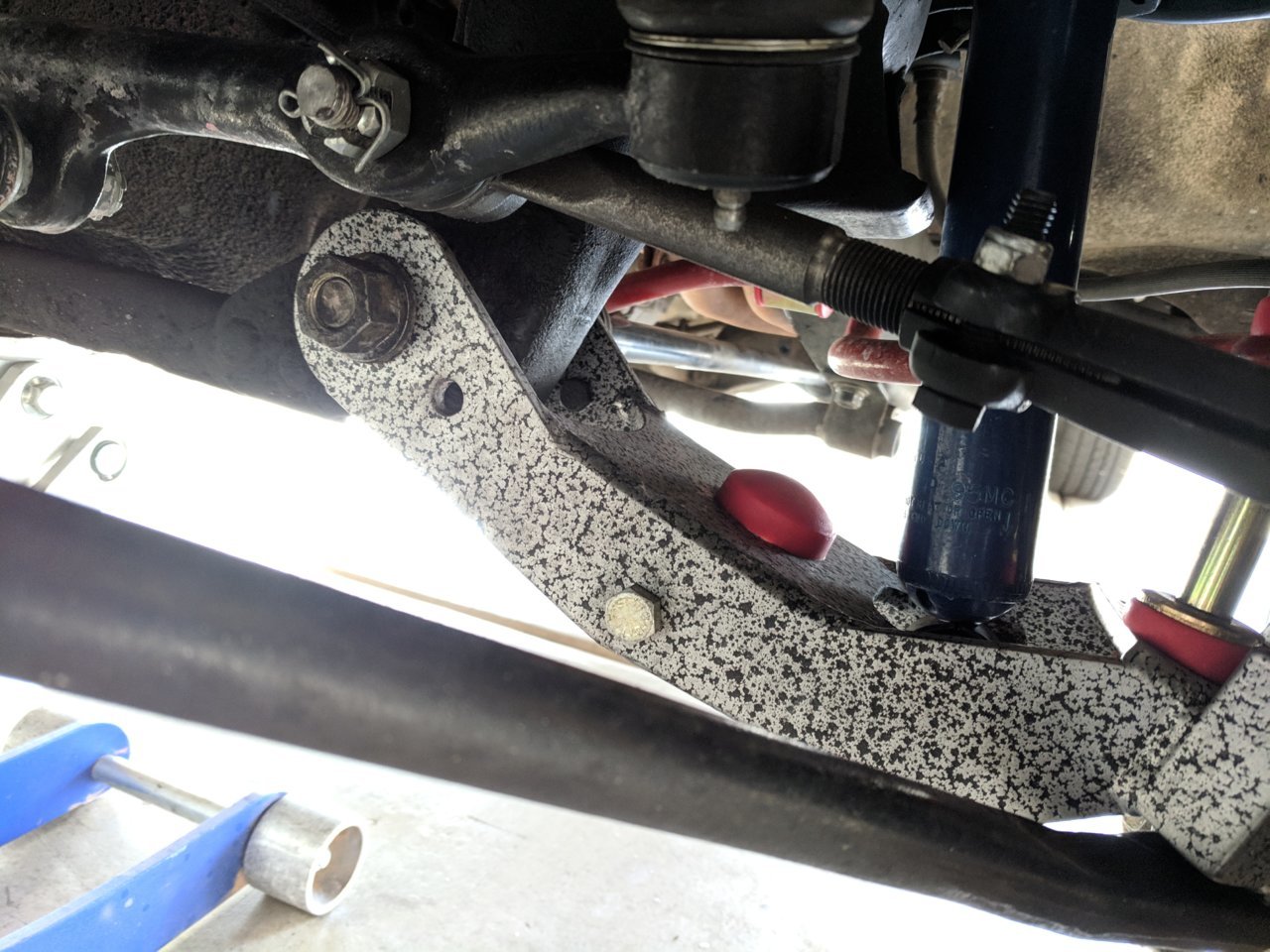

    Got the low pro bumps in, Adjusted the torsions some more, and pulled my sway bar end links to cut down the sleeves to match the new angle of the LCA's. Ended up just cutting one in half.. and using those for each side. Had to run to ACE to get shorter bolts, but got it all buttoned up and the ride is definitely improved. Just gotta fine tune it. Seat belts will go in next.
    Original end link height..
    New height..
  12. Mar 6, 2019 at 9:43 AM

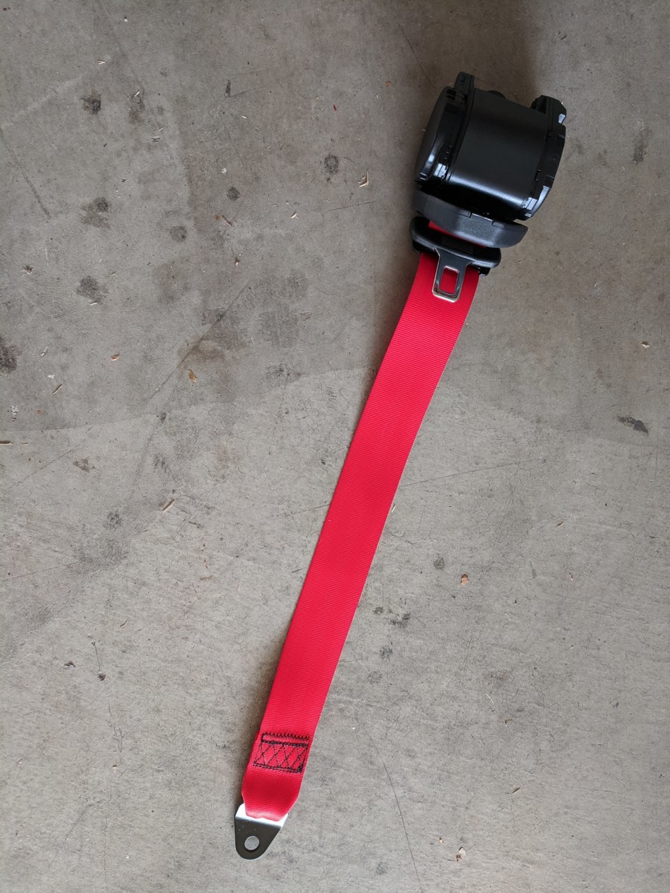

    Seat belts went in last night.

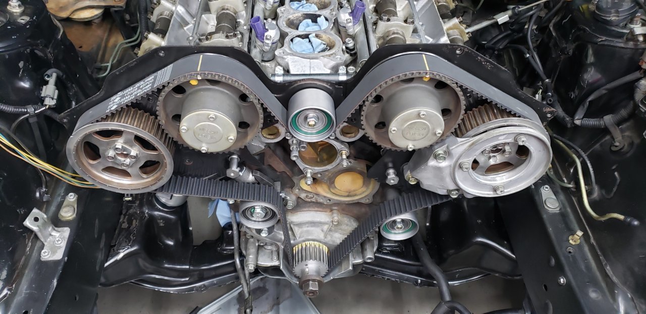

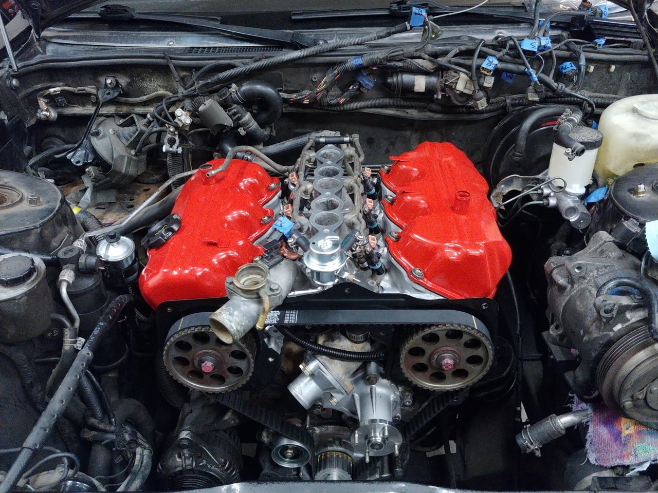

    Since @XPOTRPR build thread is also the Z garage haha heres mine getting ever closer. Turned it over by hand last night and she's got loads of compression by the feel
    52646470_10217182369298570_4221266052337_5da6293bf2b033adf69620b1f910629676d4ab2c.jpg
    Amazing how much simpler the VG30E looks compared to the VG30DE
