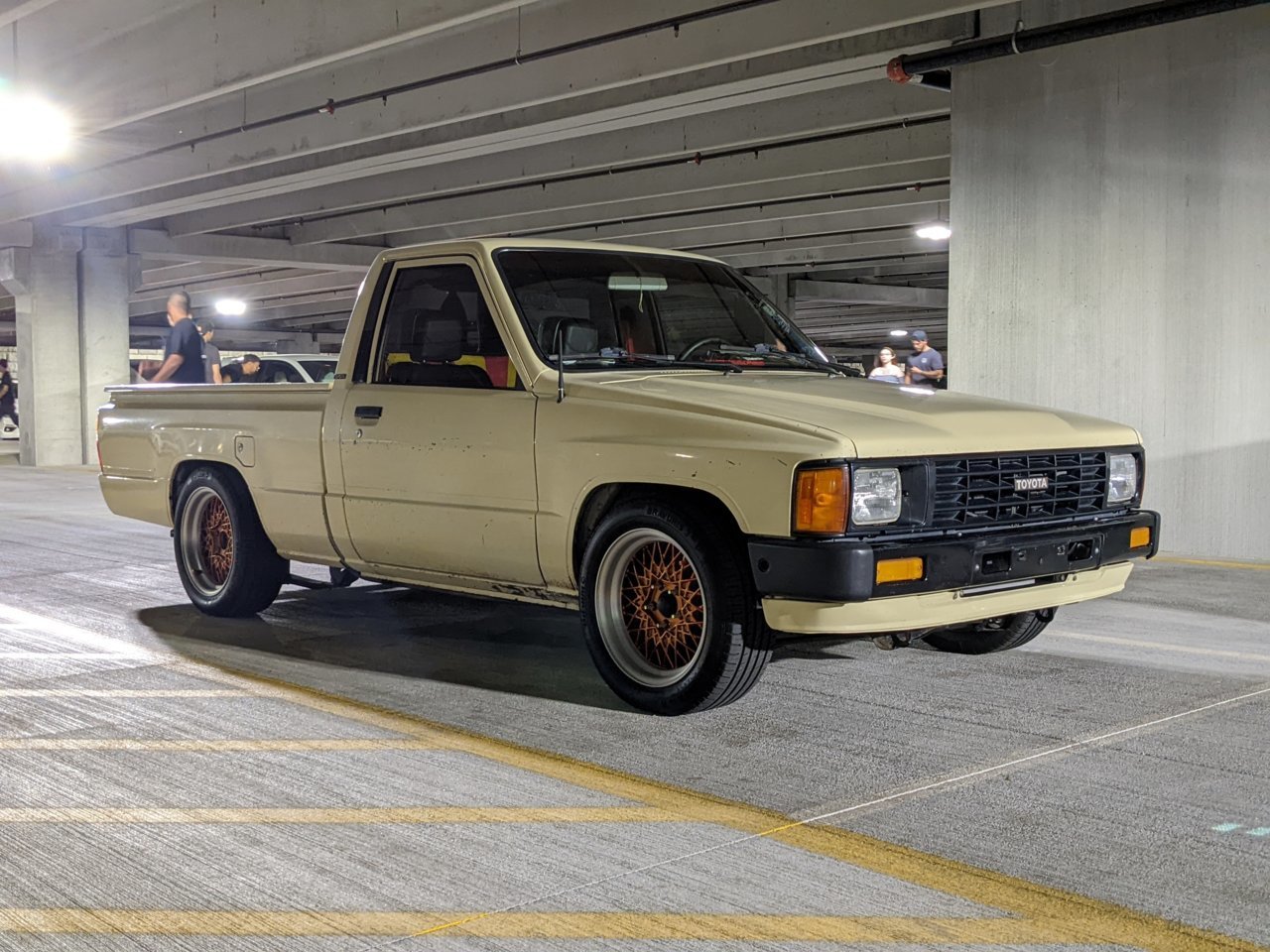

    Neighbor who does mobile detailing hooked up the mini while him and his car club were prepping for a car show. Invited us out so we tagged along for a bit last night.. and did not expect it to be as big as it was.. Only picture I got when we left. Lol

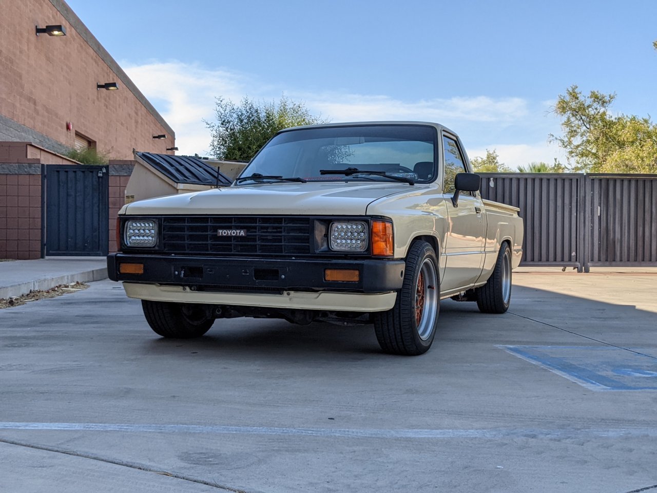

    Slapped in some new LED headlights after one of the oem glass halogens finally decided to give up the ghost. Had to add in a relayed harness to change outputs on the High/Low beams on the truck side. Pretty much all plug n play. Much better than the old dingy halogen ones looks and performance wise.
    Also finally "fixed" my missing AC tubing under the dash for the driver side vent.. It's always been missing so I've never had air coming from that vent.. which gets the hottest due to being on the door/window side. Kills during summer. I got some 2-1/2" Diameter shop vac hose and cut it to length and stuffed the ends into the vent/tubing that is there under the dash... Connects from center behind dash to the far driver side vent. Sealed off and secured with AC/aluminum foil tape. Not pretty, but you can't see it anyways and finally have air flow on that side now.

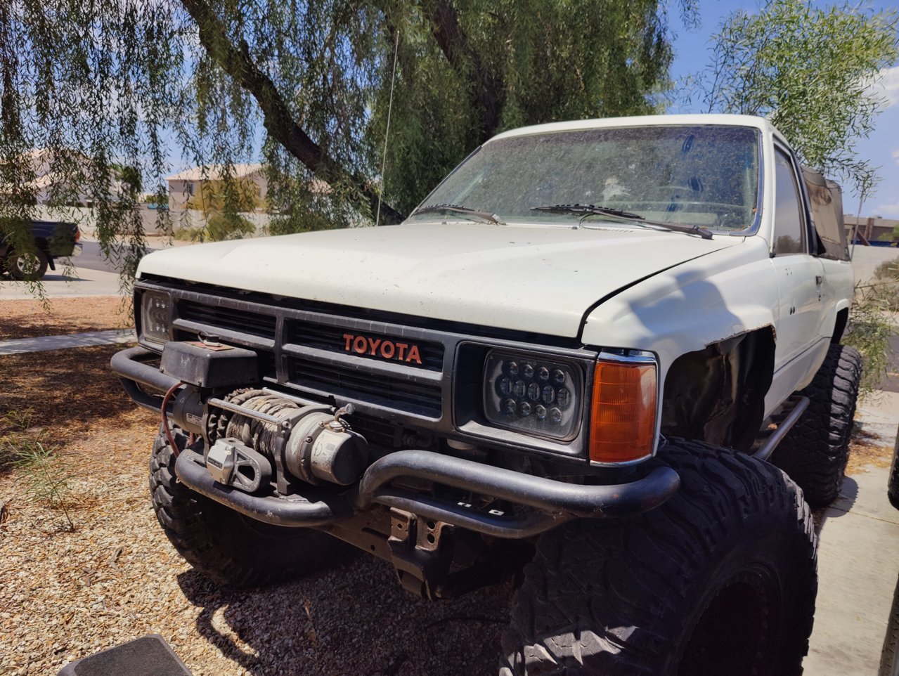

    That's what I have in the 4 runner as well. Seem to work pretty well

    I looked at those ones too.. with the DTRL on the outsides right? Did you wire them up? I wanted to start simple and see how they worked. I might swap them out to some fancier ones down the road.

    No dtrl. Haha it might have one but it's not hooked up. I ain't that fancy and no Ryan had installed them and wired then
