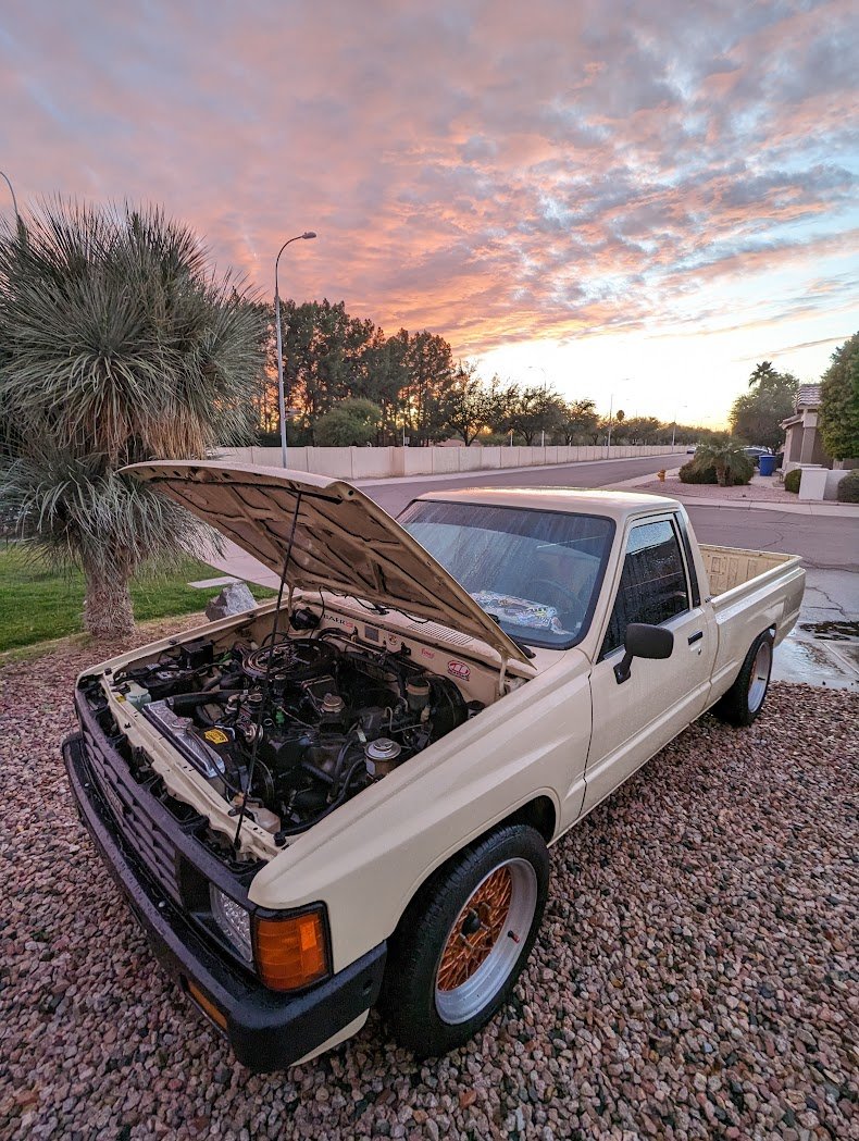

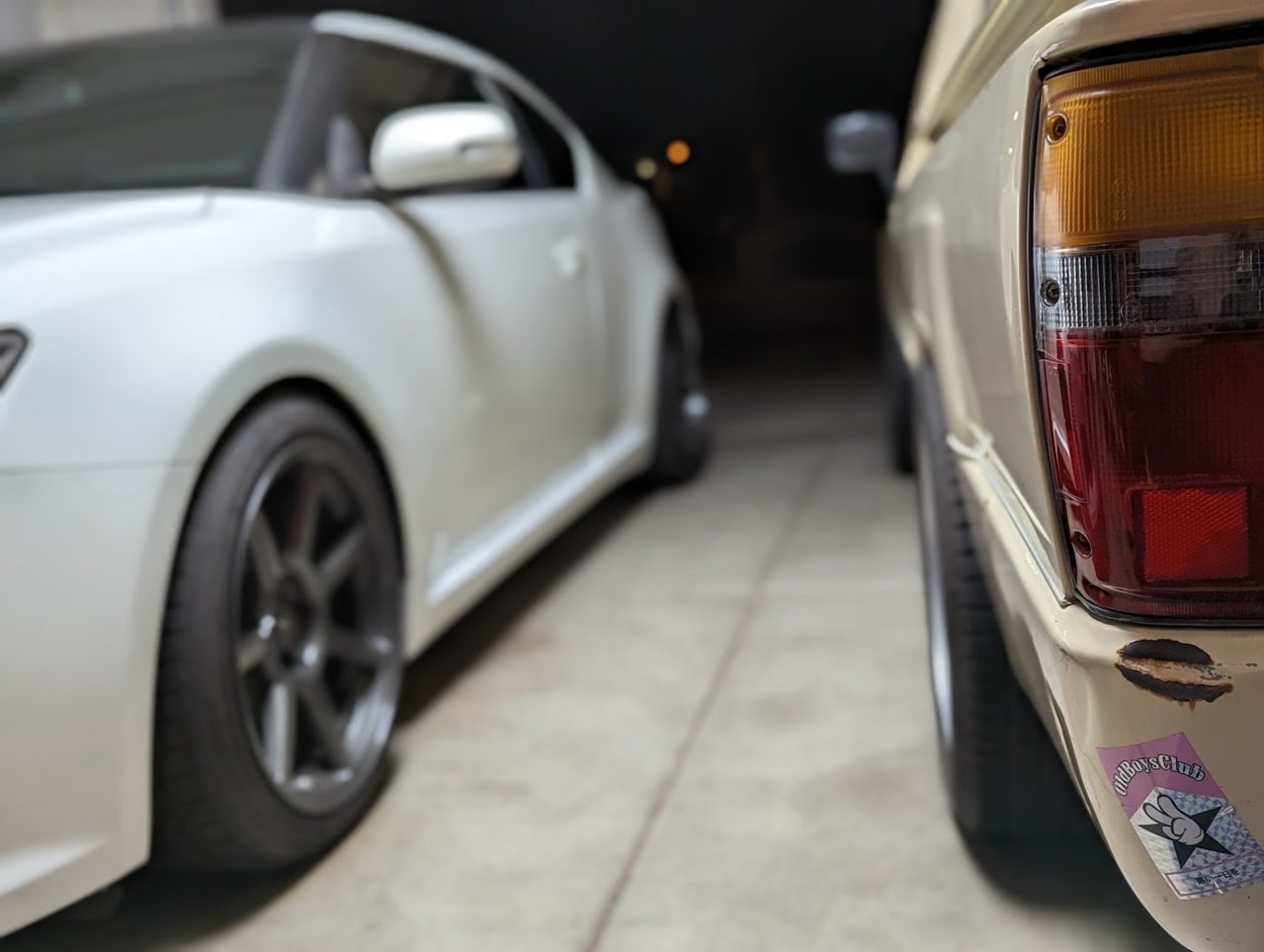

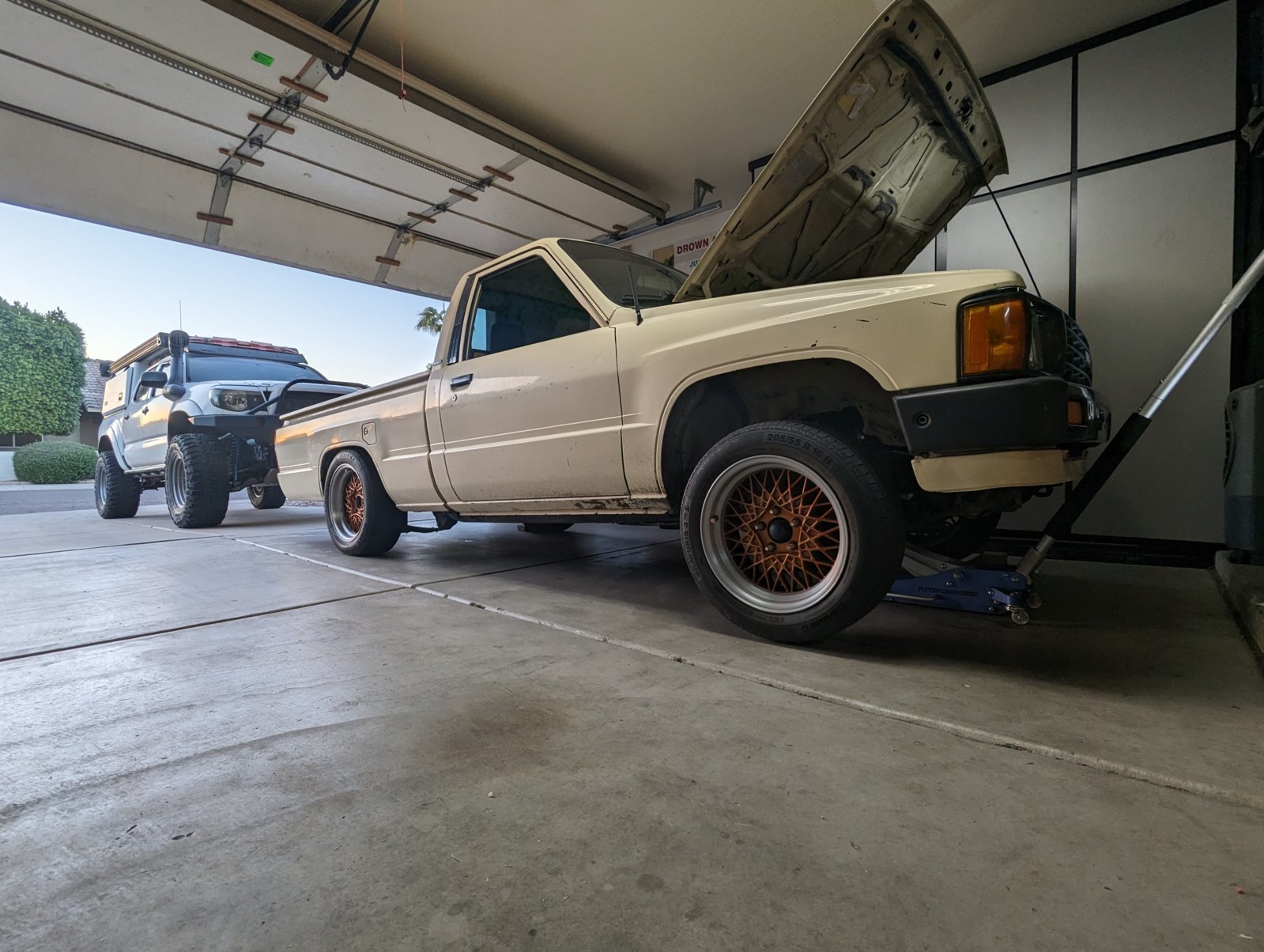

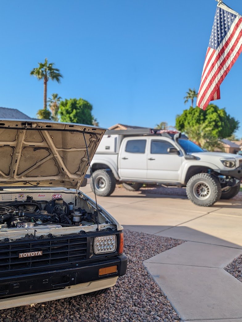

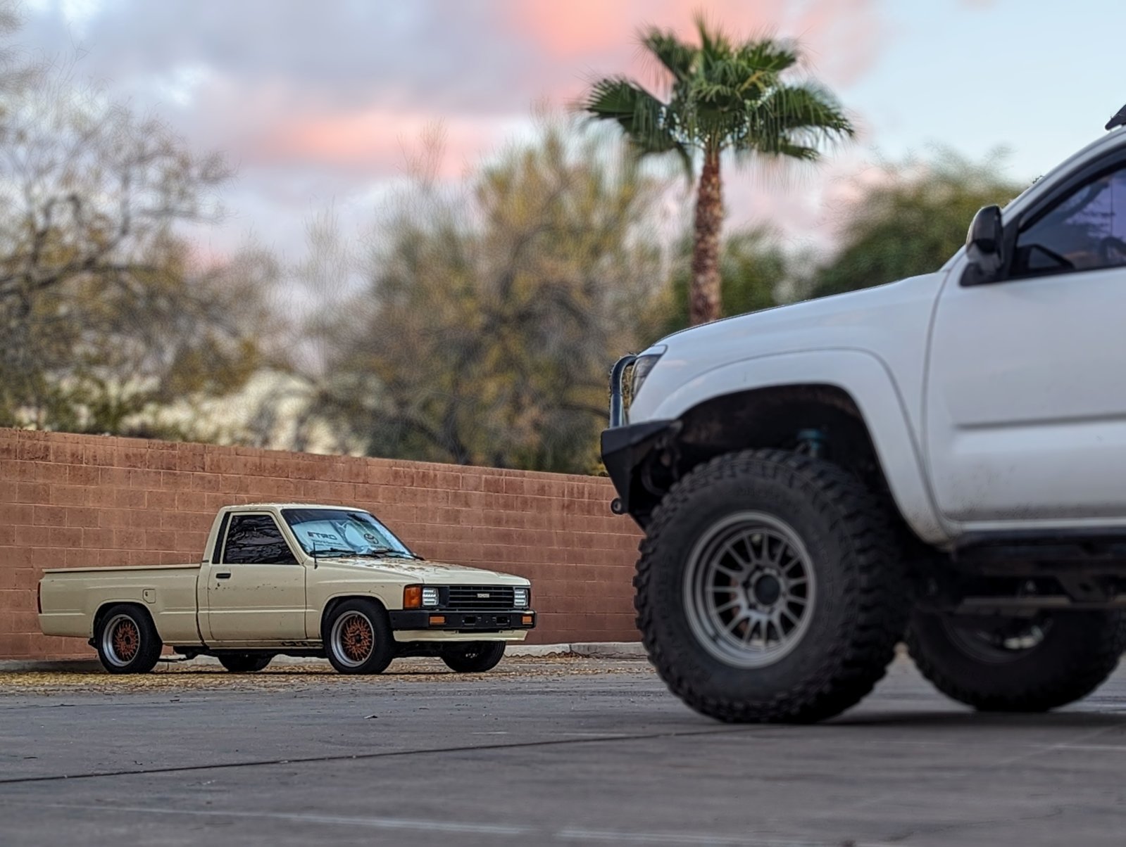

    Gave the Mini some love yesterday..

    Your sticker is creased -10 hp
  3. Jan 23, 2023 at 8:30 AM
    #943
    XPOTRPR
    XPOTRPR [OP] CNC Programmer/Machinist
    May 29, 2011
    #57449
    31,171
    Josh
    Chandler, AZ
    > BUILD LINKS >
    I fixed it after you f**k
  4. Jan 23, 2023 at 9:22 AM
    #944
    prise
    prise AZ's Toaster Strudel Low T Andrew
    Dec 14, 2020
    #349592
    1,490
    Prise
    Rally Runner 04 GX470
    WELL it ruins the picture for me

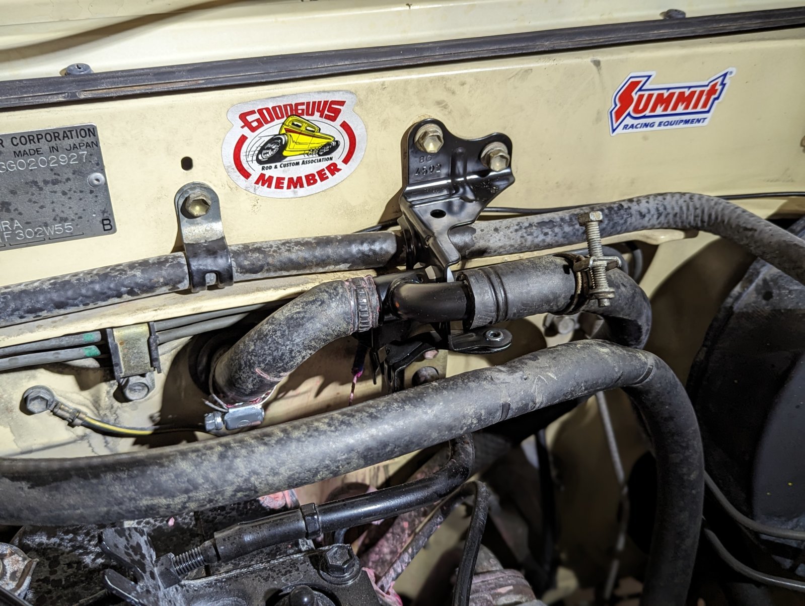

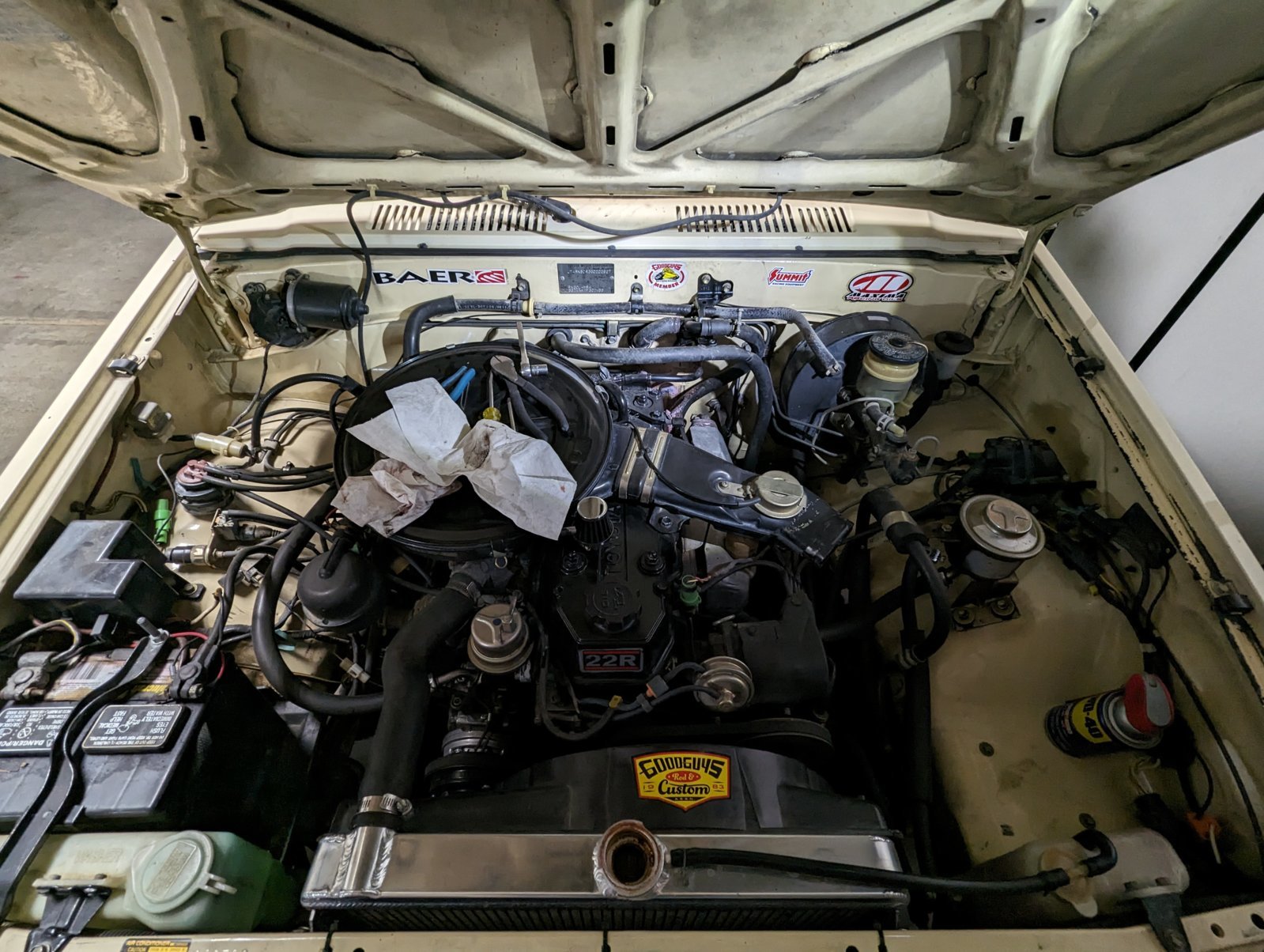

    Update:

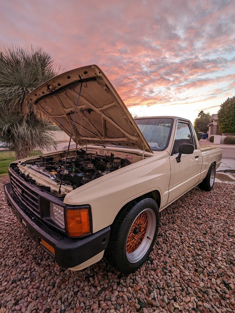

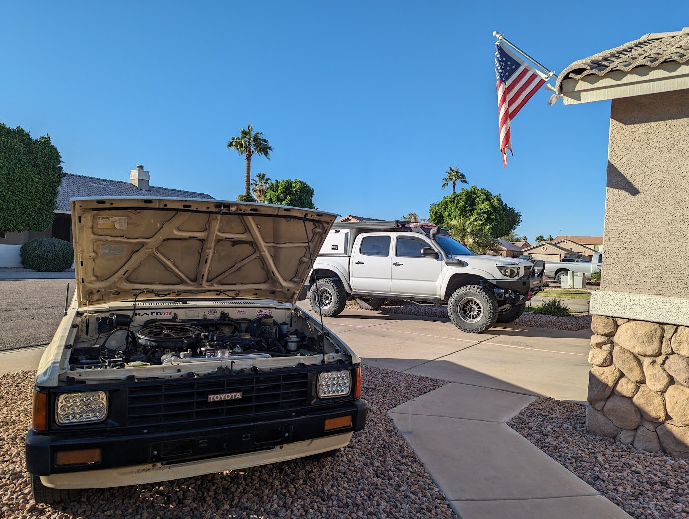

    About a month ago my parking brake cable snapped parking at work. Bummer.. A couple weeks ago the Mini started overheating in the drive-thru.. got it home and went to pop the hood to check on it all.. and the hood wouldn't open. The cable stretched enough to not allow the mechanism to unlock. New parking brake and new hood latch cables ordered.

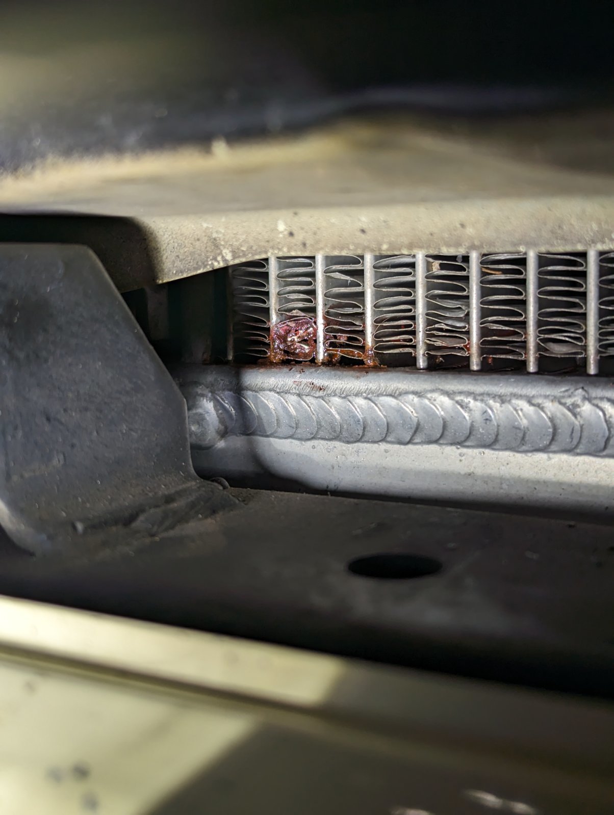

    Tonight I finally got the hood open by disassembling the lever under the dash and was able to inspect the coolant leak. Culprit was that something hit the Radiator in the bottom corner and created a small leak for it all to leak out over time. Radiator was dry when I first inspected after popping the hood. Took the opportunity since the system was empty to replace a leaking heater bypass/proportioning Valve that I had ordered as well.

    OH boy what a mess poor little truck. Glad it got the love it deserves and you fixed it all nice like!

    Still need to fix the Radiator leak.. but progress!

    Put half a bottle of Bars Liquid Aluminum in the Radiator and filled it all back up. Tightened up a bunch of hoses and ran it for about 15 minutes. So far so good.

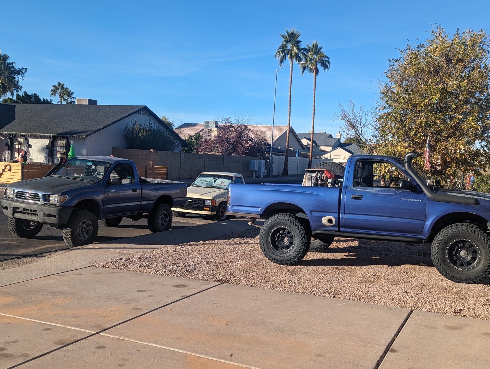

    That would be @Milota95 's two blueberry Tacos. Ones a 4 ones a v6.
    And do it! That would be an awesome project. That's what my little truck is... A 22R
