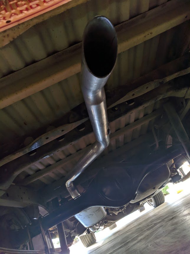

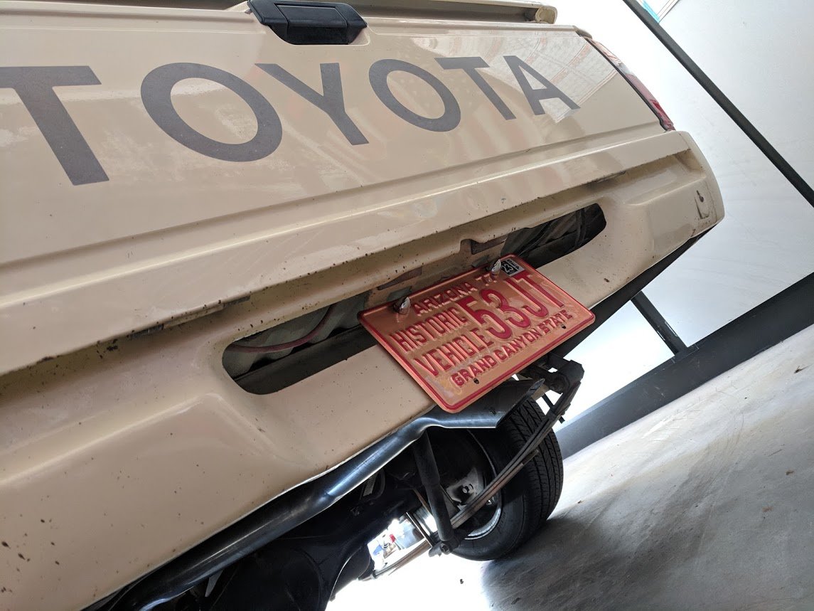

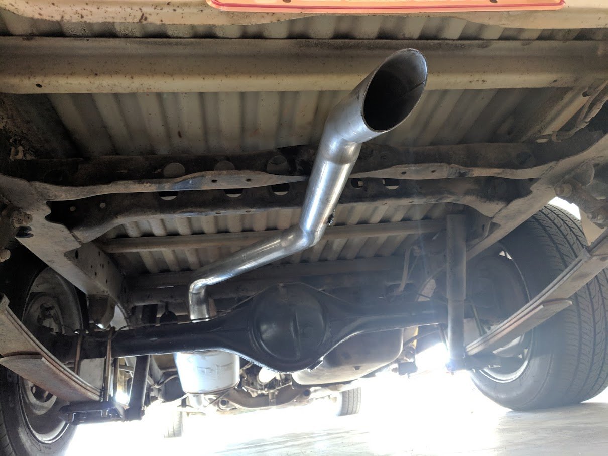

    and I LOVE the exhaust!! :goingcrazy:
    Cat Delete w/ 2.25" piping. 18" Magnaflow, and center dump. Sounds so smooth and deep. I'm REALLY surprised and pleased with how it sounds. doesnt even sound like a 32 year old 4 cylinder toyota pickup. lol
    Loving the exit and dump too. they did it exactly how I imagined with hardly any input. Always great results from Mesa Muffler.

    That thing is so clean underneath! The exhaust looks awesome man!

    Its not too bad! rear diff has a small, slow leak. one clamp on the driver side leaf pack is half broken.. misc mounts and bushings are starting to ear and break down. but overall.. pretty decent.
    and thanks man! I'm definitely liking how it came out .
