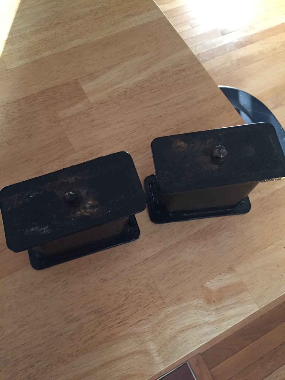

    I have some 4” djm blocks from my xrunner I will sell u. They are steel a lot better then that aluminum. Let me no if ur interested.

    are they the Beefed Taco ones?
    I ordered 4" Alu. blocks already.. I know they arent as good.. that was before I found the Beefed/Steel ones. I'm just going to run these for now until I get to a better spot, and I'm planning on changing it all out anyways. New low pro bumps F/R, replace the balljoints and do the bj flip plus drop spindles, then raise the torsion bar back up and do the steel blocks out back.

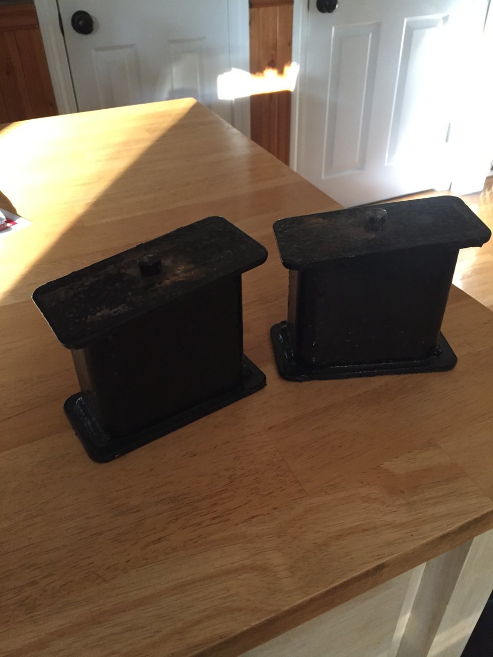

    Here’s pics A9FBE146-7799-494A-B790-00CA41EC2426.jpgF2E3C2E6-D1E3-4FC1-B2E5-0B1D9CFFF886.jpg
    XPOTRPR[OP] likes this.

    I got some street taco blocks with offset pins to move my axle back.

    Those are what I'm looking to get down the road. The steel street/beefed taco ones with offset holes and taper.
