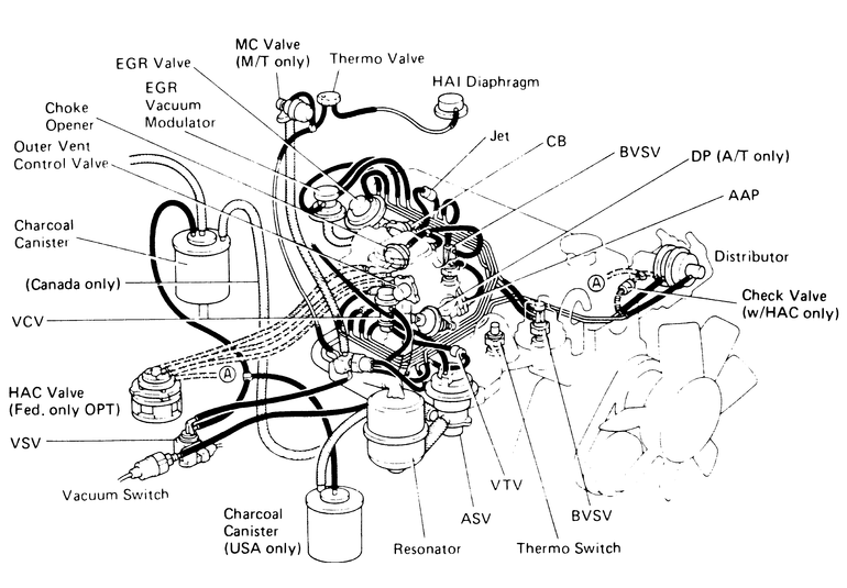

    So I looked into the backfiring a few days ago, and came back to this thread again today. Describes the same symptoms as mine, and results in the Vacuum system. So I tried the test described here...
    https://www.toyotanation.com/forum/...99677-86-4x4-22r-engine-help.html#post3736735
    here's my Vacuum Diagram
    I pulled the hose off the AAP diaphragm and capped both ends. We'll see tomorrow morning.
    if in fact this is the issue, its part of the rebuild anyways, so I will be making that happen here in the next couple weeks. Professionally rebuilt and tuned.

    Diagram? You mean spaghetti bowl?
  10. Oct 30, 2018 at 5:54 PM
    #150
    Torspd
    Torspd Tor-nication
    Sep 18, 2009
    #22958
    26,452
    Tor
    The Great America!
    MMVI 4.4L 4x4 Access Cab
    Torspd Custom Turbo kit [] Borg Warner 9180EFR Turbo [] Haltech Elite 2500 [] TiAL Q BOV [] TiAL V44 Wastegate @ 15psi [] CP Pistons [] CP Carrillo Rods [] ARP Head studs [] ARP Main Studs [] ARP Header - Head Studs [] Ported Heads w/ 1mm oversized valves intake/exhaust [] Brian Crower Forged Stroker Crank [] Darton M.I.D. Sleeved Block [] Kelford Camshafts [] Torspd 160* T-stat mod [] APR Large Fuel Rail [] Walbro 460 LPH E85 Fuel Pump [] FueLab FPR [] APR T56 Conversion Kit [] KP RACING Built T56 [] McLeod Racing Custom Twin Disk Clutch [] One Piece Aluminum Driveshaft [] MGW Shifter [] Custom lowering kit [] Ohlins Front Coilovers [] QA1rear shocks [] Custom Ron Davis Radiator [] Dual SPAL Electric Fans []
    Probably have a few bad vacuum hoses, unless they have all been replaced.

    That's pretty accurate on both parts.. lol
    Most hoses have been replaced.. but some of t he small short ones haven't, Including this one. The Previous Owner also decided to paint the valve cover while on the vehicle.. and didnt tape off some of the hoses.. :facepalm:

    Well.. the AAP Diaphragm test did the trick. truck ran smooth and quiet this morning.
    so now comes the question. block off/get rid of all the Emissions/Vacuum BS.. or leave it all factory and just get the carb rebuilt and tuned. It will get rebuilt regardless.. just not sure if I want to delete it all or not. I'm leaning towards leaving it all.
