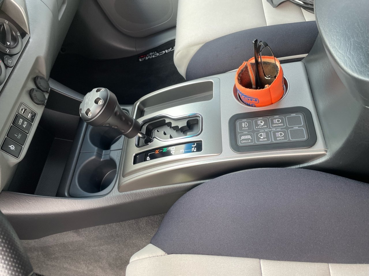

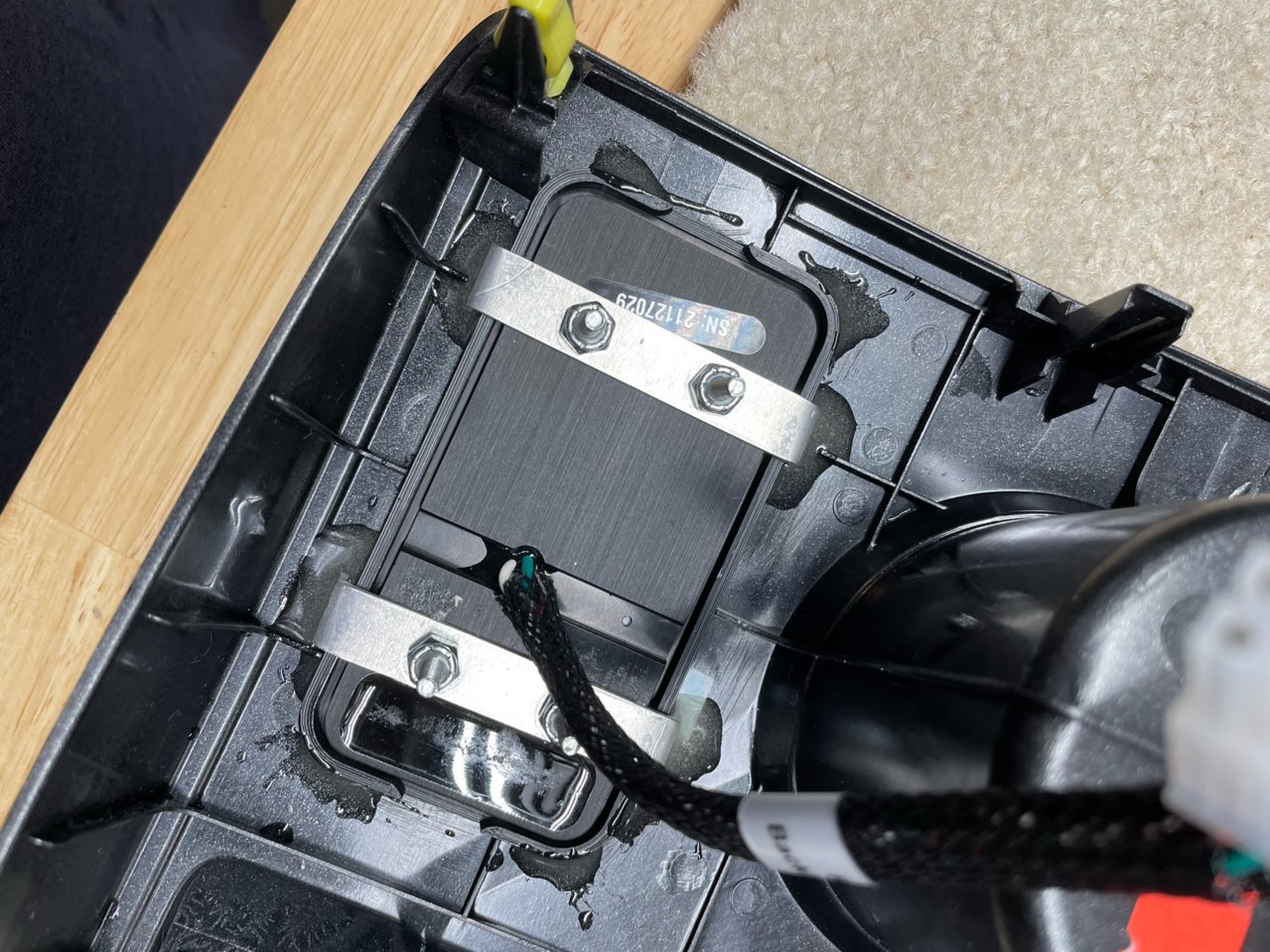

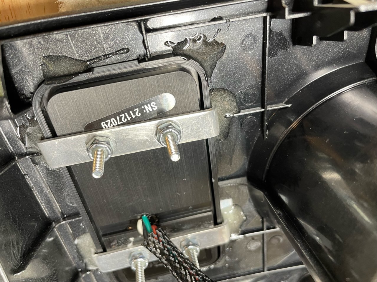

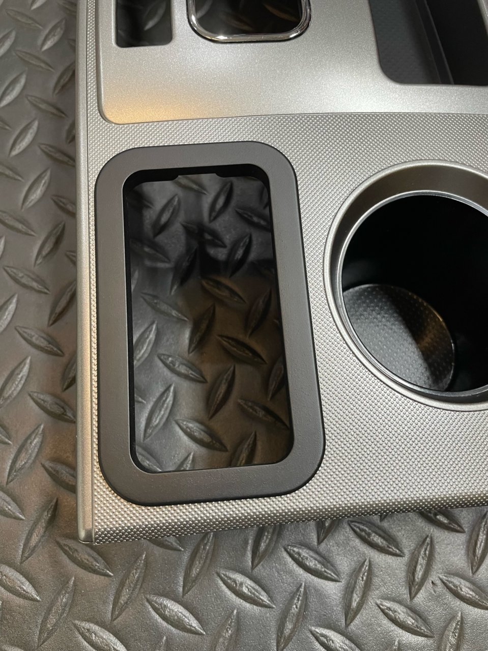

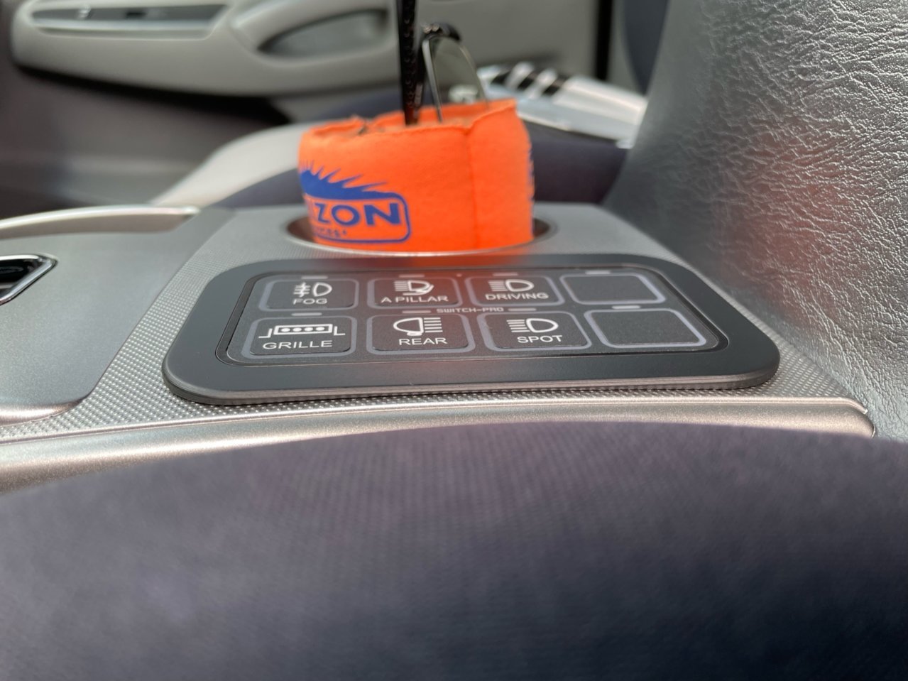

    @Narutaki, you won’t be disappointed. The fit is perfect and looks great. Though I took it a step further and secured it in place with some small custom brackets on the underside.

    Appreciate the feedback! :cheers: Looks great! very nice and clean install.. and I like your solution to help keep the newer 9100 (no tabs) in place.

    Do you have measurements for the cut and positioning? I'm interested. Looks clean, great job, is that just being glued or epoxy to the bottom of the plate?

    When you receive the part from @XPOTRPR, it comes with a cardboard template to position the the cutout. Just take your time cutting it out. I cut just to the inside of the line and filed the rest to get a snug fit.
    As far the little brackets on the underside. I bent up some pieces of aluminum and cut / files the the tabs just so they touch the underside of the console piece. put the nuts onto the studs of the SP, made sure it was flush on the top side and used some 3M epoxy to secure the aluminum pieces in place where they contact the plastic console piece.
